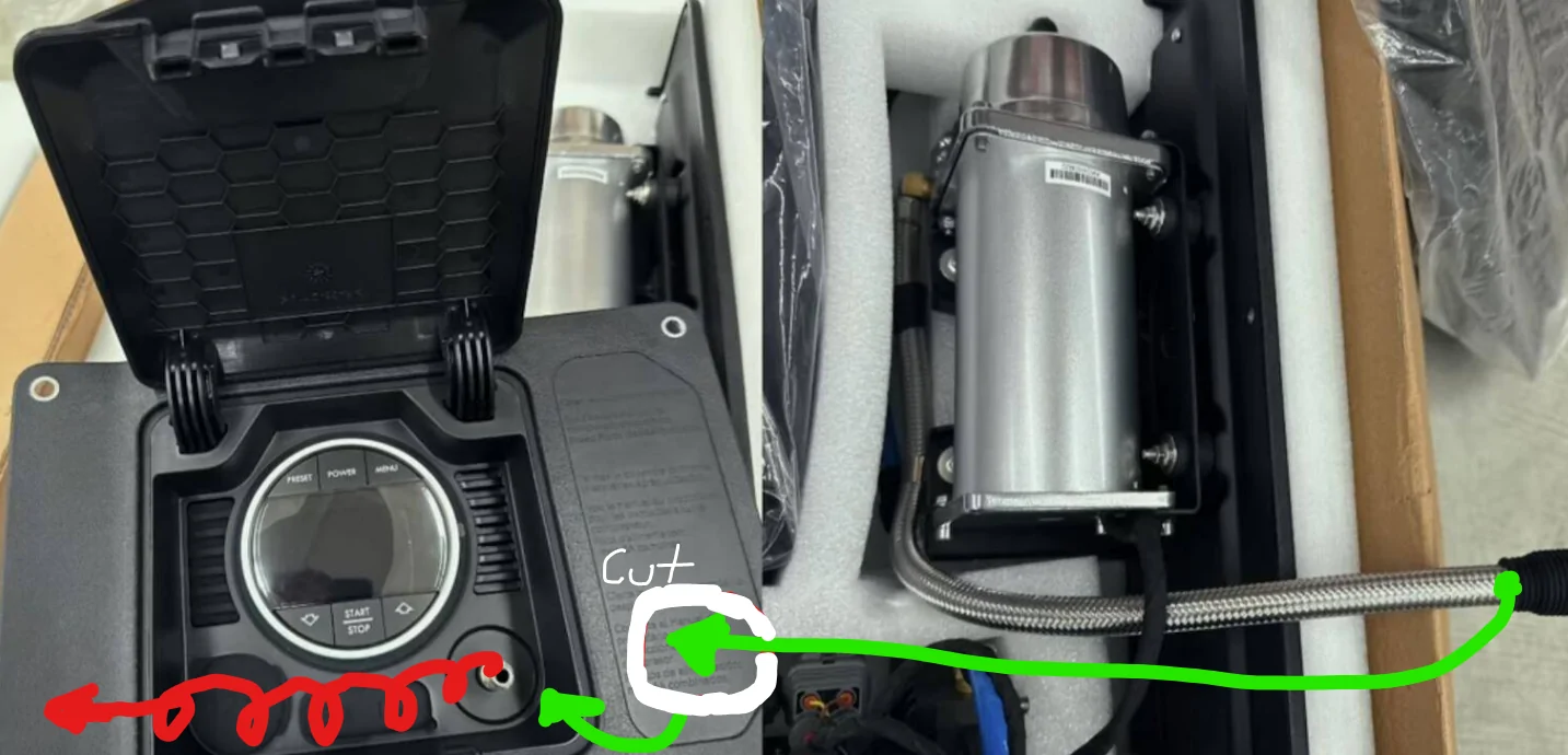

Out of curiosity because I'm leasing. Seems great for me as plug and play for the control unit. I will save my TRD OR 12v usb power panel to reinstall when lease is up. Could I just install the air compressor control unit then cut a hole on the blank space to the right (see mockup) of the unit and just have the air compressor silver hose hanging through the hole. I can then stow the actual air compressor inside my cab and then when I need to use it, I bring the air compressor into the bed and connect the silver hose to the compressor and red hose to the control unit? This way I don't have to cut through the bed?
Sounds confusing here is a bad pic (I should have made the green arrows point the opposite direction):

it's not just the sliver hose, that's just for air up. there's also an electrical connector for power as well as a blue tube i assume is for air down.
i suppose you could try it but at that point i'd personally just use a portable setup. seems like the worst of both worlds (added complexity & cost, + you still have to lug around the compressor).
