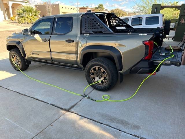

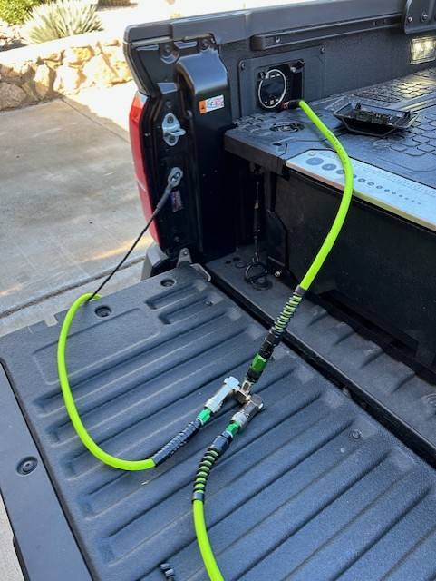

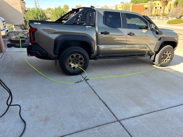

Decided to DIY it, all parts off Amazon, mostly Flexzilla components. Used exactly one 50' hose cut to appropriate lengths. No leaks, works as I expected, only takes a couple of minutes to set up and keeps all 4 tires at the same PSI.

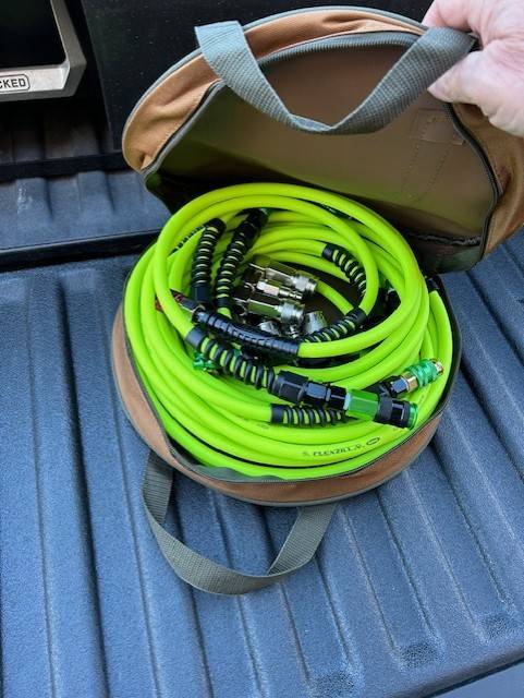

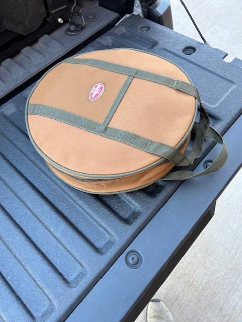

No Problem, though it probably isn't cheaper than the Morrflate you can find on Amazon, I like DIY and was able to make the connections and lengths exactly what I wanted.
Bucket Boss bag - $18.99
Flexzilla fittings -$3.99 ea (x12=$47.88)
25 piece fitting kit - $23.99
50’ Flexzilla hose - $28.72
Airhose connector 2 pack $19.19 ea (x2=$38.38)
Locking collar air chucks 2 pack $15.99ea (x2=$31.98)
Total $189.94

Yes, definitely could not make the connection with the Decked drawer system. I posted a bunch of pictures and some explanation here:

Unfortunately I didn't get photos of all of the process. It was pretty extensive, much of it was never fully disassembled, just pulled apart far enough to get at the fitting to remove it. The connector on the back had to be unscrewed and the insert pushed in to open it up, and had to use a uni-bit (step bit) to expand the hole size to accommodate the slightly larger diameter fitting. If I had it to do over I'd try a universal joint on the female end first. Also, the OEM fitting has a pretty good thread locker, so it doesn't come apart easy.
