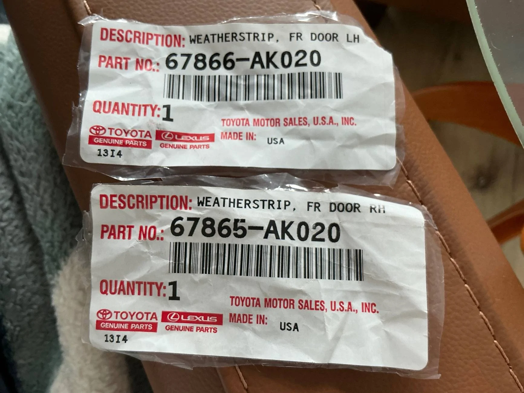

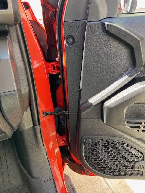

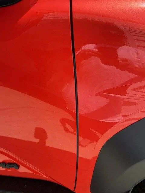

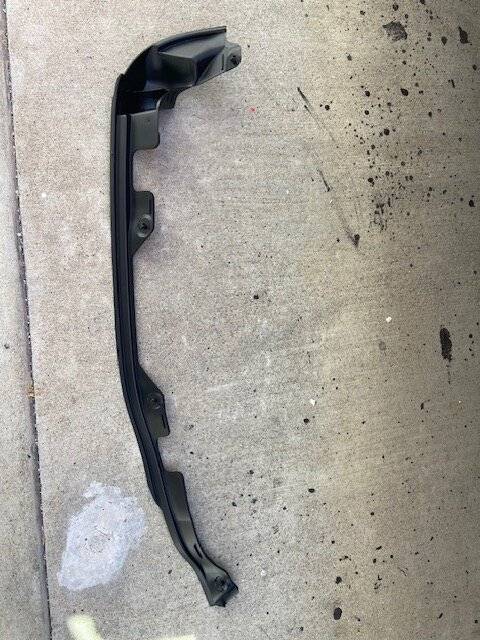

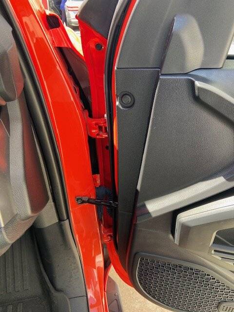

I am guessing these come standard on the more premium Tacoma trims. My TRD OR without the Premium package did not have them. Hopefully they will reduce some wind noise and keep the door jambs cleaner. Each door runs around $38 and they fit perfectly as expected from an OEM part.
Once you remove the 4 factory plugs in the door the install is easy. I posted the part numbers and included a few before/after pics for anyone else that may be interested.

Correct. I'm trying to find the part number for that section. It’s attached with an adhesive strip, no push clips.

Order placed for the front lip weatherstripping for the rear doors. They are around $18 each:
67895-AK010
67896-AK010
