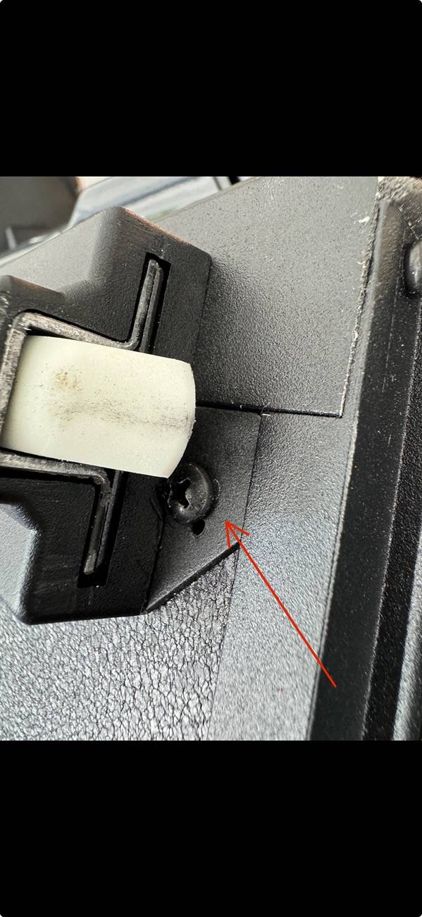

i order the MX4 Bakflip. Took awhile but finally arrived. Been a nightmare, it looks great but latches don’t work and it’s so tight at tailgate that it malfunctions and powergate stops working. There is a screw right under the latch which is a problem too. Don’t buy it.

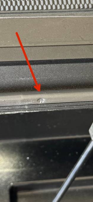

I just checked my MX4 and it also has those indents due to the screws. That indent is in a rubber seal though. How do you have your cover positioned at the front? I don’t have power tailgate but it sure doesn’t seem hard to close.
I have the front “flap” seal flush with the front edge of the bed.
