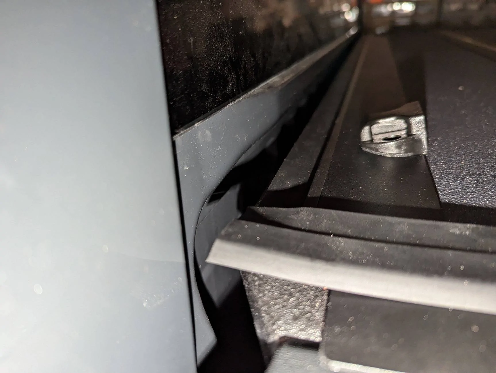

Here is my experience with the BAKflip MX4 installation on my 2024 TRD Sport.

One thing the model year 16-23 instructions don't call out is that the cover should be slid all the way forward so the flexible trim seal fully covers the end wall of the bed. That's the only way I could get enough clearance between the tailgate and the cover latches on the last panel. The instructions say it should have about a 1/8" gap at the tailgate but can't get that unless the cover is all the way forward.

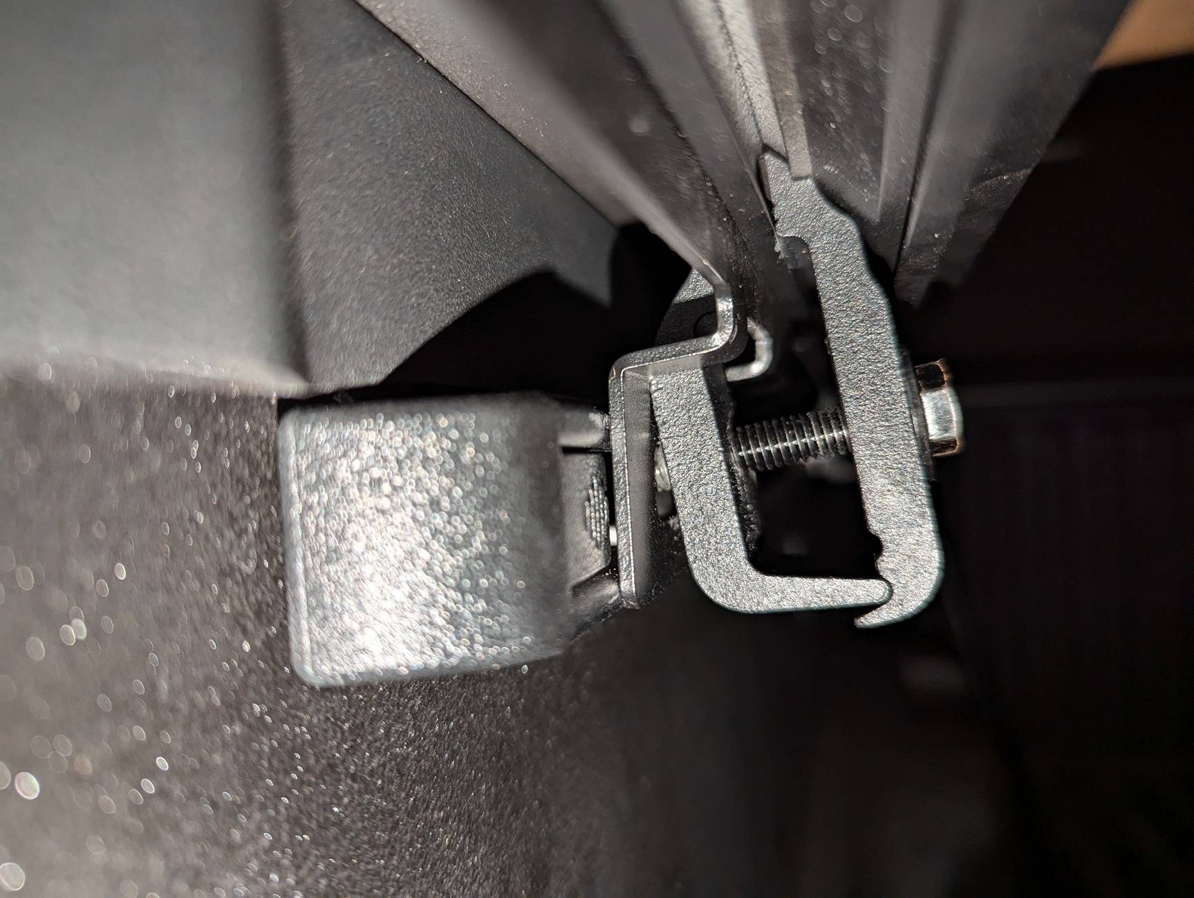

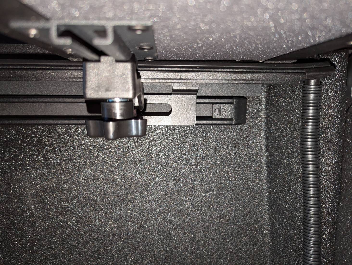

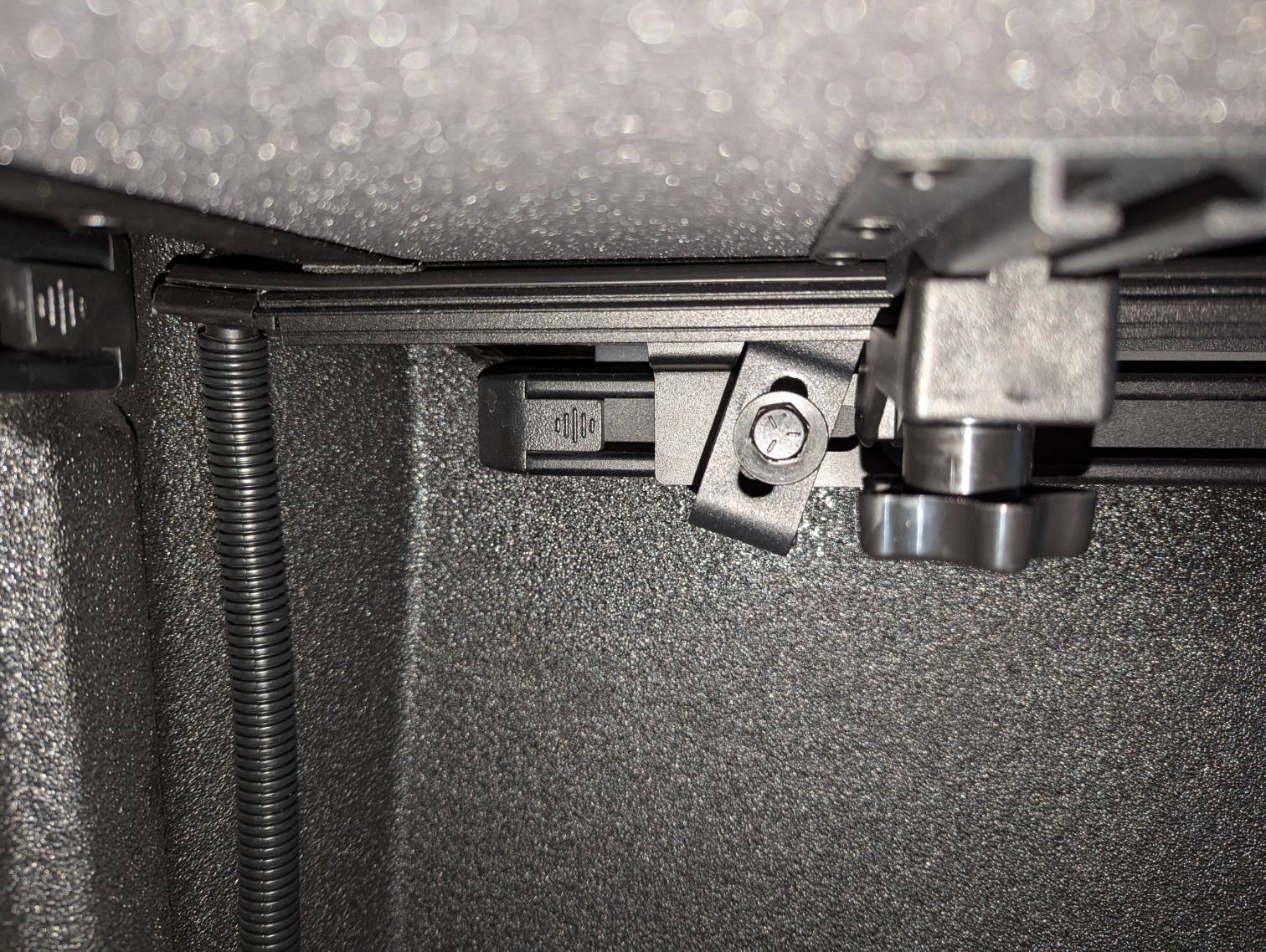

The main problem was that the clamp (part G in step 5 of the 16-23 instructions) at the cab end of the rail interferes with the position of the cover retaining clamp (part F in step 9). Both of the parts can only go in one spot so not sure if that's a design problem or something I just haven't figured out.
This is what it looks like with the clamp in place showing how it's position interferes with the cover retaining clamp. The adapter rail can't move and the outside part of the clamp must go in a slot (not shown) so can't figure out how to get them aligned.
Because the cover must be all the way forward to provide clearance for the tail gate, I removed the clamp (part G) until I figure how to get them side-by-side. It's not ideal, but it'll work for now.
The final thing I had to figure out was how to get the BAKFlip rails to be vertical against the rail adapters which are mounted to the OEM rails. This is covered in steps 5 and 6 of the model year 16-23 instructions but getting it perfect turned out to be hugely critical.
The top of the bed side of Clamp G must be fully inserted into the rail as shown in step 6 to ensure the rail doesn't lean toward the bed. If it does, it will be too low for the cover latches to lock into place. I had to pull back on the rail while inserting that part of the clamp to get it to fully lock in place. Once that was done, the rail was level with the bed cap and the latches now make a very satisfying click when they snap in place.
Instead of having the bottom of the rail side of Clamp G meet the upper slot at the bottom of the bed side of Clamp G like the instructions said, I used the lower slot as that seemed to work better and keep it level. Other than that, the diagram is close to what I ended up doing.
This is how they look installed.
Here are a few more shots of the final install showing the overlap near the cab and the clearance near the tailgate.

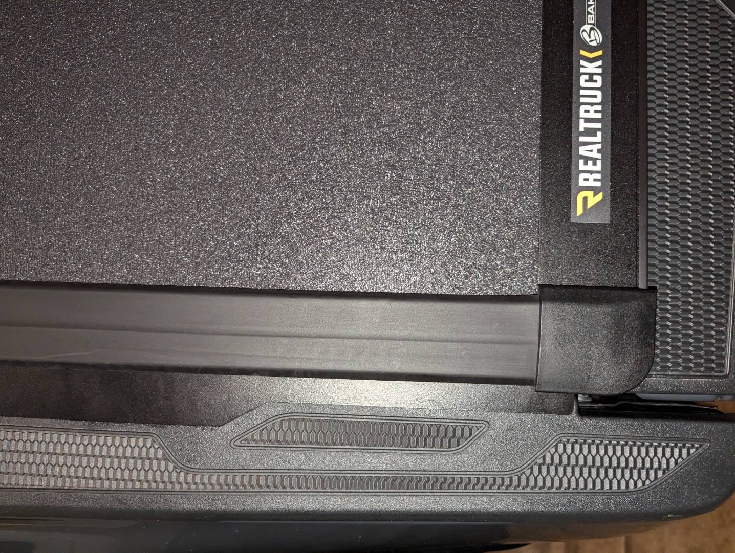

Front of cover overlapping the cab end of the bed.
Clearance between the adapter rail and the tailgate fully closed.
With the back panel slightly lifted. I wanted to show the clearance from the latch to the tailgate but it's hard to see,
For reference, here is how the BAKFlip rails overlay the OEM bed top rubber.

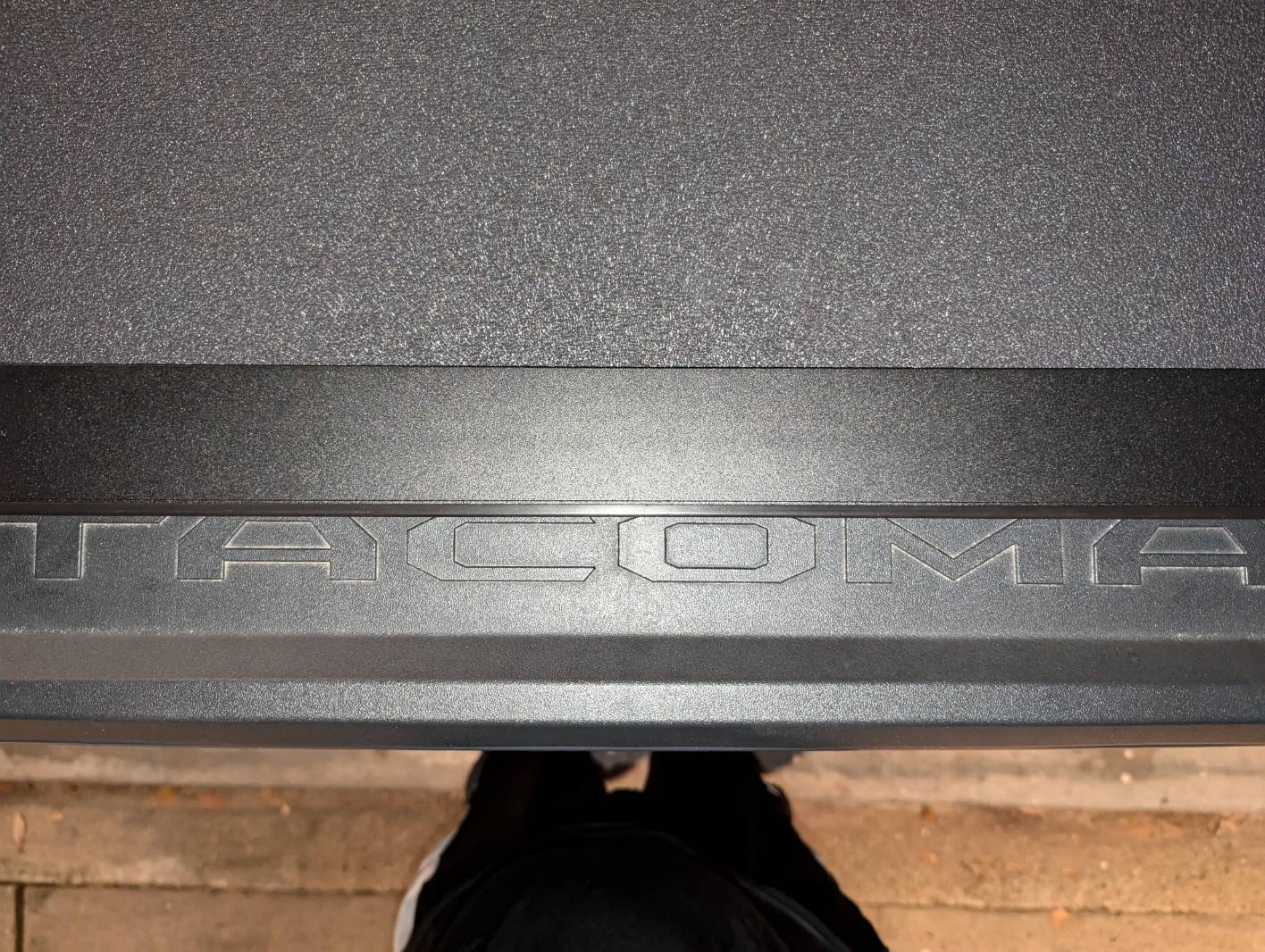

and finally, how it overlaps the Tacoma on the top of the tailgate when it's closed.
