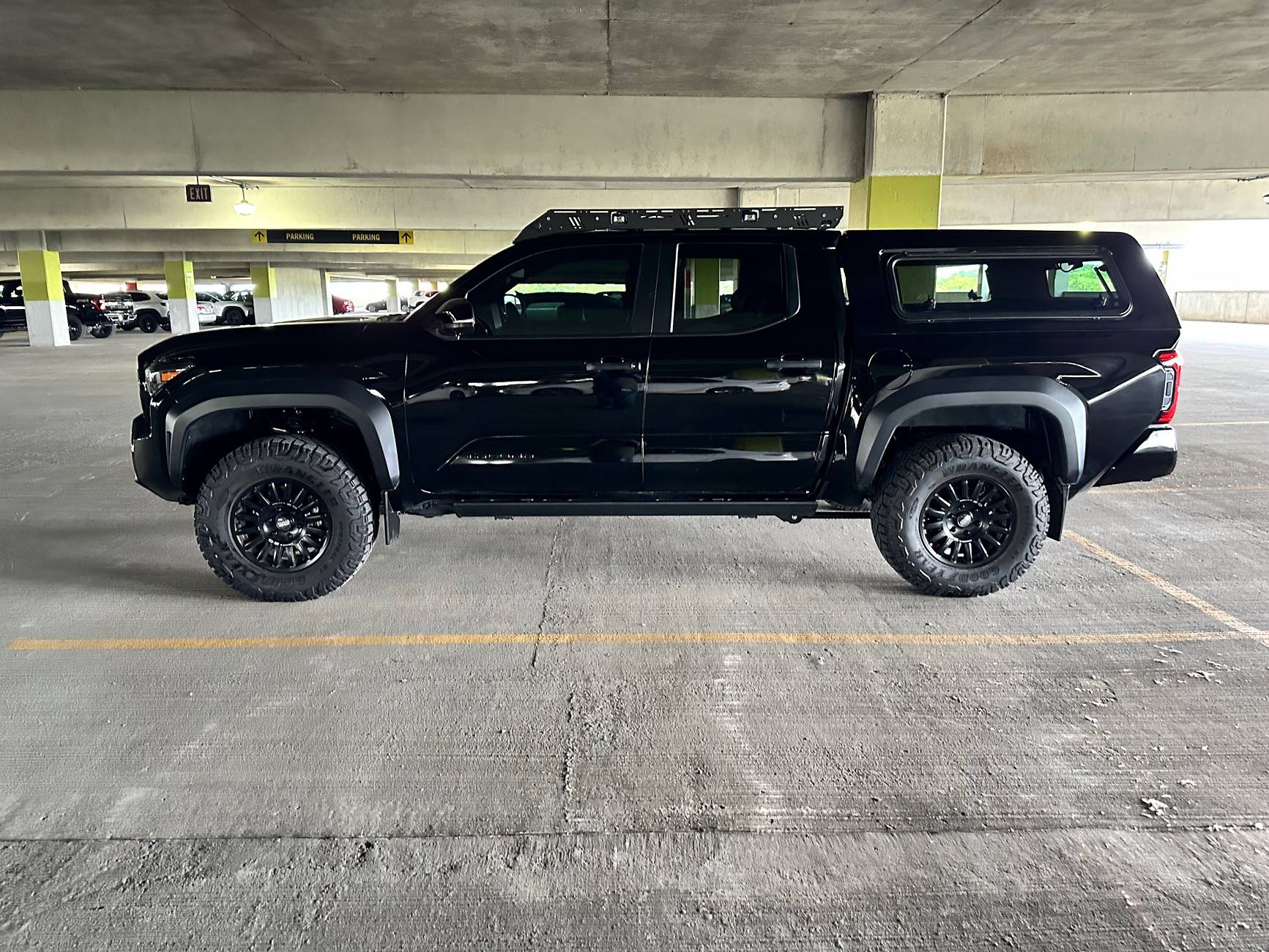

Hello everyone. I finally installed my Westcott Designs lift. I can say, it's a job! I wanted to let anyone know who is going to do this with a TRD OR to not try to knock off the retaining ring at the bottom of the shock. It is actually threaded. I think they did the video on an SR5.

I’m not exactly sure what you mean about vice grips. I do not Have stabilizer disconnect. If you mean the part to remove that retaining ring, I think it’s gonna depend on which model . The video from Westcott shows you taking a wrench and banging that retention ring down the off-road is actually threaded at that ring and you have to unscrew it. I don’t think you can do it without chucking it up in a vice. Make sure it’s a machinist vice with smooth Arms. It’s on with Loctite and should be replaced with red Loctite.

It pains me seeing the rod held in a vise like that. Aluminum jaws on the vise would be wise.
