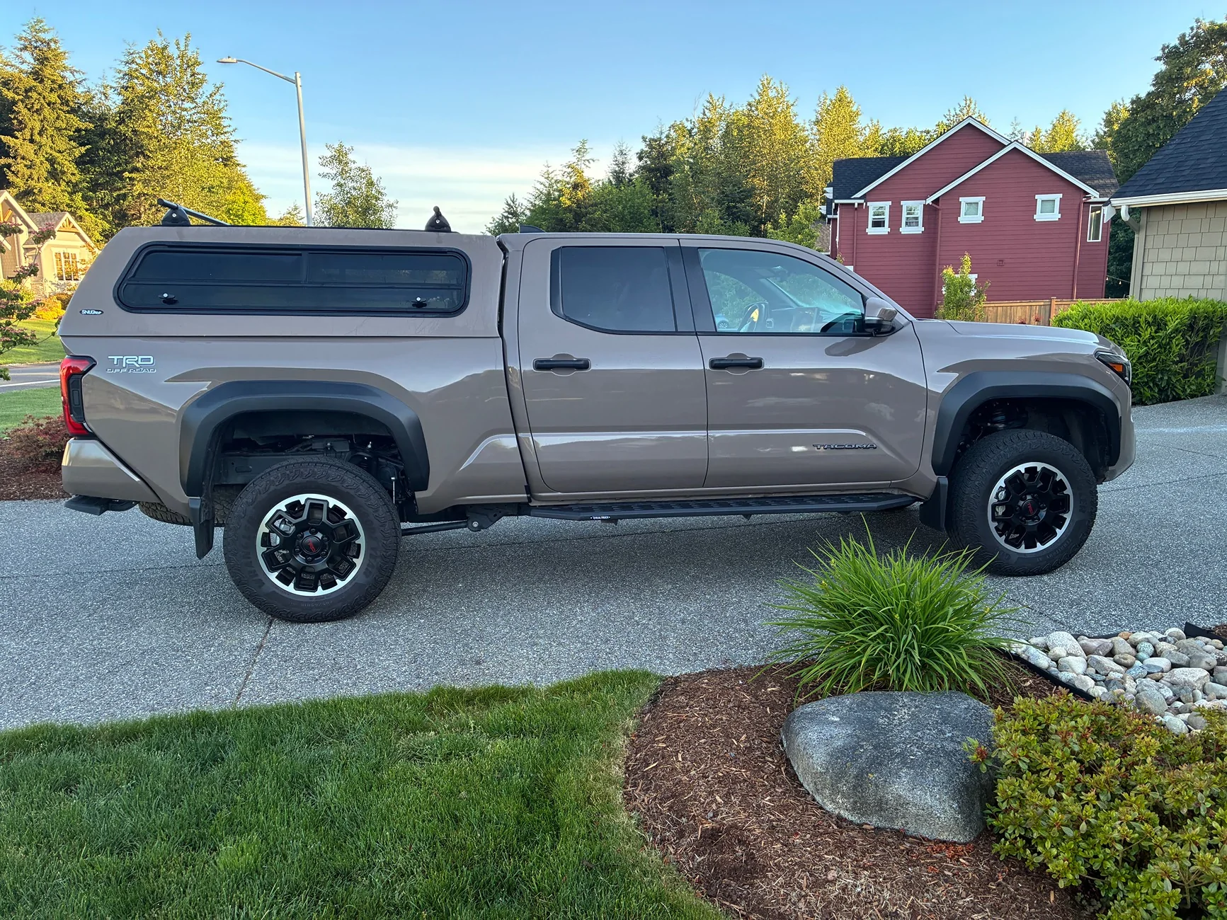

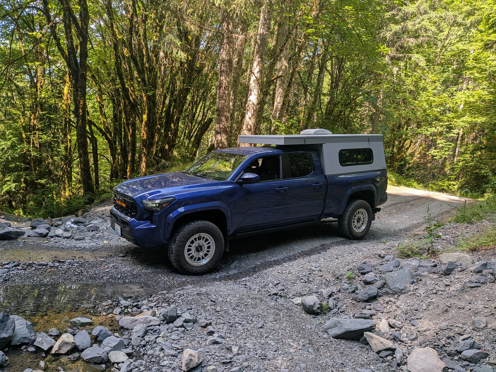

1st setting put me level. Gave 1.5" total. Had to add 1/2 inch rear spacer and ended up going 1" rear spacer before switching to overland springs. Remember if you use the wheel wells to level you'll be nose high. Slide under there on flat ground and measure from ground to the front of the cab/rocker, and ground to the rear of the cab/rocker.
This is long bed, 1st clip, 1/2 inch rear spacer:
2024 Tacoma Bilstein 5100 First Impressions (installed on 2024 Tacoma TRD Off-Road) 2713

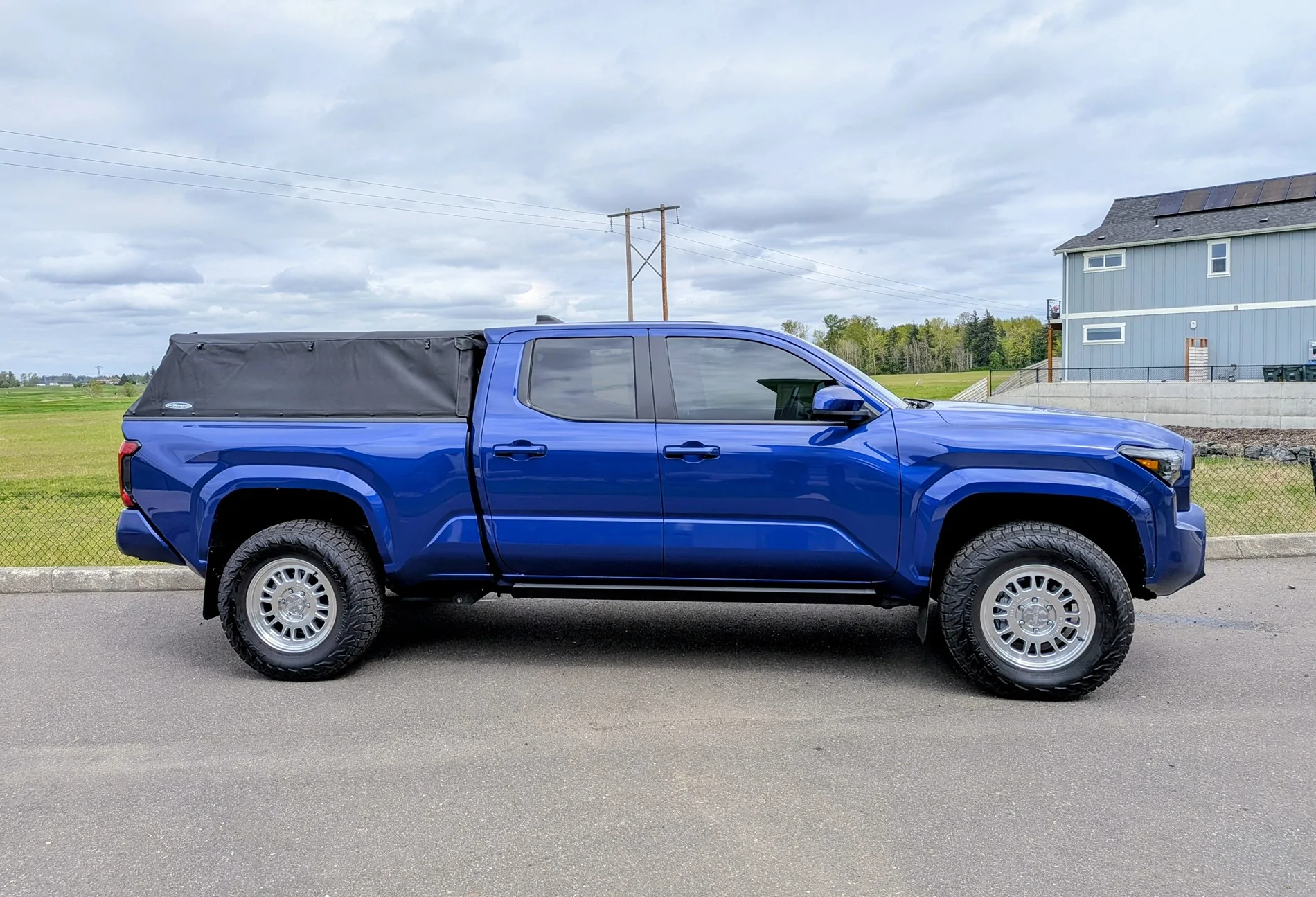

1st clip, 1" rear spacer:
2024 Tacoma Bilstein 5100 First Impressions (installed on 2024 Tacoma TRD Off-Road) 2807

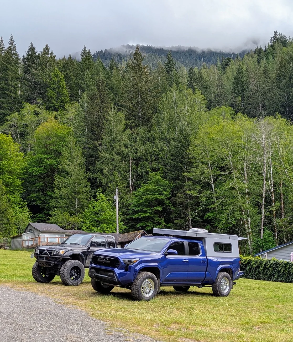

I installed 5100s and am a fan. Mine are set on the 4th setting. Little over 2 inches. I also installed Dobinson’s 819s in the rear. I have run 5100s for a quarter million miles on previous rigs without any issues, so they’ve definitely treated me well.

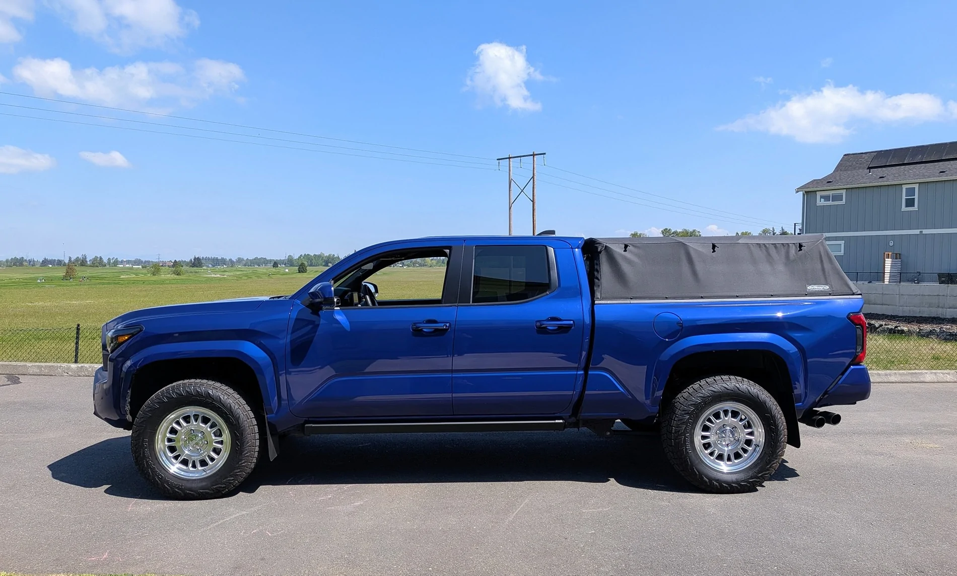

Dude I love my 5100s. They ride awesome. IF one breaks they're cheap. And they don't have a bunch of dumb breakable parts. I was considering saving up for kings but just had a bearing take a shit on my expensive King end links at 1500 miles, then the customer service rep told me Toyotas suck 😂 I'll stick with my 5100s lol (icon overland springs in the rear)

Agree completely! Bilstein 5100s represent a darn good value. Sweet truck ya got there!

Are those stock tires?

Yeah, stock Goodyears. Gonna run them bald before putting a new larger set on. Funny thing I got a flat on one driving home from the dealership all on paved roads by running over a piece of gravel in my TRD Off Road edition pickup. Thought that was ironic.

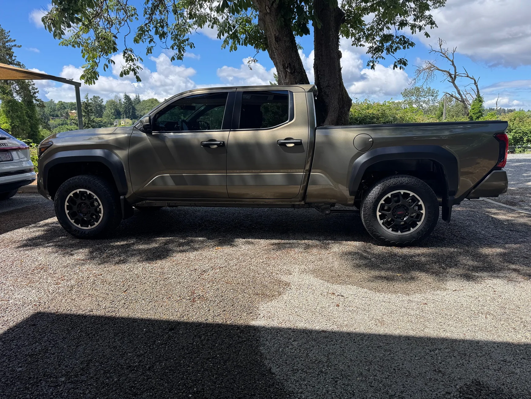

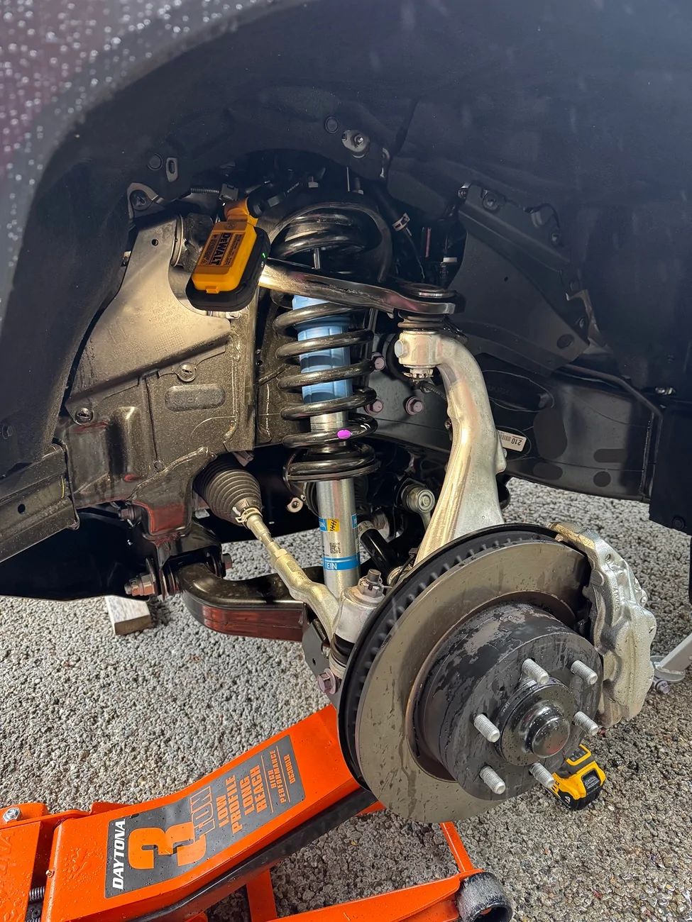

Just installed 5100s in the front. Set them at 1” (lowest lift). Overall lift was 1.25” in the front. Exactly what I was looking to do. Now there’s a 3/4” rake. I noticed an improvement in ride quality. Just ordered the rears too.

Looks great! I love the ride. Super stoked with my 5100s after lots of miles.
