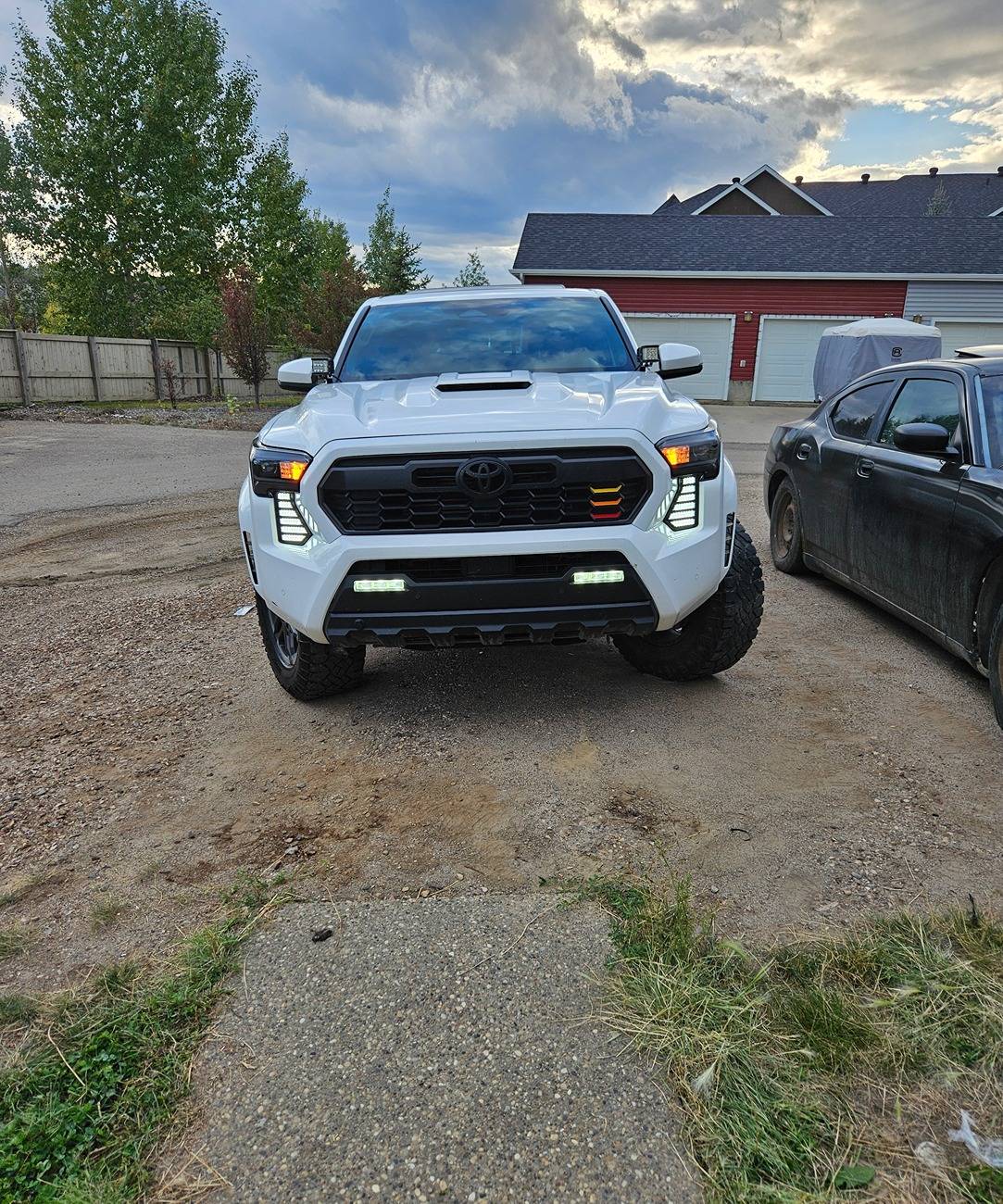

Those "fang lights" looks wicked cool. I almost bought a set but then I came across another design. Now I'm conflicted on which one to get. ?
I love that design too, kinda sad I didn't come across it when window shopping. They definitely look just as good!

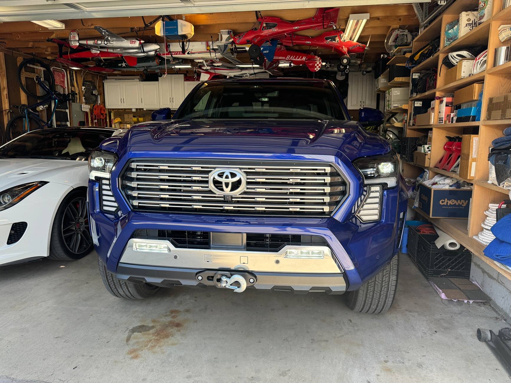

Seen these on a Tundra TRD Pro around town ~ a little more subtle with thinner light bars, feels a bit more OEM. Anyone see anything similar for the Tacoma?
2024 Tacoma Anyone installed DRL fog light “Fang Lights”? IMG_0072

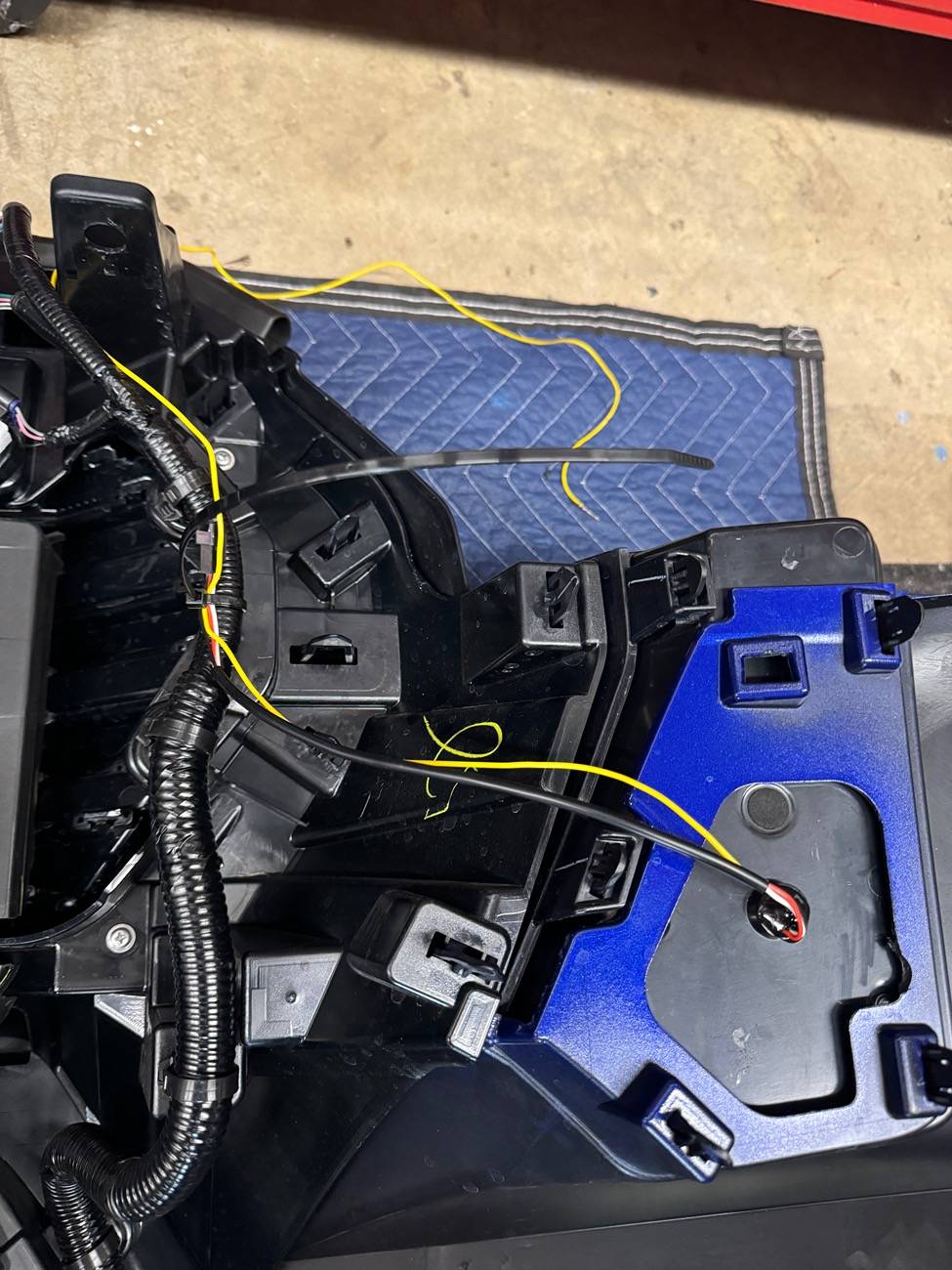

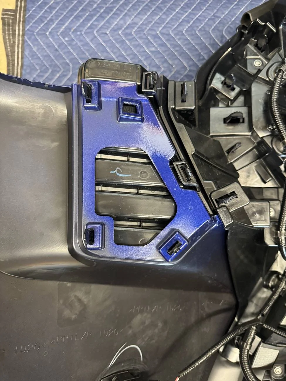

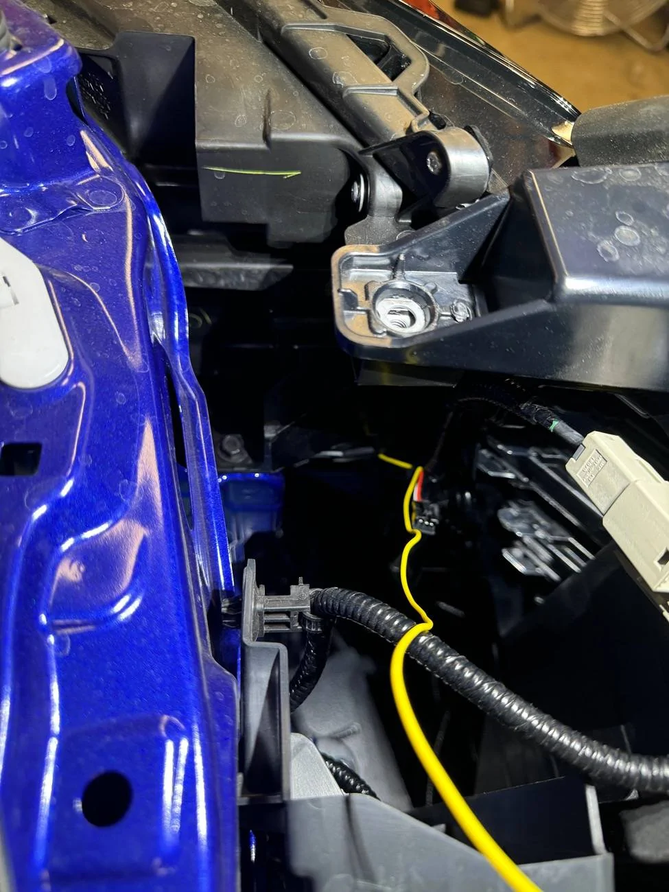

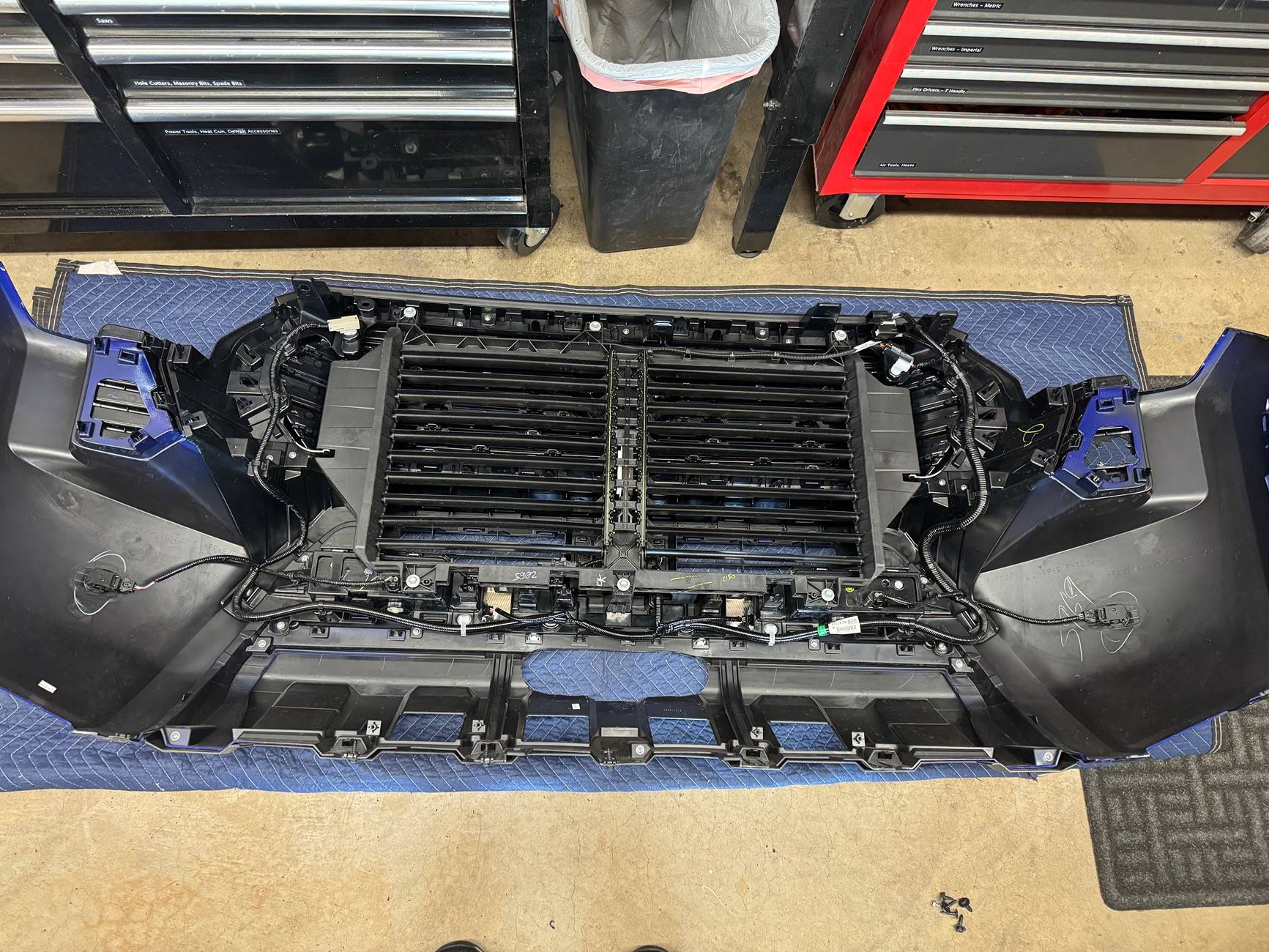

I went ahead and removed the bumper - again - to install the fang lights. This is the physical install. I left the wiring to be done later, once we figure out the correct place to tap into the stock wiring harness. Note that I zip-tied the plugs to existing wiring so its easy to access once it's all back together.
A couple of observations: I don't think you can do this install without removing the bumper. The stock inserts have very stiff tabs, and the mounting points are fragile. I would advise against trying to pry this out from the outside. Bumper removal isn't that hard, took about 10 minutes the second time. FYI.

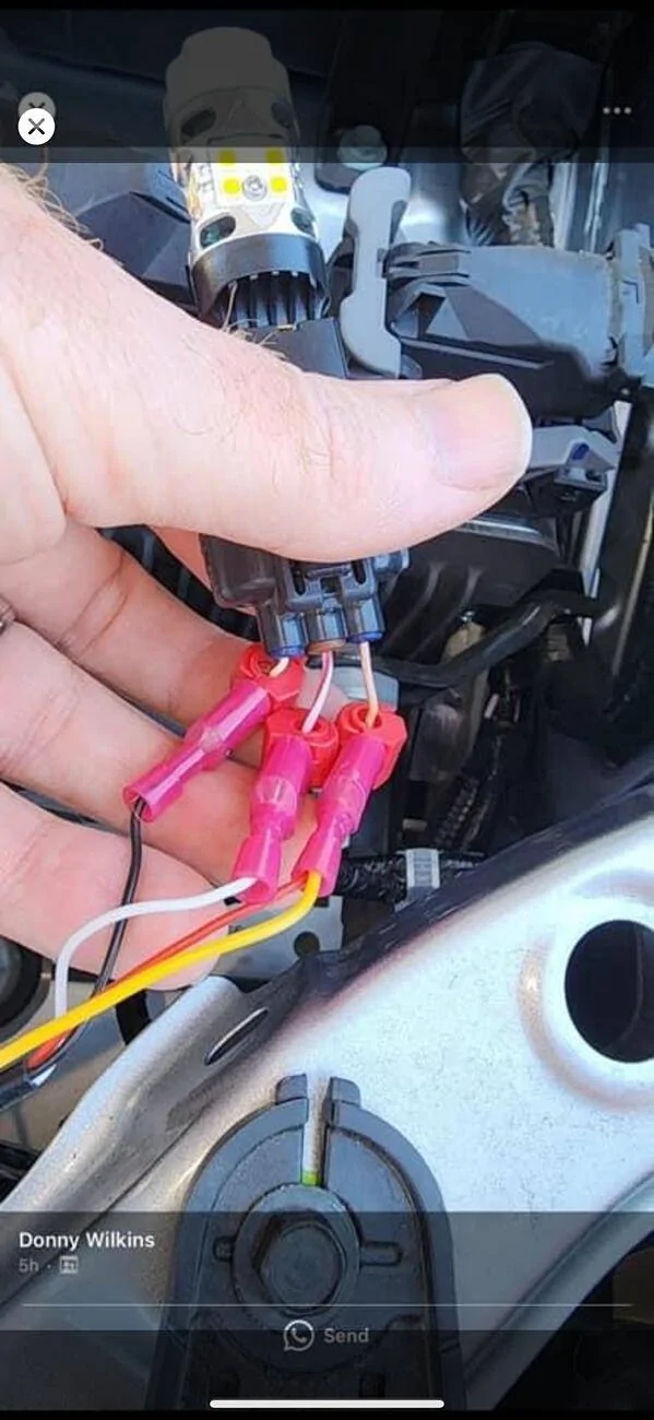

Can you take a pic of where you tapped into for the fuse tap into the accessory slot? Also if you used add a fuse what amperage fuse did you use? Pics please. Also the signal wire taps into your blinker peach colored wire. Photo showed is from a fb member. This is the route I was going to use if not successful with the add a fuse.
