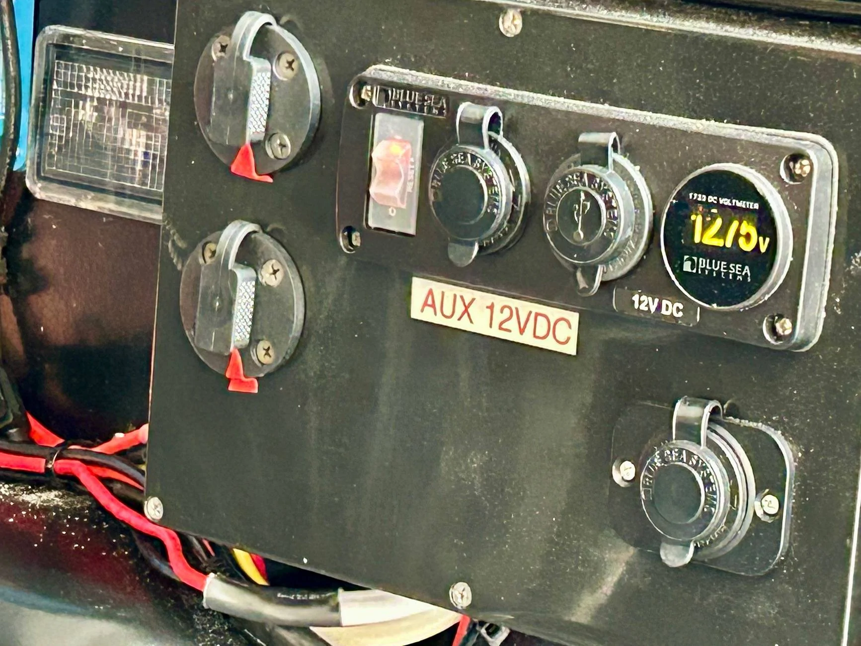

We use our truck to overland. For what it may be worth I want to share my recent battery auxiliary battery installation.
I used a 120AHr, Kickass AGM deep cycle. The battery was chosen for its narrow footprint. Charging underway is provided via a Victron 12.12.30 DC-DC charger powered by the truck. I provided for 2 SAE import plugs ( for solar panels that have independent regulation and one input controlled by a Victron MPPT 75/15 solar controller. I provided for a 12 vdc outlet plug from the aux battery to supplement the factory 12vdc outlet powered by the truck starting battery. Finally, a rotary cross over switch was installed. The default position is OFF. It is available to jump the starting battery if needed.

Nice set up. Can you charge the battery from both alternator and solar at the same time or do you have some sort of switch to only charge from one or the other (automatically or manually switched)?
When I was looking for a solution my primary concern was I wanted to charge from solar whenever it was available but then supplement that with alternator charging whenever the truck was running. I didn't want to have to remember to switch back and forth and my solar generator (Ecoflow Delta 2) only had one dc input. I could have used a couple of relays and created some sort of break-before-make type circuit but that seemed like a pretty inelegant solution. I ended up (long story) with the ETaker F2000 and am quite happy with it.

Can you please describe where you are tapping into alternator power?
Did you make a diagram of your install? Love to see a schmatic?
I DID NOT DRAW A PLAN. I DID THE COMPLETE INSTALLATION-- EXCEPT FOR THE DC/DC CHARGER. ON THE TH AND OTHER HYRIDS THERE IS NO ALTERNATOR AND THE 12 V START BATTERY IS UNDER REAR SEAT AND IS CHARGED OFF STEP DOWN FROM TRACTION BATTERY. FRANKLY I HAD THE DEALER WIRE IN THE VICTRON DC-DC CHARGER BECAUSE I WANT NO BLOW BACK FROM TOYOTA THAT I DID SOMETHING WRONG AND WANTED NO ARGUMENT ABOUT THE WARRANTY BEING IN FULL FORCE. I POSTED EARLIER ABOUT WHAT FOLKS WERE DOING TO CHARGE AUX BATTERIES AND DIDNT GET MUCH INFO
Would you be willing to take a picture of the termination of the positive input for the Victron Dc/Dc charger? Is it connected directly to the positive terminal of the battery or is it connected to one of the alternate taps that are under the red plastic cover that is on the positive side of the battery? Or is it connected in another place?
I have poked around and on the side of the battery where at least some of the positive wiring terminates there appears to be an unused post terminal and I was wondering if that is what they used for the connection.
Thank you for you help.
