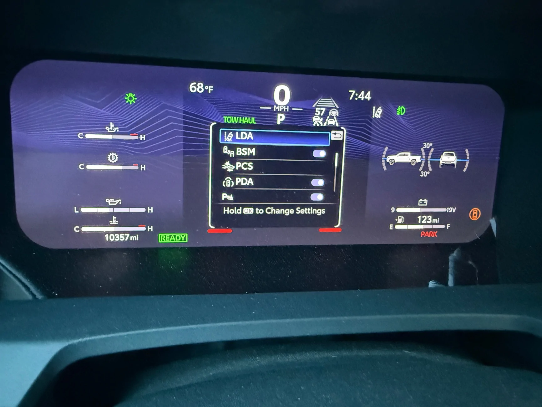

Interesting that you mentioned Tow Haul. Yesterday I drove home in Tow Haul mode (~300 miles). Just before shutting off the truck I took a picture of the dashboard. In the lower right area, you can see the voltage meter below the 50% point. I noticed this a few times during the trip home, but not on the way there 4 days earlier. The day before we left, we took a drive around the lake and up the mountain for about an hour and a half, broken up by a couple of stops.
Might be time to get that Optima Yellow Top and request my tuner up the alternator charge level to keep it happy.

Ya mine always bounces between the - and the + on the little digital battery. When I got in the truck today is was closer to the plus and when driving it’s closer to the minus lol
let me know if you do the optima battery. I don’t like having less than 100% confidence when I am hours away from a road.
Also, ooooof your trans temp, lol
