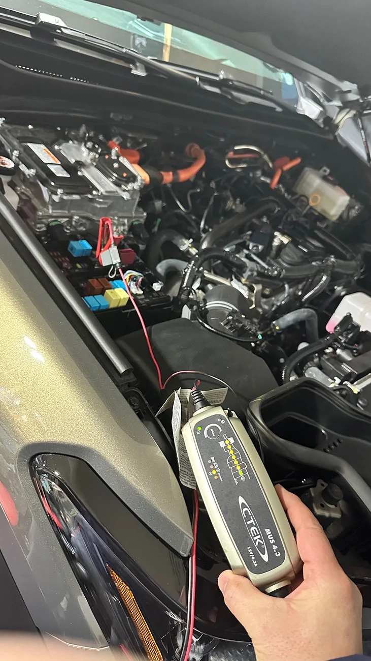

I do have my Porsche Macan on a trickle charger regularly since thats not my daily driver. My motorcycle is always on a trickle charger because they get dont get ridden frequently either and saves me buying a new battery all the time. Your best friend is a trickle charger for anything not used much, saves you a ton of money on battery replacements.
I used to do the same with the motorcycles I had over the years. Especially when I was in central NYS, less so in GA. Now I do the same with a wave runner and a boat, though the latter has a battery switch which eliminates all parasitic drain.
It’s expected that with enuf time normal parasitic drain will impact starting a vehicle, but it ought to take weeks not days.

Yes - the app does run down the battery if you stay logged in. The same thing happened to my wife's SUV. Since she stopped using the app her battery has not run completely down again. But I think the root cause is that anything can run down the battery when it is kept at such a low state of charge.

A trickle charger will definitely do the job. I find it easier to just carry a jump pack so I know the truck will always start. But if you don't charge the 12 volt in a hybrid or carry a jump pack it is just a matter of time until it leaves you stranded IMO.
On another list, someone has been charging through the jump point in the fuse box. That would be easier than getting under the seat every time.

Wouldn't just attaching a trickle charge be easier? That's what we do with the RAV Prime and TH.
