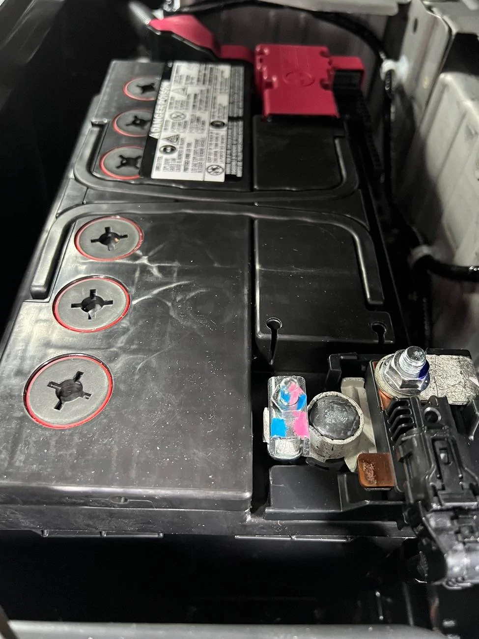

This doesn’t look like an AGM battery…

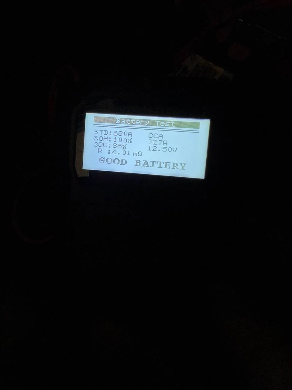

Hmmm…interesting results.

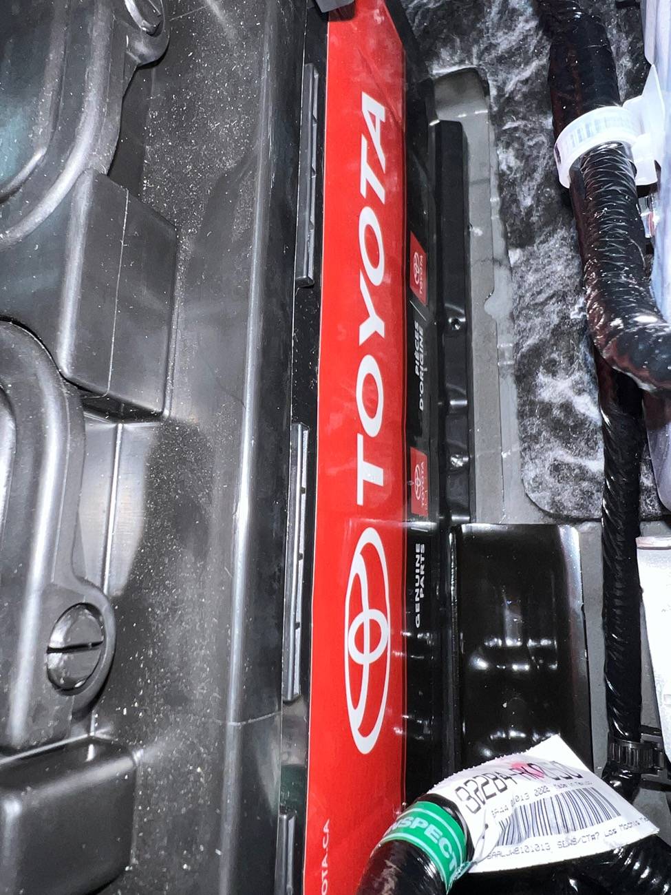

also…I would guess my selling dealer had already replaced the battery…as this one isn’t a factory one. It’s a Toyota (Canada) parts counter battery

Could be different in Canada. AGM in my 24.
I believe this is the Toyota battery for hybrid.

This is the battery that is in my LTD HV straight from factory (the vehicle was less than 2mo from factory build to my hands and 5w of that was Toyota transport from factory to dealership).
