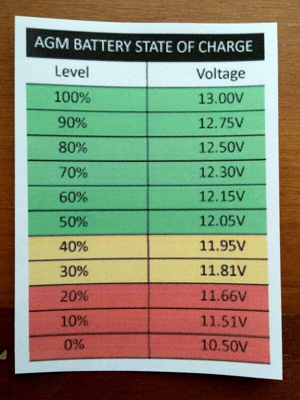

Here is a chart for AGM batteries. I am shocked at problems since Toyota has been using AGM batteries for hybrids for a long time.
Regular battery charging can break AGM batteries. Regular batteries need 15-17 volts to get the same amps. However, voltage greater than 15 volts can overheat an AGM and generate enough pressure to pop its safety valve.

Looking at the chart provided by @Lennyz1 it looks like my truck can drain the battery to a very low level after only a few days of not being started. Either my 12v battery is bad or my truck is not charging it properly and I'll let y'all know when I find out.

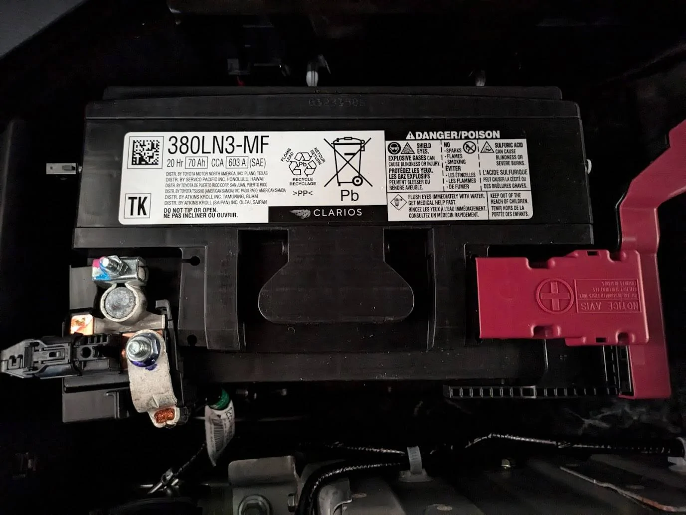

This is the battery that is in my LTD HV straight from factory (the vehicle was less than 2mo from factory build to my hands and 5w of that was Toyota transport from factory to dealership).
This is also the battery that is in my '24 OR hybrid. I carpool every other week and travel, so my truck sits for a few days and intermittently a week or so. Knocking on wood, I have yet to see an issue.
