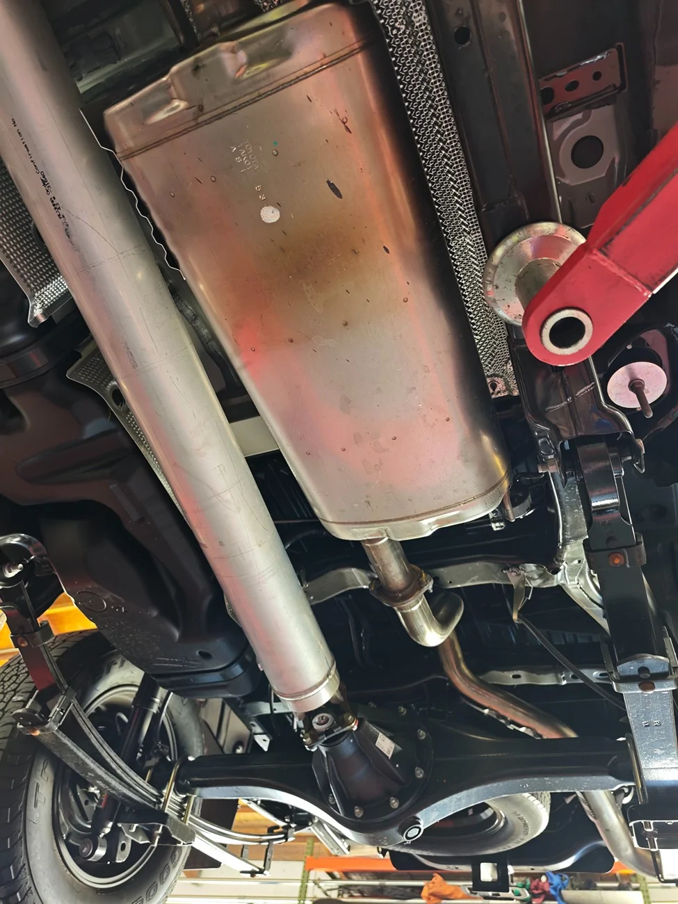

Is yours a 5ft or 6ft bed? The double cab long bed trucks have a 2 piece rear drive shaft, which can have extra issues.
5ft bed, one piece driveshaft
Pic from many thousand miles ago and pre-offroad use:
I had a 2G TRD OR with a bad carrier bearing, was considerably worse vibration than this. Ofc no carrier bearing on 1 piece driveshaft.
It's possible the aluminum driveshaft allows for a lot of normal resonance through the drivetrain that steel wouldn't.
