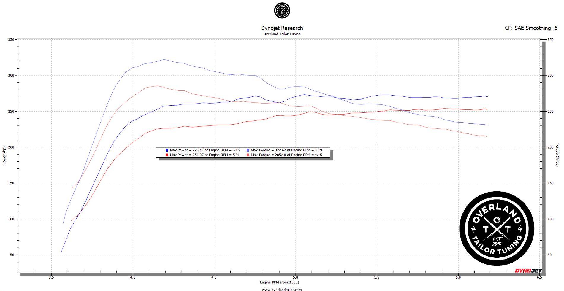

I almost made a new thread on this topic, but I thought we'd chime in with some data and observations we've made on our newly acquired 2024 Tacoma. When we picked up our truck from the dealer, they were kind enough to top it off with Utah's finest 85 Octane.
The vehicle's initial testing and evaluation took place with fuel provided, and the motor was quite audible. While conducting data for later analysis on a specific mountain route, we could see the ECU registering the knock events as we heard audible pinging.
To run the last 1/4 tank of 85 Octane fuel out of the truck, we scheduled some dyno time for baseline testing. Immediately following our dyno session, we filled the truck up with some quality 91 octane fuel, and the motor instantly became much quieter. It's still a noisy thing (IMO), but it's tolerable on 91 Octane. The long term knock learning trims were more favorable on the 91 Octane fuel too. Fast forward a week or so later, we strapped the truck back down for some further testing and development :wink: The results are quite shocking, to say the least. 85 Octane vs. 91 Octane on the stock calibration:
Proof is in the pudding! Thanks OTT! Since day 1 I’ve been using premium, and ethanol free whenever possible.
Edit: Every tank hand calculated has been above 20mpg except when towing. I’m guessing the higher octane may help mpg as well?

*Generally speaking* here, the way Toyota's ignition/knock control strategy aims to keep the engine as advanced as possible on a given fuel, the ECU will generally run more ignition advance and remove any knock based fueling enrichment when using favorable (higher octane) fuels. This will often lead to better economy when using premium fuels.
It's important to keep in mind that the knock control and ignition advance strategy don't necessarily care what the number on the pump indicates. It's going to respond to the actual threshold of knock on that particular fuel blend, 91 91 in all cases. Fresh, quality fuel from a high-volume/top-tier station will generally have the best results.
If the juice is worth the squeeze is up to the end user.

It’s good to know this wasn’t just my imagination. MPG is up around 1 MPG or so. That alone would not be a reason to use premium top tier fuel but the noise and virtually no auditable pinging (I have never read the ECU to see if anything registered) I feel it’s worth it.
