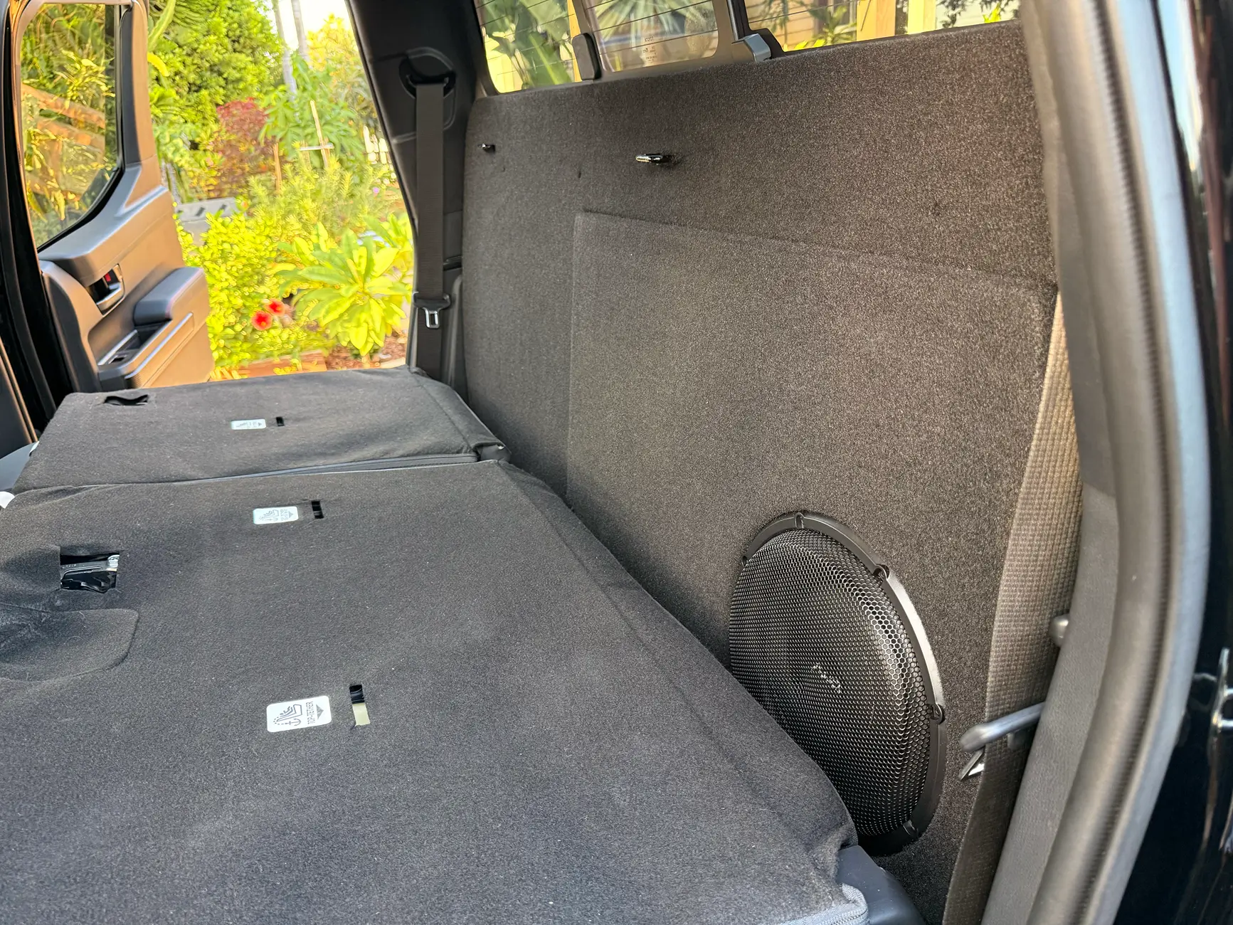

Nice! I dig that subwoofer box. I can’t find it anywhere on AudX’s website - they only have an underseat box.

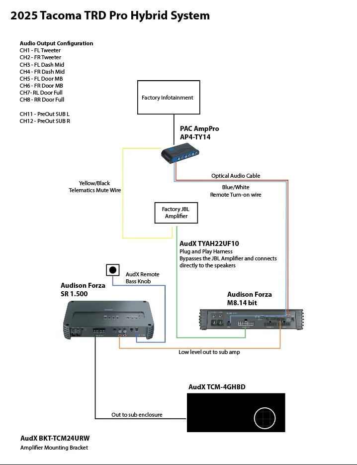

Thanks for sharing. Been waiting on tacotunes for a solution but they should change their name to Tundratunes. Would you mind sharing how it’s wired? Thank you.

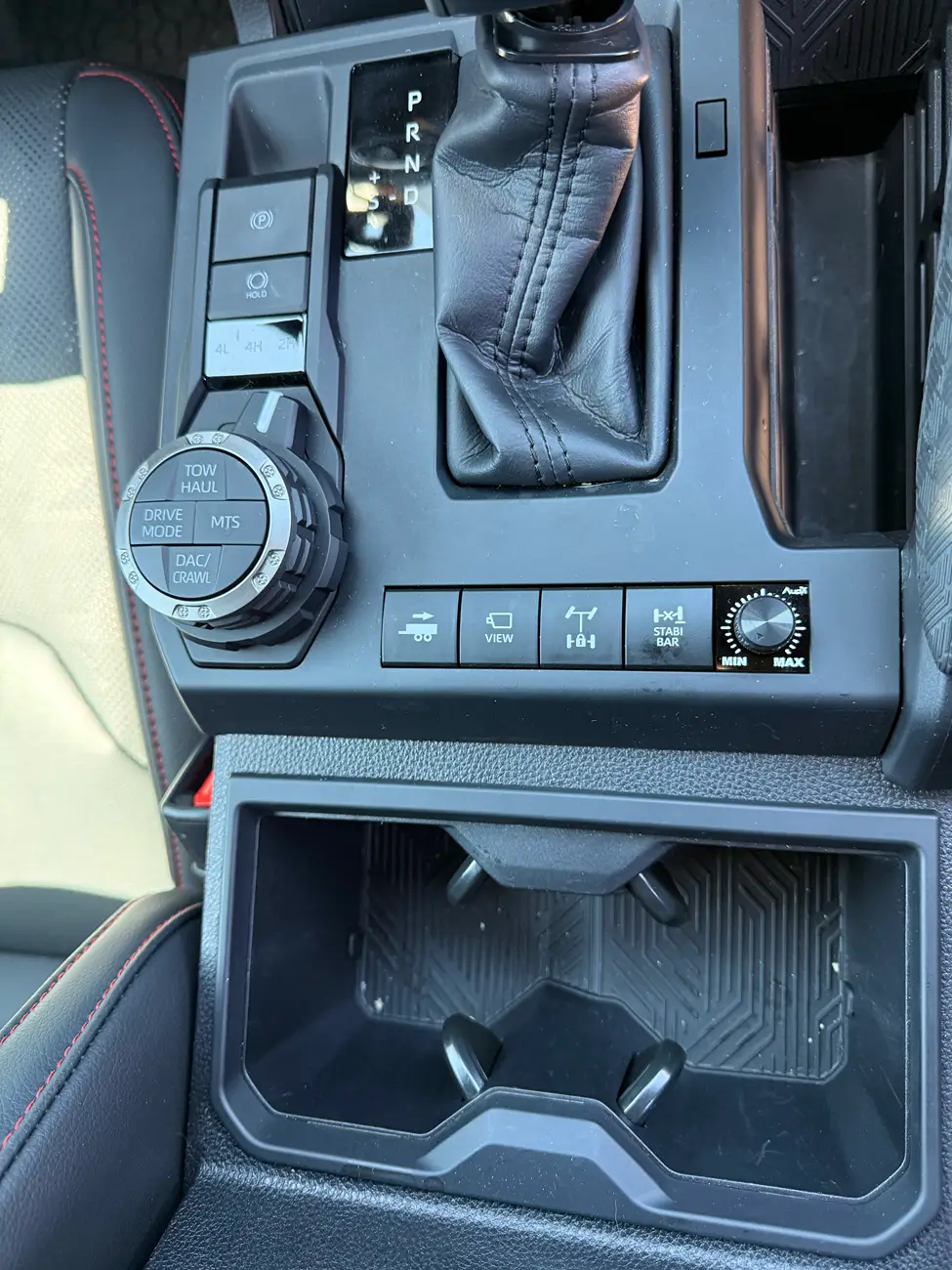

Okay, first, the bass knob mount…..P.I.M.P!

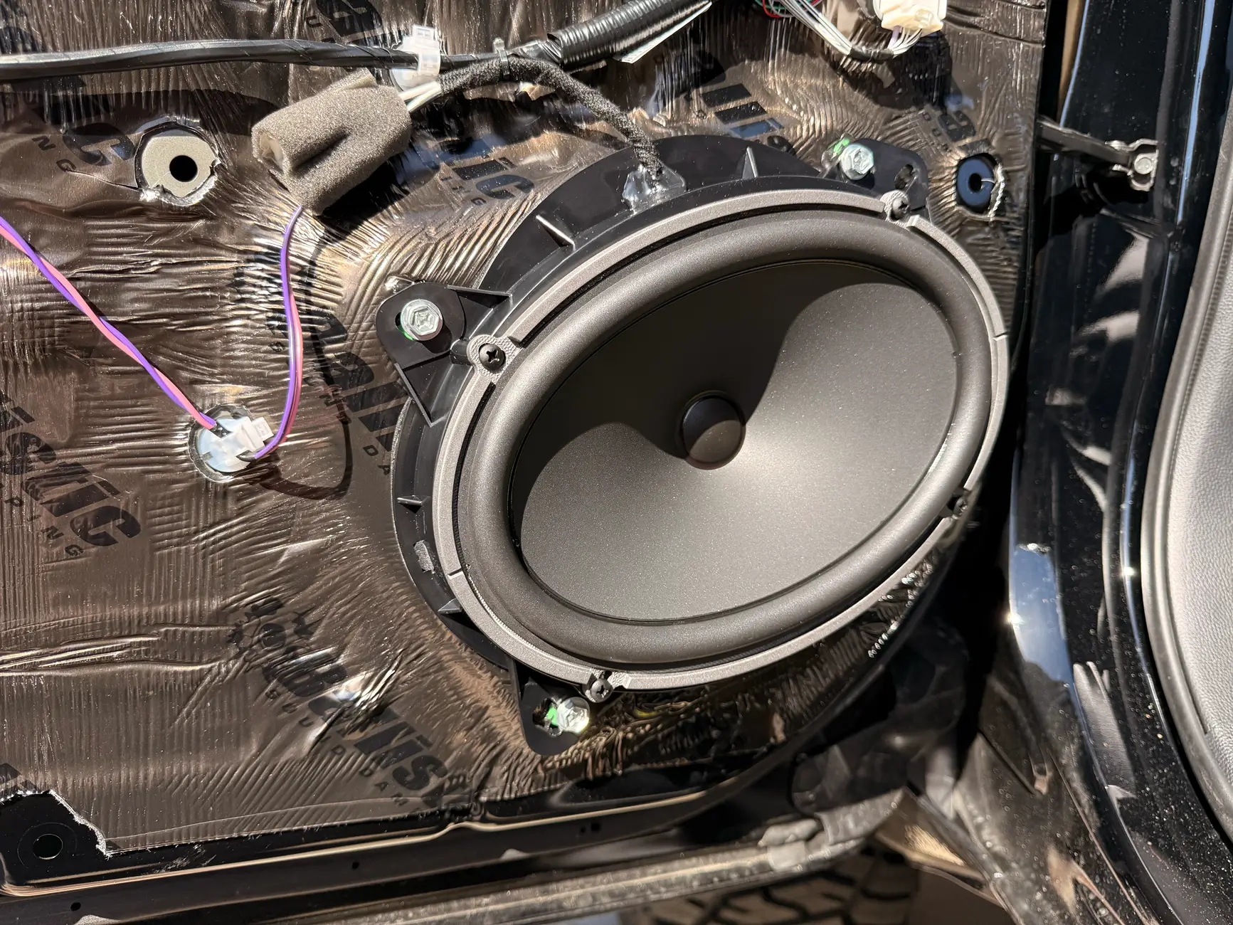

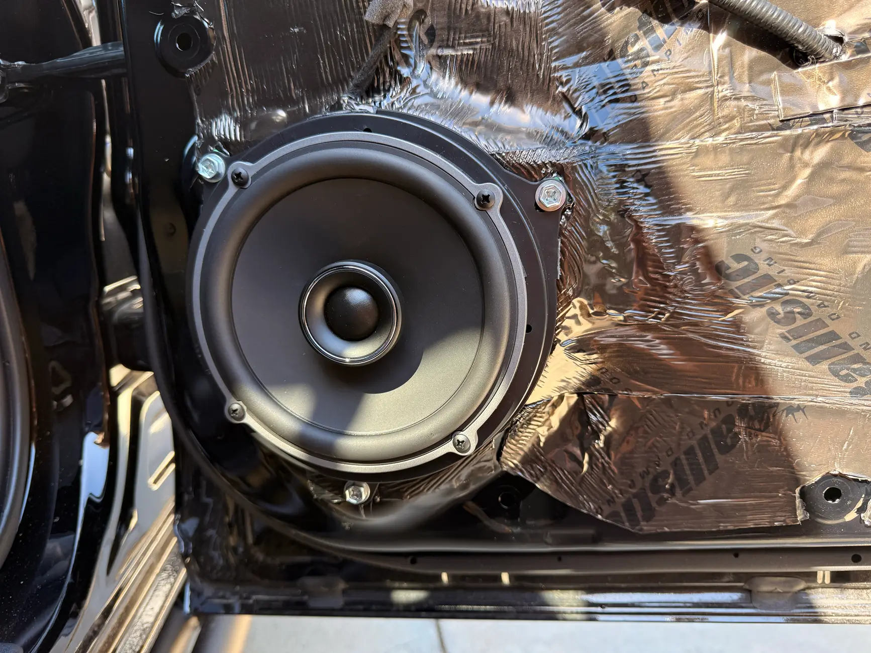

AF is always a great choice for sound. A question about the mounting depth for the mids, no issues? I have a Morel Tempo Ultra 6x9 set I was going to add the CCRW254, but they’re around 2” deep.
And, awesome news for the sub box. I’d rather lose that space than underseat for sure.
No issues at all, 2" depth should be fine. I checked various speakers before landing of the AFs

Is the audx enclosure for just one their sub or will we be able to put in our own?

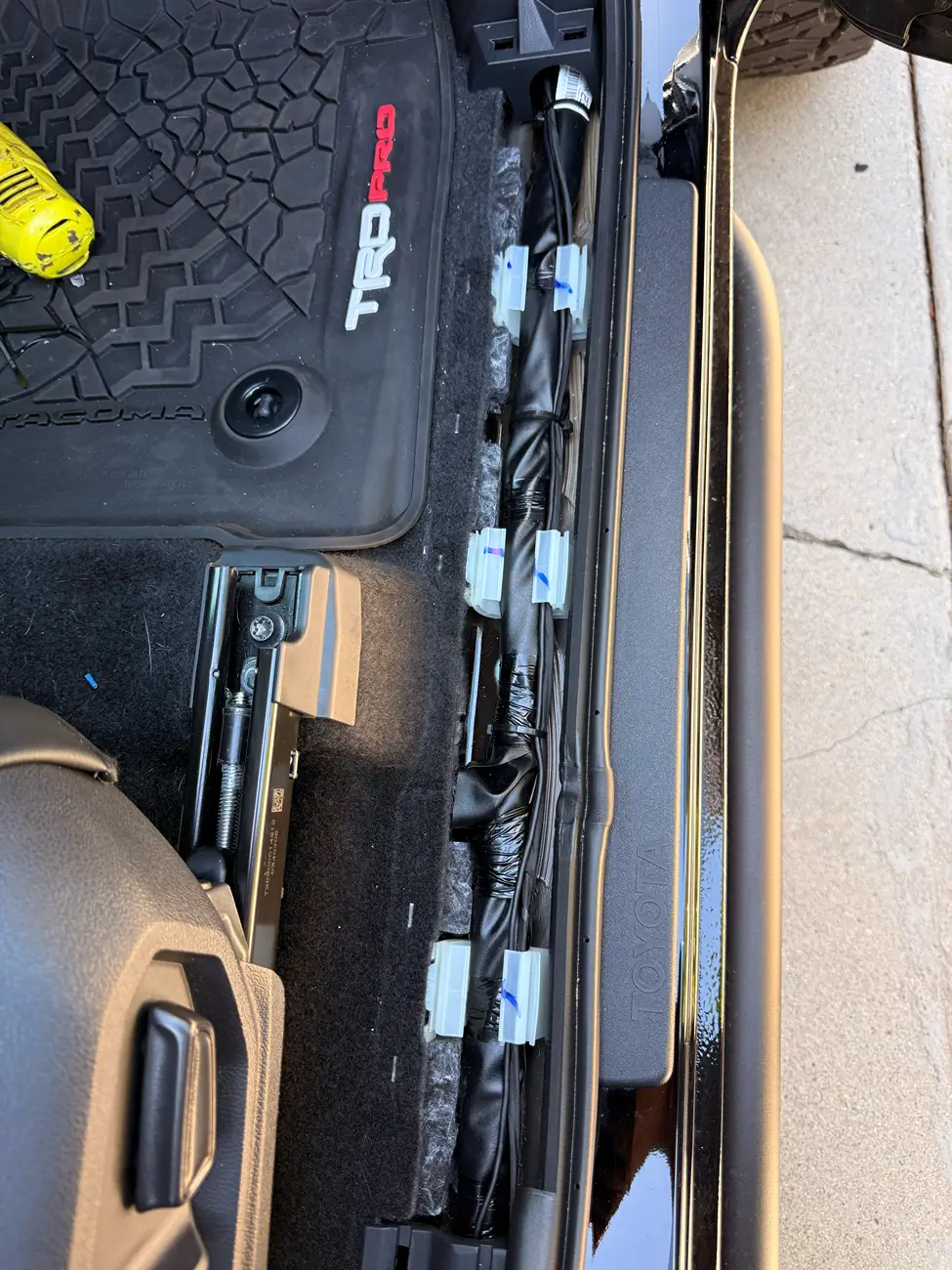

Sorry, more questions.... Does this setup with the harness allow the use of the OE speaker wires? or, did you run speaker wires from the amp to the speakers? Thanks again
It allows for the use of the factory speaker wires. You’ll have to get the speaker harness adapters but they’re all available on the AudX website.
Is it the same harness listed or is it another in addition to the one in your list? Thanks Jay. Sorry for all the questions. It’s just expensive and I don’t want to buy anything I don’t need.
I'm not sure what your asking but I think your are asking for the exact parts that were used in the installation, correct?
If so, below is a list:

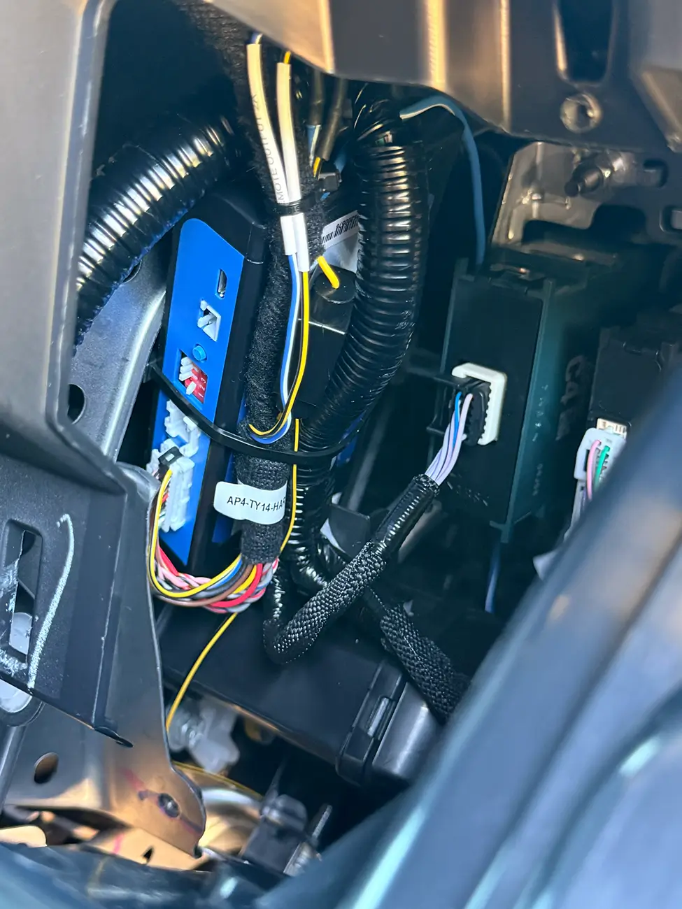

AudX - JBL Amplifier Bypass Harness - Allows you to use the factory wiring and extends to the back of the cabin to the speaker output of the aftermarket amplifier.
https://www.audxsound.com/products/tyah22uf10
AudX - Door/Dash Speaker harness - Allows you to connect aftermarket speakers to the factory wiring.
https://www.audxsound.com/products/tydh92u
AudX - A-Pillar tweeter harness
https://www.audxsound.com/products/tytwh03u
AudX - Telematics Mute Wire Harness - Adds a mute wire extension to connect to the PAC AmpPro if you are retaining the SOS/Voice prompt audio only needed if you don't want to splice the factory wiring.
https://www.audxsound.com/products/tythmw22u
