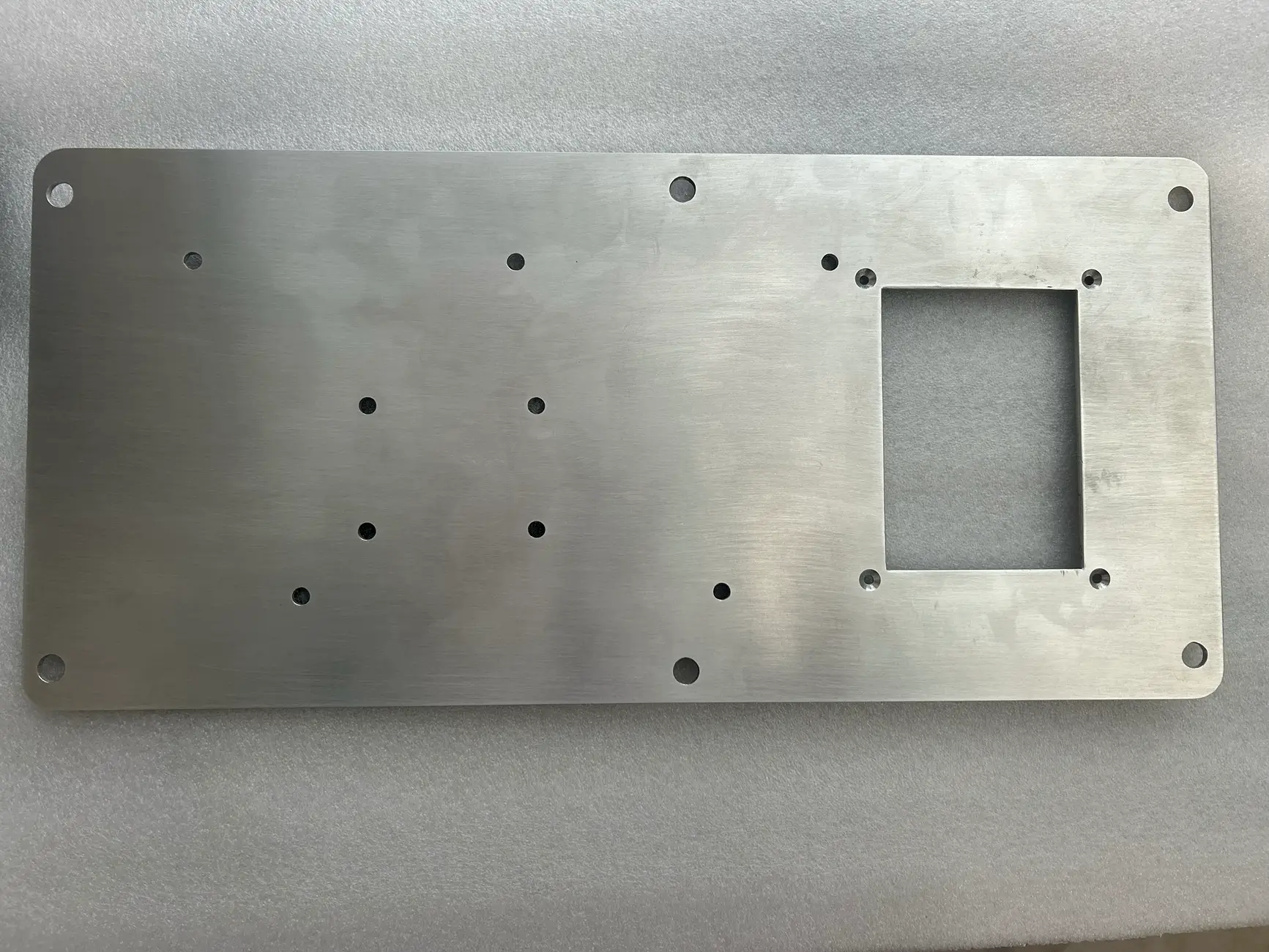

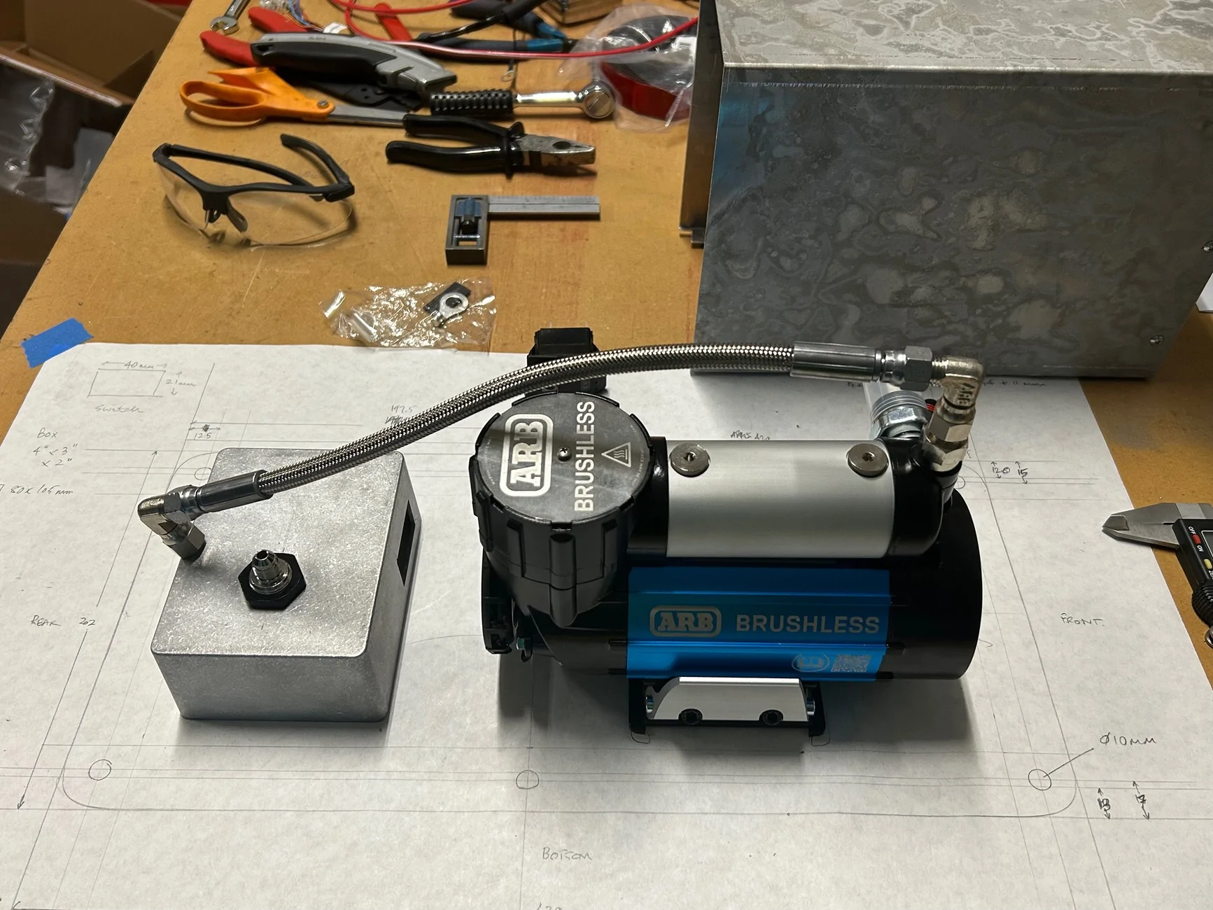

Making the mounting hardware
I started by unbolting the storage cubby and making a full size paper template by tracing the edges and marking up the bolt holes, cross checking with some careful measurements. Then the various items to be mounted on the cover plate could be mocked up.
I planned to use some 1/8” aluminum sheet for the main cover and mounting plate, a thinner sheet of aluminum for a dust cover and a die cast aluminum box to mount the air connector and power switch. It turns out that aluminum sheets almost exactly the right size were available from Amazon, as was a suitably sized die cast box which was actually intended to be for a guitar pedal effect enclosure:
Aluminum sheet: https://www.amazon.com/ACXFOND-Alum...-1-spons&sp_csd=d2lkZ2V0TmFtZT1zcF9hdGY&psc=1
Diecast box: https://www.amazon.com/DaierTek-Enc...+guitar+effect+pedal+enclosure,aps,199&sr=8-4

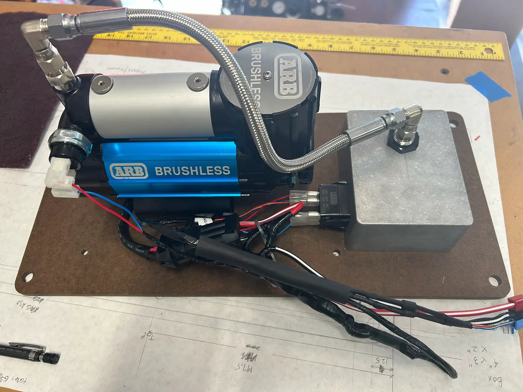

I have a CNC router, so entered the cut list into the CAD program and tested this out on a piece of cheap masonite. This allowed a complete photo build up of the compressor etc.
2024 Tacoma Air Compressor Build - compressor choices and building into TRD OR bed tempImageTLW76D
With this all checked I moved onto milling out the aluminum, resulting in a nice clean plate. I machined this in two passes, starting with the interior cut out and holes, to ensure that I could ensure a solid mounting of the metal to the machine when I milled the plate edges on the second pass.

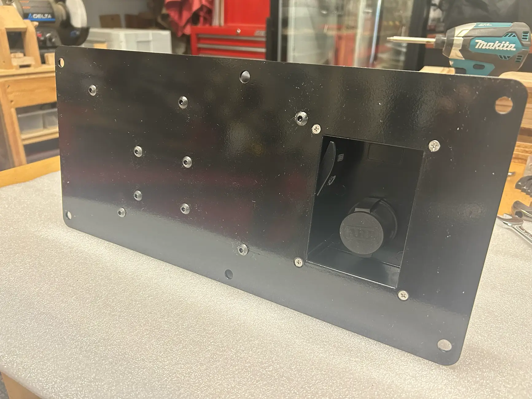

The visible metal components were then painted with some primer and black gloss spray paint and the various pieces of the compressor bolted into their final positions. The aluminum for the shield was an offset found in the junk box at my local metal supplier.

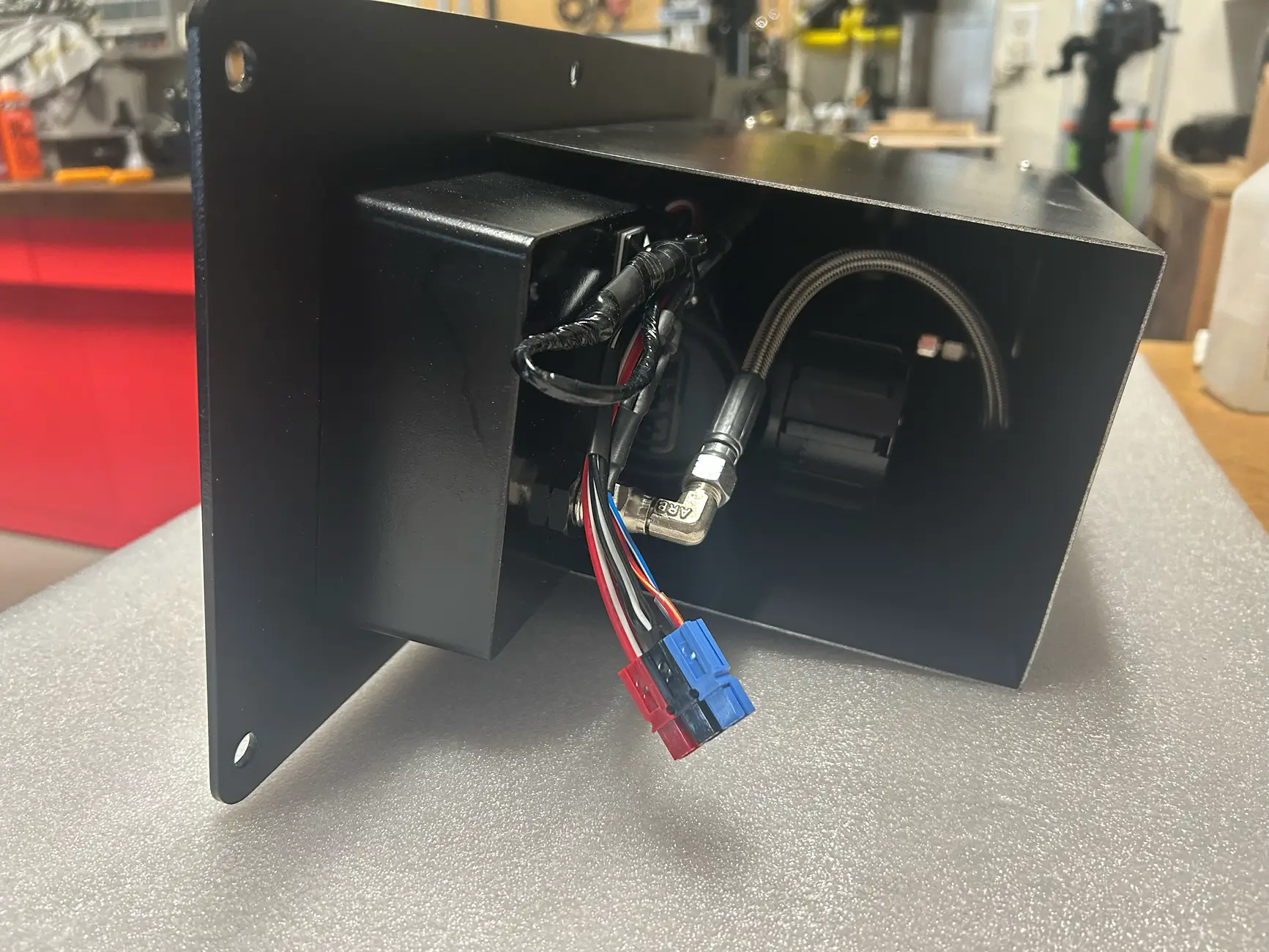

Electrical work
The ARB compressor ships with a nice wiring loom, long enough for an engine bay installation and with connections for air lockers. Since I needed to run power from the engine bay to the rear, I would need to add wire for this and I did not need the locker connections, so I removed these from the loom and terminated the connections I needed to take to the front of the truck with some 75A Anderson connectors which you can see in Figure 4 above - red and black for the power supply and blue for the control line which also needs to be at 12v for the compressor to work. This would be connected to the Aux 3 pigtail I had installed in the engine bay (I did not want to use up the rear aux connection at the rear of the truck for this low power control line).
The ARB brushless single has a 60A fuse and draws 45A when operating, so I pulled an 8 gauge wire for power and a 14 gauge wire for the control line, inside a wire loom plastic tube, along the frame rail and up into the engine bay behind the battery. The control wire then ran across the front of the engine attached to an existing loom across to the aux pigtail by the screen washer bottle. The negative connection was made with a short length of 8 gauge wire to a chassis bolt close to the bed opening where the compressor would be mounted.

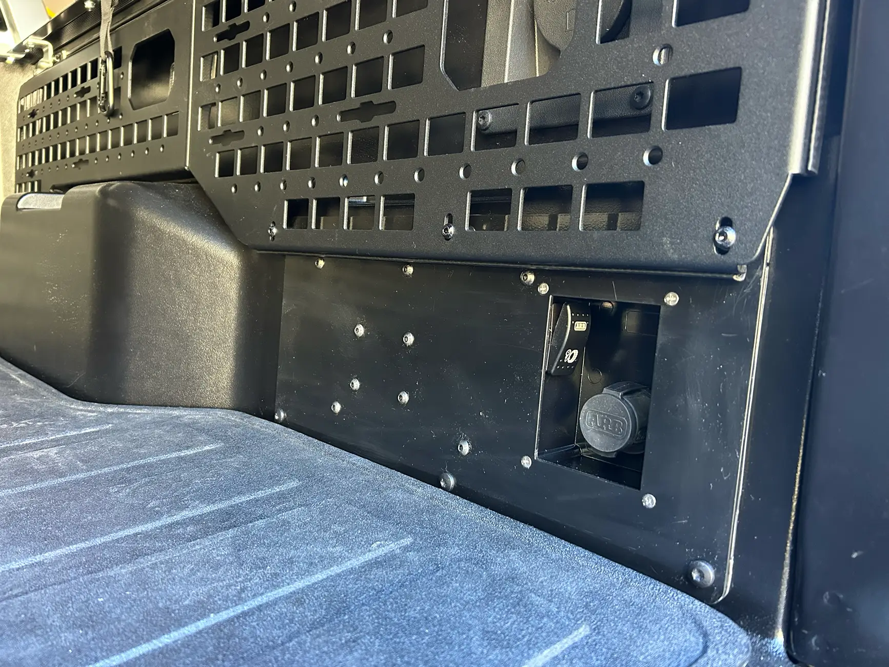

Final install and operation
The compressor assembly was then placed in the bed, the Anderson connectors mated correctly and then carefully inserted into the space between bed liner and rear wing where the storage cubby had been. It was bolted in using the same OE bolts. I also installed some bed side molle panels and the standoffs for this worked as designed with the compressor in place, just replacing the upper three OE bolts.
In addition to the compressor and the items shipped with it, I needed to add the following items to complete the air path: an ARB hose coupling JIC-4 (M) and dust cover, two elbow connectors JIC-4(M) to JIC-4(F), a 0.3M JIC-4(F) reinforced hose.
2024 Tacoma Air Compressor Build - compressor choices and building into TRD OR bed tempImagePw4Fom
To operate, I press the Aux 3 switch, which prevents the compressor being used without cab access and ignition on. Then the compressor turns on with the switch placed next to the air connector. The brushless compressor has a very small built in air tank with a pressure switch, so the compressor pressurizes this to 100psi and then turns off.
I connect a 3/8” dia. air line to the ARB connector and then use an Apex Designs precision tire inflator to set the pressure and also deflate the tires to the desired psi (https://www.apexdesignsusa.com/products/precision-tire-inflator-pti).
Overall I have been happy with the result. It's clean, out of the way and allows deflation or inflation between 35psi and 20psi in 60 seconds per tire. The quality of the ARB items is excellent and they are very good value for money. Speaking of which, total cost ended up being ~$650 for all the parts as I found a sale on the compressor.

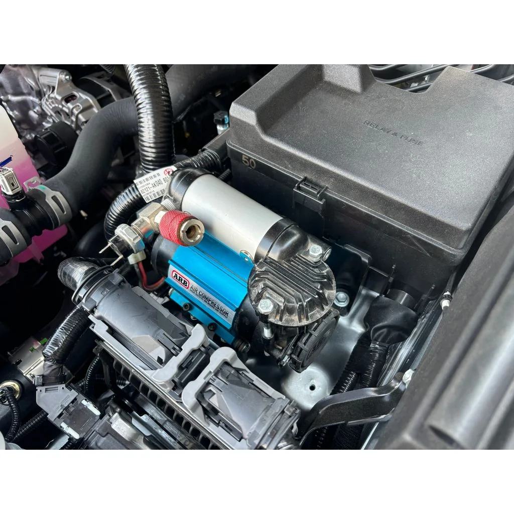

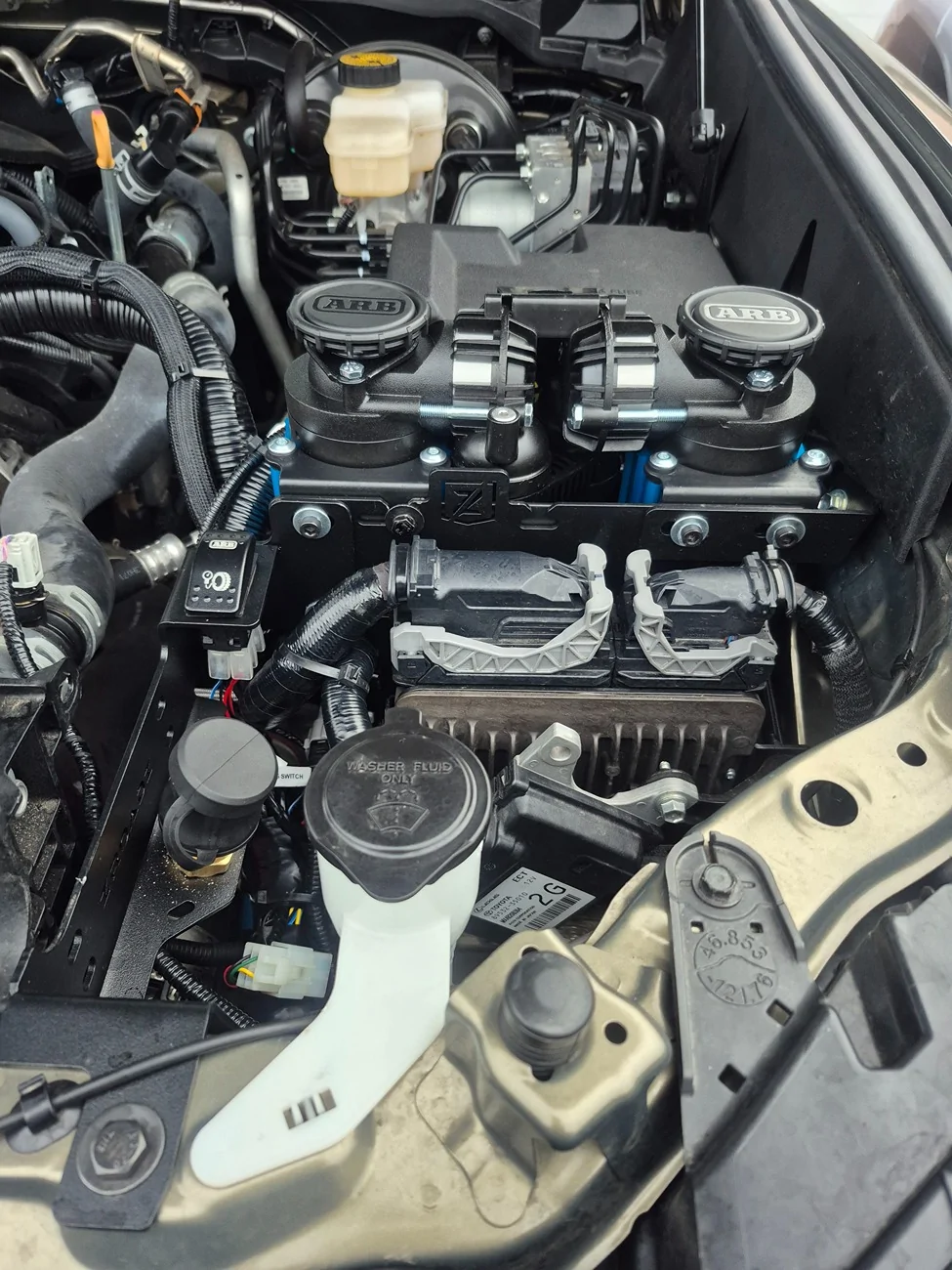

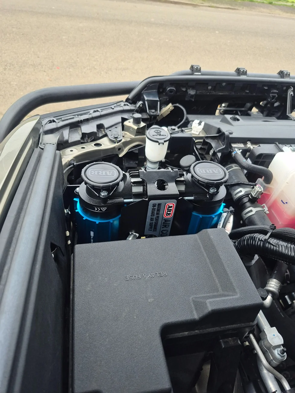

A lot of work when you could have just went this way. Zroadz bracket and a ARB twin fits perfectly.
The flaw with the engine compartment mounted compressors is heat will eventually slay the compressors much earlier than a bed or cabin mounted system.
This is exactly why I wanted to avoid mounting in the engine bay. ARB make solid products, but it gets pretty hot under the hood on a 4th gen, with the high efficiency engine, so finding an alternative mounting location seemed to make sense.
Electrical work
