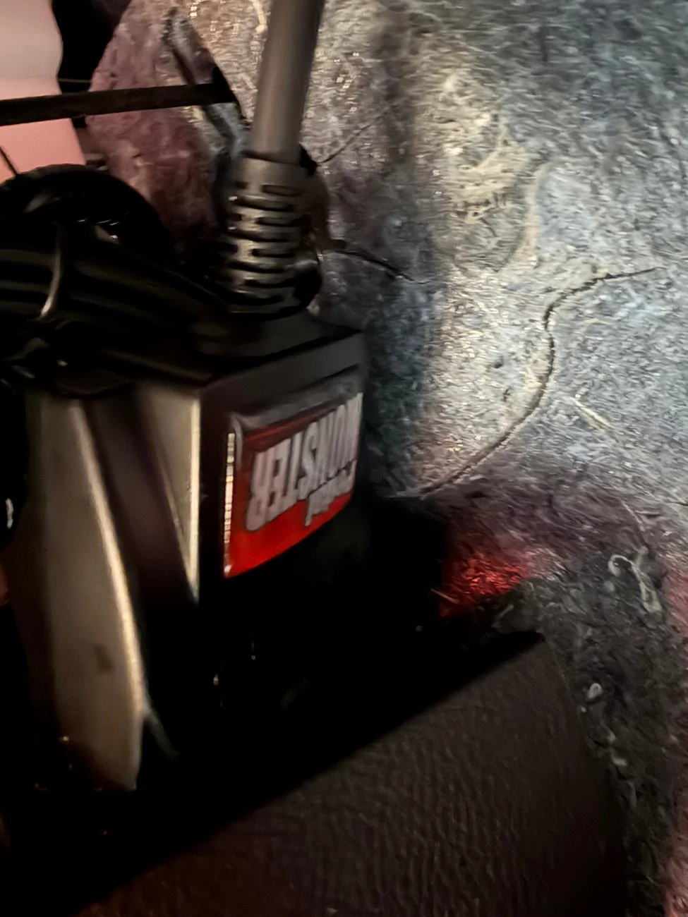

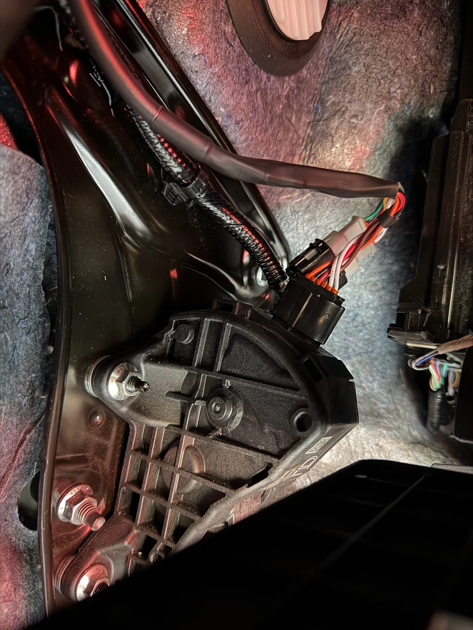

I finally got around to installing the @Banks Power Pedal Monster on my 2024 TRD Sport gas model, and I have to say I’m really impressed with it. I run premium fuel, if that matters to anyone.
For a little background, I’m already running the Banks cold air intake system and the Banks boost tubes, so I was curious to see how the Pedal Monster would change the driving experience.
The install itself was pretty straightforward. The hardest part by far was disconnecting the factory gas pedal harness. I fought with that thing way longer than I’d like to admit because you’re in such an awkward position under the dash. If anyone else gets stuck, the trick is to press the locking tab on the top of the connector. A little stubby flathead screwdriver worked perfectly for me to depress the clip. Once I figured that out, the harness came right off.
After that, the rest of the install took maybe 10 minutes. Plugged everything in, fired the truck up, and there were no check engine lights or warning messages.

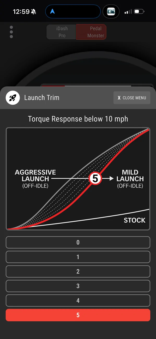

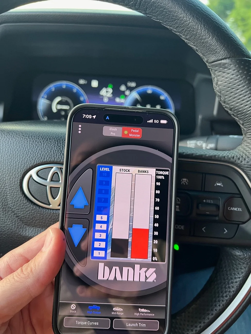

The biggest surprise was pulling away from a green light. I’ve never chirped the tires in this truck before, but it actually did it with the Pedal Monster. That said, if you’re worried about spinning the tires, Banks has a feature called Launch Trim that solves that problem. I played around with it through the app, and it’s a really smart feature. The higher you set Launch Trim, the more it softens the extra throttle sensitivity below about 10 mph. Once you’re moving, you still get the quick throttle response the Pedal Monster is known for. I can definitely see this being useful in the rain, while towing, backing a trailer up a boat ramp, or even off road where smoother throttle control is a big advantage. The first 10 mph keep the throttle stock when Launch Trim is enabled. The higher the Launch Trim setting, the less PedalMonster adds below 10 mph. This is perfect for preventing wheel spin leaving a green light, or when towing… like putting a SeaDoo trailer out of the water at a launch ramp. Note that it doesn’t deaden the pedal… it just withholds PedalMonster’s added sensitivity until you exceed 10 mph. It’s also really handy for off roading. You can literally have torque on demand if you want it, otherwise you can feel the Pedal Monster kick in after 10 MPH.

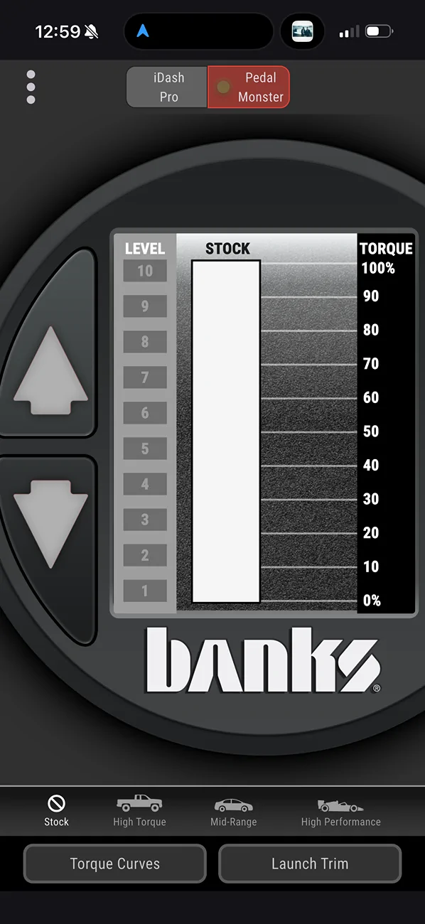

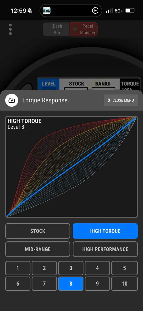

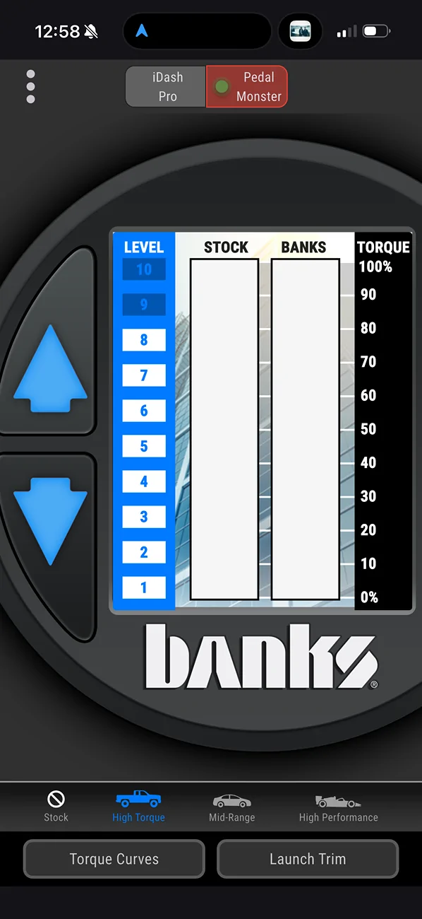

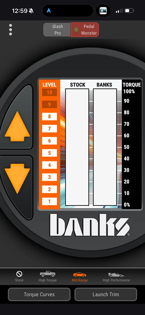

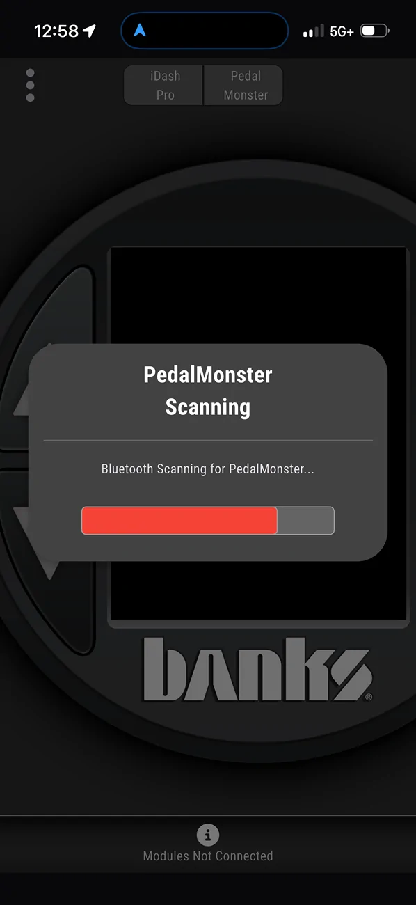

The app is also very easy to use. When you first install, it connects to the Pedal Monster and walks you through each step. Less than 5 minutes (and an update later), the Pedal Monster was good to go. You can hear the Pedal Monster ‘click’ when you change it from stock to the three different modes: Hi-Torque, Mid-Range, and High Performance. Best part is, you can literally turn it on and off with an app click. The app is very responsive, and has connected every time I have opened it. It’s only been installed a few days, but from what I have seen, it’s a solid app with a solid connection that I don’t think will give you any problems.

Here are some screen shots from the app. Let me know if you have any questions or want me to try anything specific out!

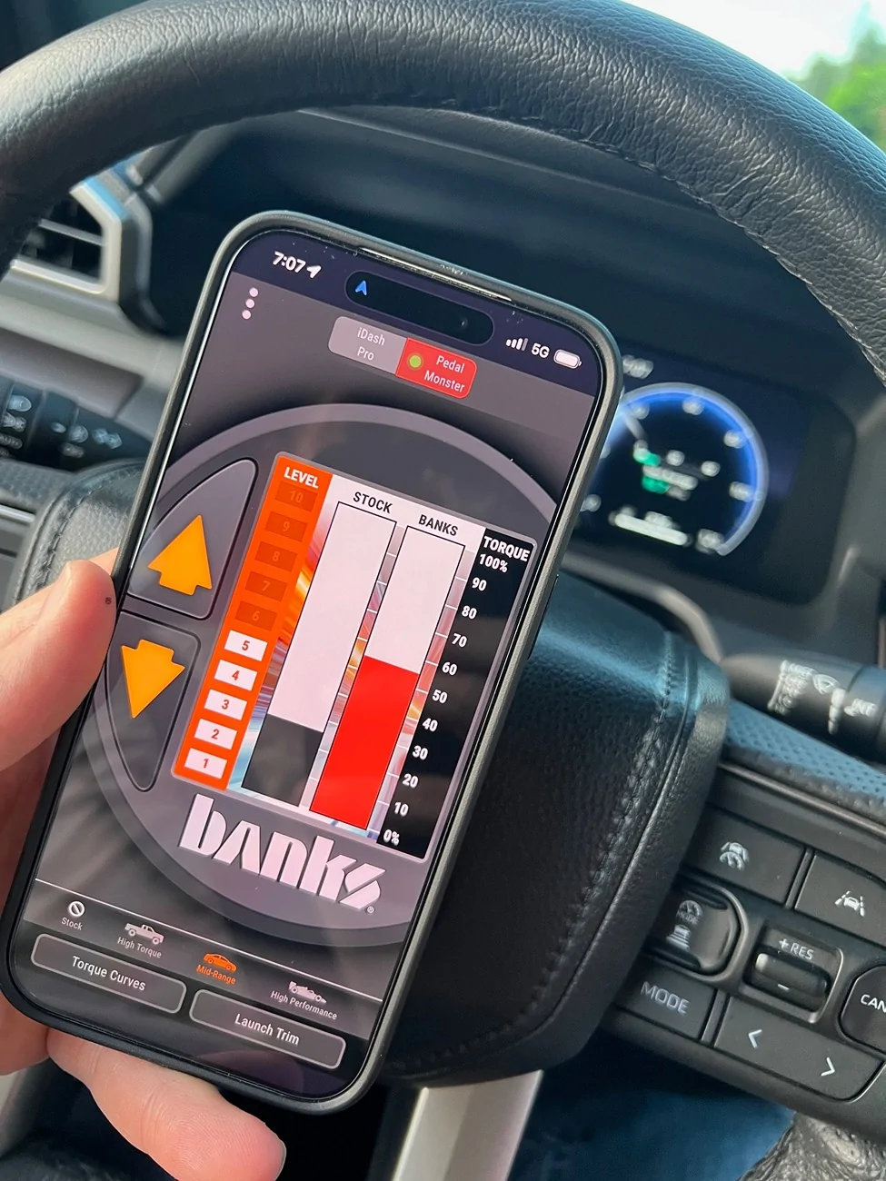

Here is what the app looks like. So easy and super responsive to use.
