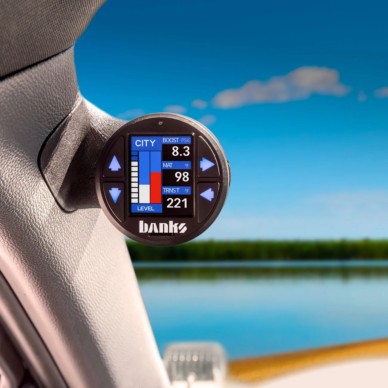

Another option is to add a Banks iDash. This will allow you to adjust PedalMonster on-the-fly, as well as monitor and log all parameters. It's quickly becoming the gauge of choice among 4th Gen owners and not surprisingly, tuners too.
