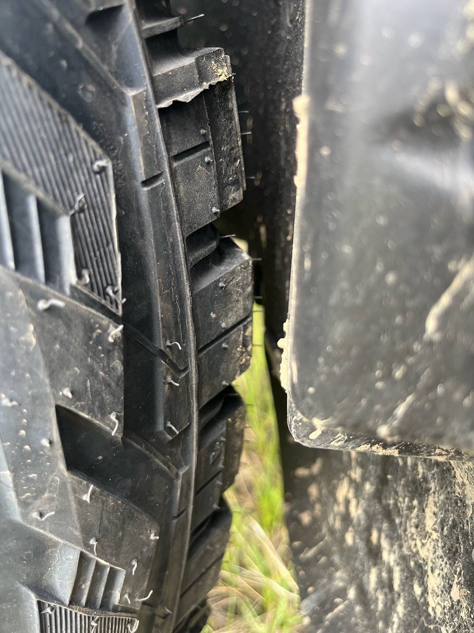

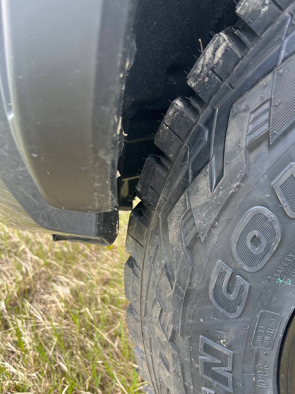

Here’s mine, 17x8 +20 wheel with 285/70R17 Toyo R/T which says 33.0” diameter on the spec sheet. Likely the same as your Falkens. Stock suspension. Running about 32-35psi and been happy with the ride.
Small lift will be going on when those wheels go back on in the spring.

Those are great photos thank you. They really show that I’m not too far off with how mine are set up. I really appreciate it. I felt like there was something wrong with my Tacoma because everyone else sounded like they had 6 inches on either side.

Yeah there’s not an abundance of space, but I’ve flexed it out pretty good off-road and have never had a rub.
