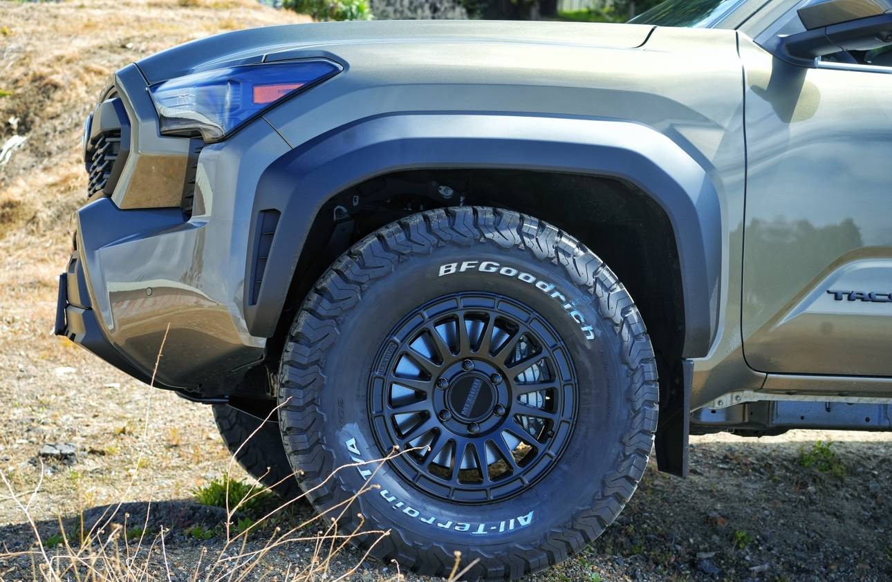

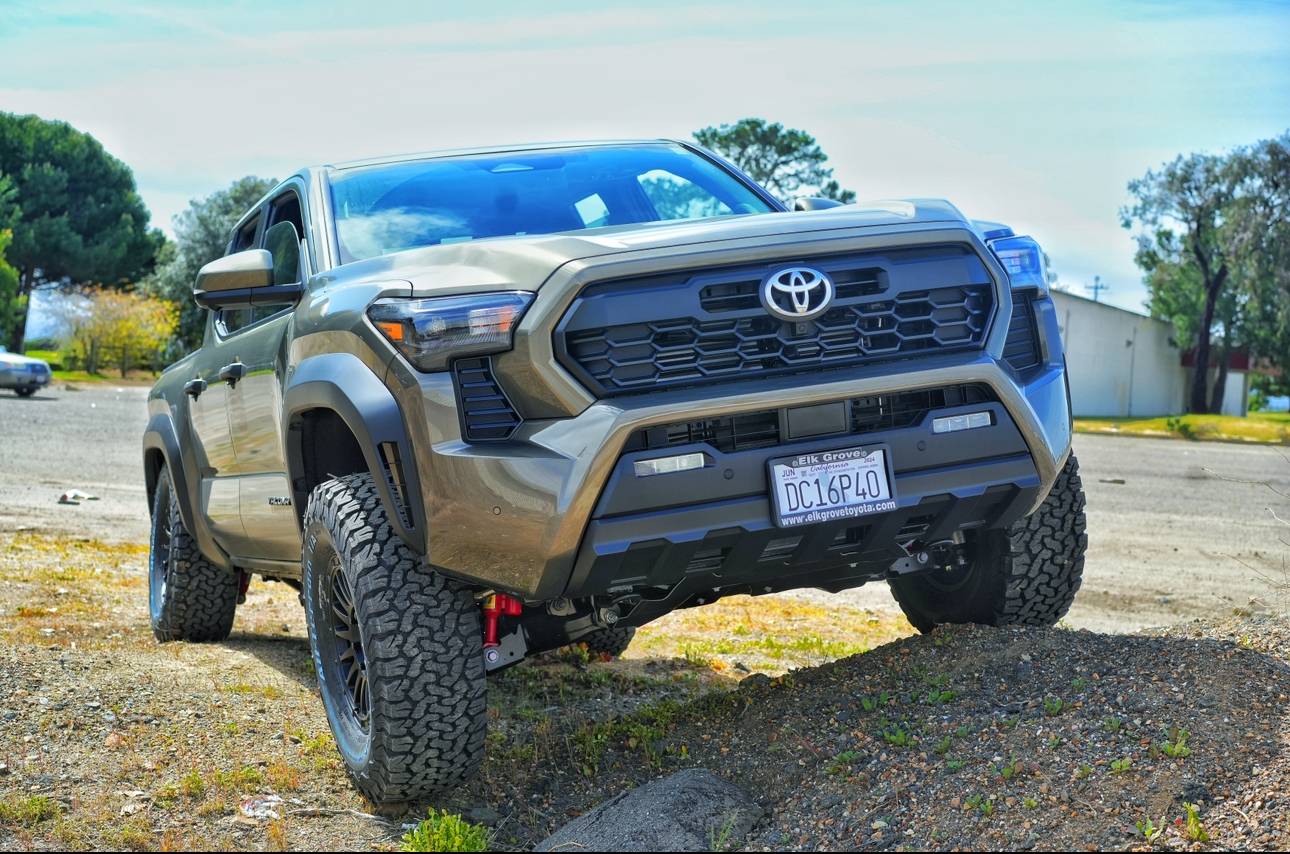

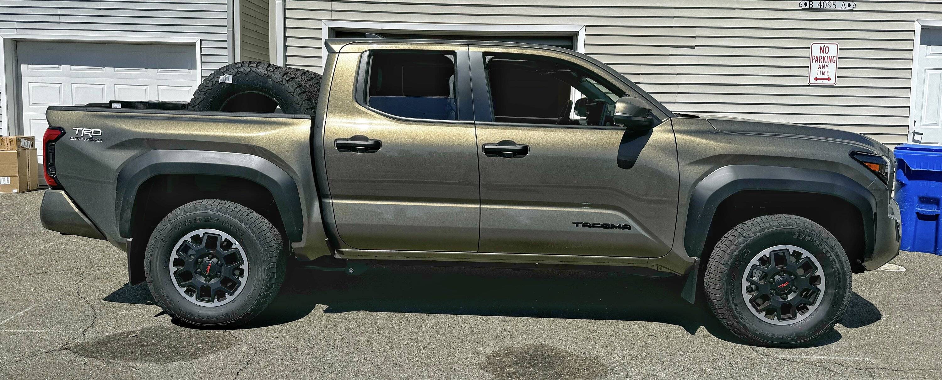

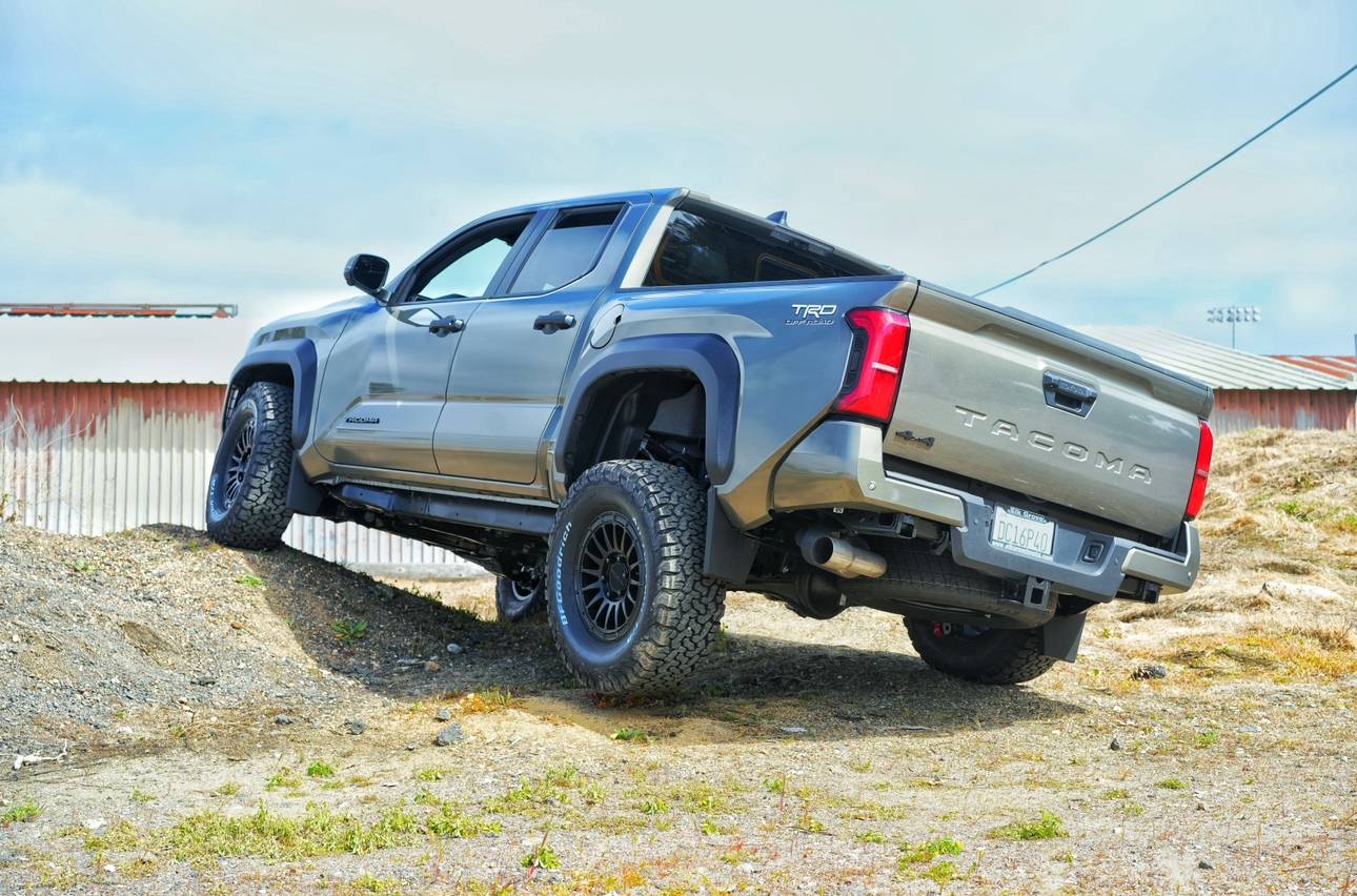

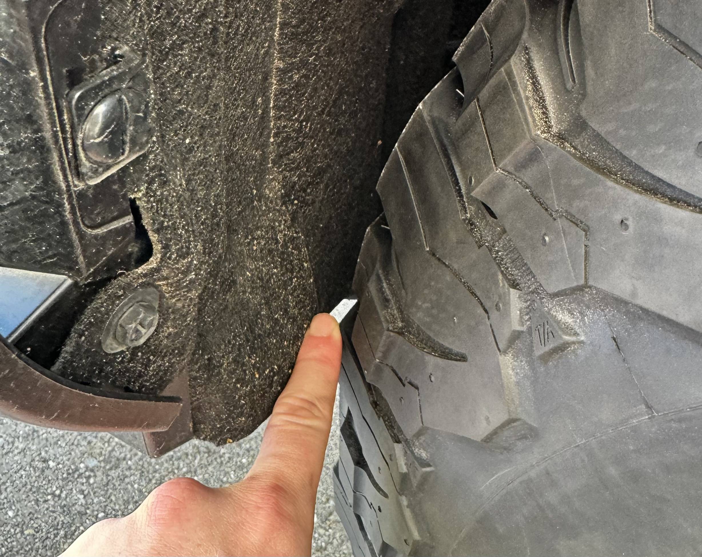

Just installed these 295/70R17 (33.3”) on 17” Method 314 (+25 offset) on my TRD OR with stock suspension and there’s no rubbing! I haven’t fully flexed everything out, but it all looks like it’ll fit when stuffed. Also didn’t have any rubbing when turning into my driveway at full lock. I’ll be updating once I get it on some ramps in this post and on my IG below.

That looks really good. I was actually contemplating this size as well with that same offset. I do plan on off-roading and that looks really close to the fender wells. Might be better with a level?

To me, the +25 offset is the sweet spot. I like the wider stance but not a fan of a lot of poke. Your truck looks great!

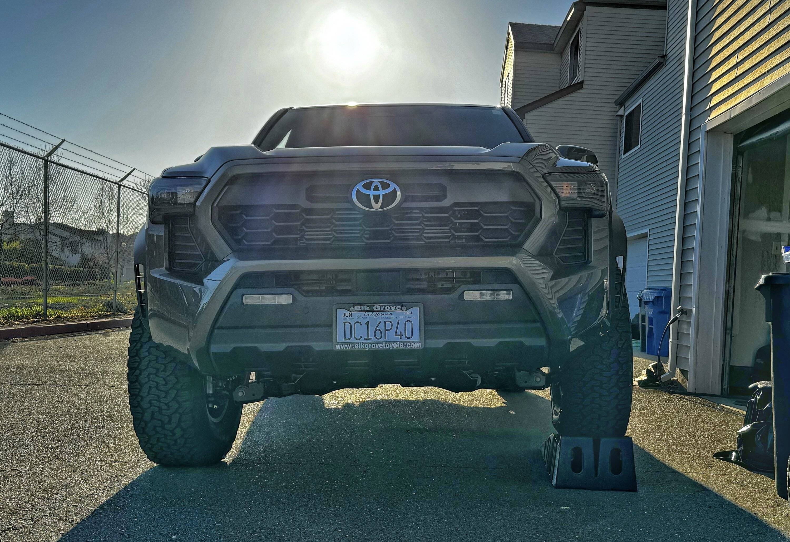

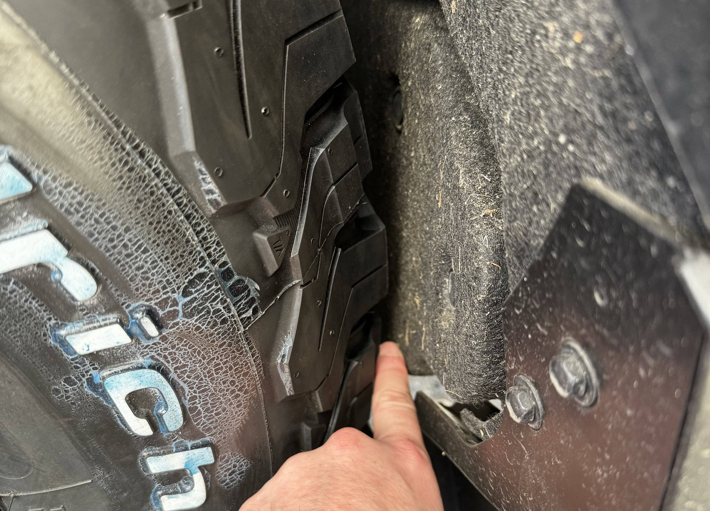

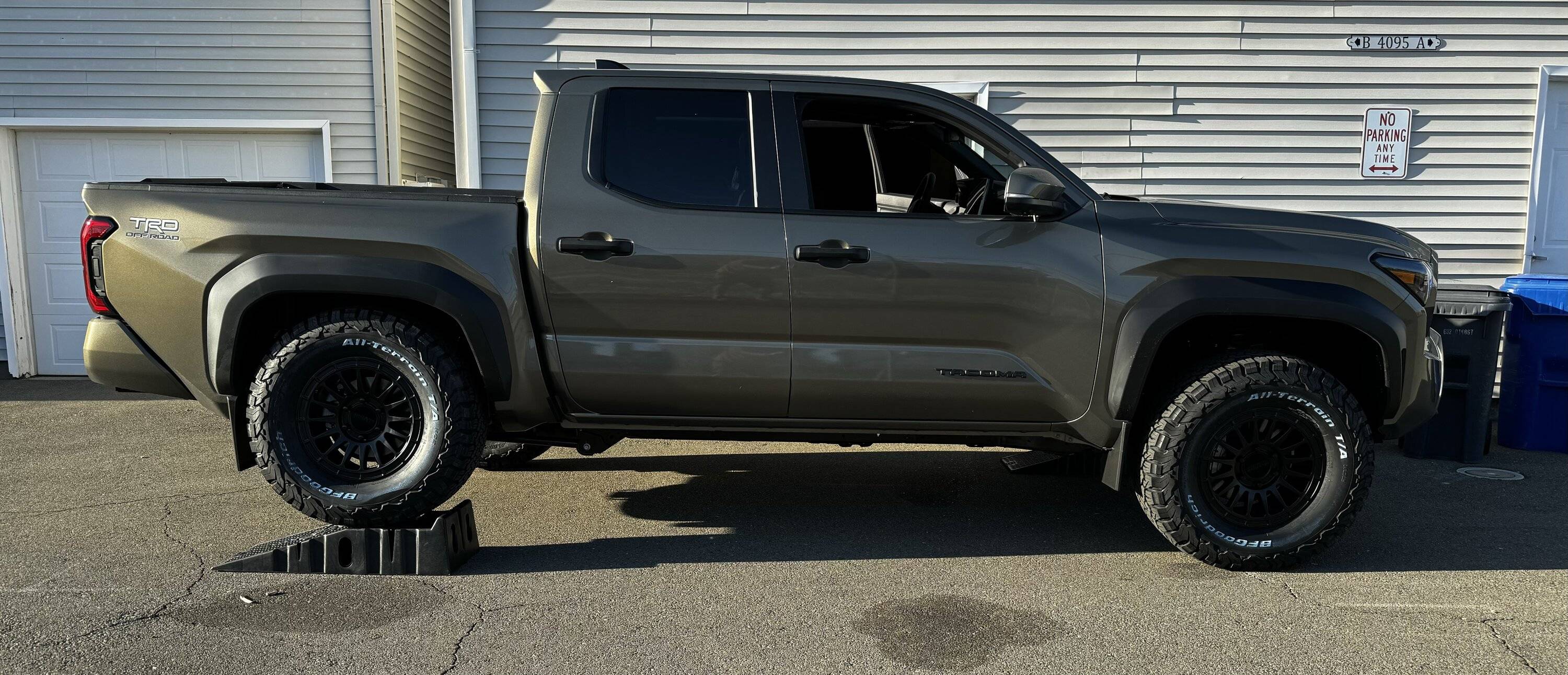

It’d likely be better, yes
2024 Tacoma TRD Off-Road stock suspension with 295/70R17 (33.3”) on 17” Method 314 (+25 offset), No rubbing! IMG_0282
2024 Tacoma TRD Off-Road stock suspension with 295/70R17 (33.3”) on 17” Method 314 (+25 offset), No rubbing! IMG_0272
, but I just put an 8” ramp on both the front driver and rear passenger sides of the truck, getting it pretty decently stuffed, and I still couldn’t see any spots where it was/would rub. Maybe at that kind of stuff if you turned too much in one direction you’d touch some of the liner, but that’s really all I can see happening with this setup.
