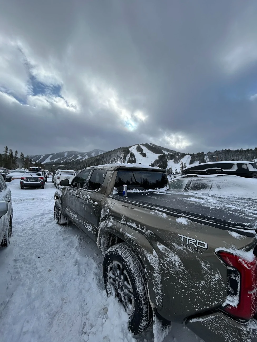

Thank you all for the help. Without response I would’ve been dead in water but I confidently switched from 2H to 4H. Cornered turns, hit switchbacks and tackled the harsh snow and winter conditions that had multiple cars in snow. Everything went great except my new winter tire blew up in Broomfield :/ Oh well
