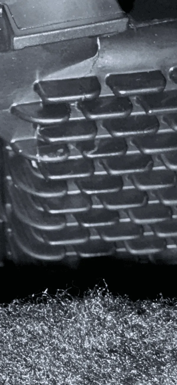

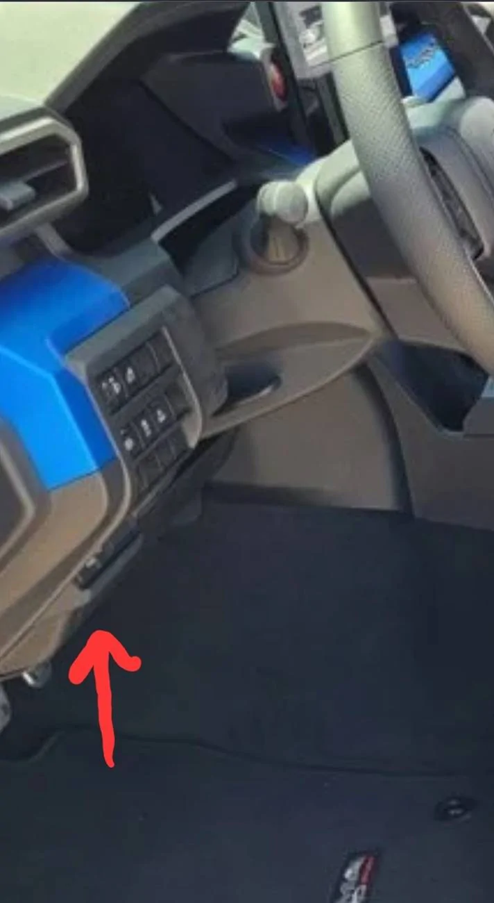

If this is the same issue the rest of us are having look up under dash with your phone camera to the right of the gas peddle and take a photo (1st photo). If you see a crack on the piece that has the fins on it like in the photo then yes it is probably the same issue. (2nd photo)
Deleted User 1813921
Guest
Went to dealership for appointment about drips by gas pedal. No cracks! no clogging or pinching in vent tube. Toyota opened a case and it has been documented. I am so happy and relieved. I feel like I dodged a bullet.

I have 2024 Tacoma Sport Premium Package. I’ve been feeling water dripping for a while now but didn’t think much of it until I decided to look it up today and found out this is the issue. I attached a photo of mine and it definitely looks to be the same issue. I called my sales person and she said the service department will be calling me soon. 2 hours and still waiting.
2,365
3,061
Yeah - yours won't be the first that Toyota had to replace for that problem. It takes a lot of time to R&R that and it must be costing them a pretty penny for something that is most likely sloppy assembly.
