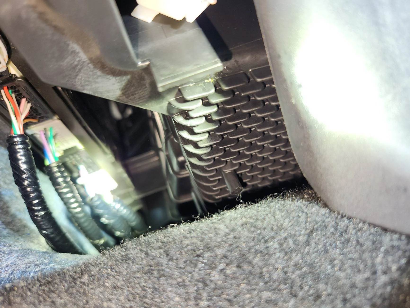

I was driving around for hundreds of miles when I first got my truck and had ac on and when it got dark I opened windows and kept ac on. I felt a few drips. I discovered the issue here and looked up under there and could see no crack and 800 more miles could not replicate the drip. At my appointment at dealership they seemed to remember an issue on 3rd Gen but I must have been first Tacoma owner to report drips in 4th Gen. After calling Toyota and hearing my experience the technician deemed it condensation and to monitor for another occurrence. If you are getting a new Tacoma get your back on the floor mat and use a flashlight and look up under there and also request a ac drip check before you take possession of truck. hopefully it will help a new owner.

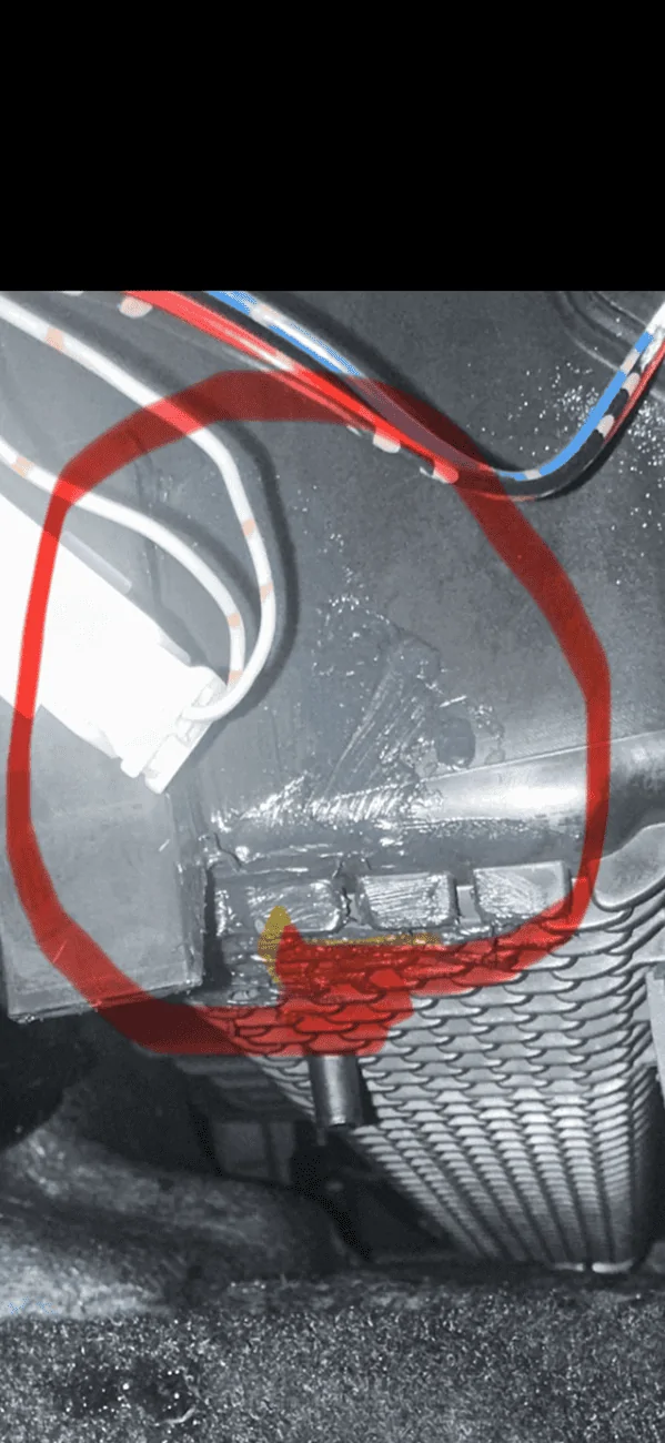

Looking for suggestions, I took my truck back to the dealership on Tuesday with this same issue, which I bought new about 3 weeks ago, they told me they found a loose hose and reconnected it, the next day I have the same water leak so I decide to remove a panel and look for myself, what they really had done was put sealant on the cracked ac box hoping that would fix it, needless to say I was beyond pissed. I took the truck back with pictures that I took of their repair job along with copies of this thread because I had read this before I even took the truck back the first time, I asked for the service manager but he was to busy to see me, so one of his sidekicks come out to assist me, after showing him the pictures of their shady ass work, I’ve never heard so many apologies in my life so to make a long story short, my truck is at the dealership with no ETA on parts to fix it. Just looking for ideas on how to handle this situation.. Thanks for reading and for any suggestions.
