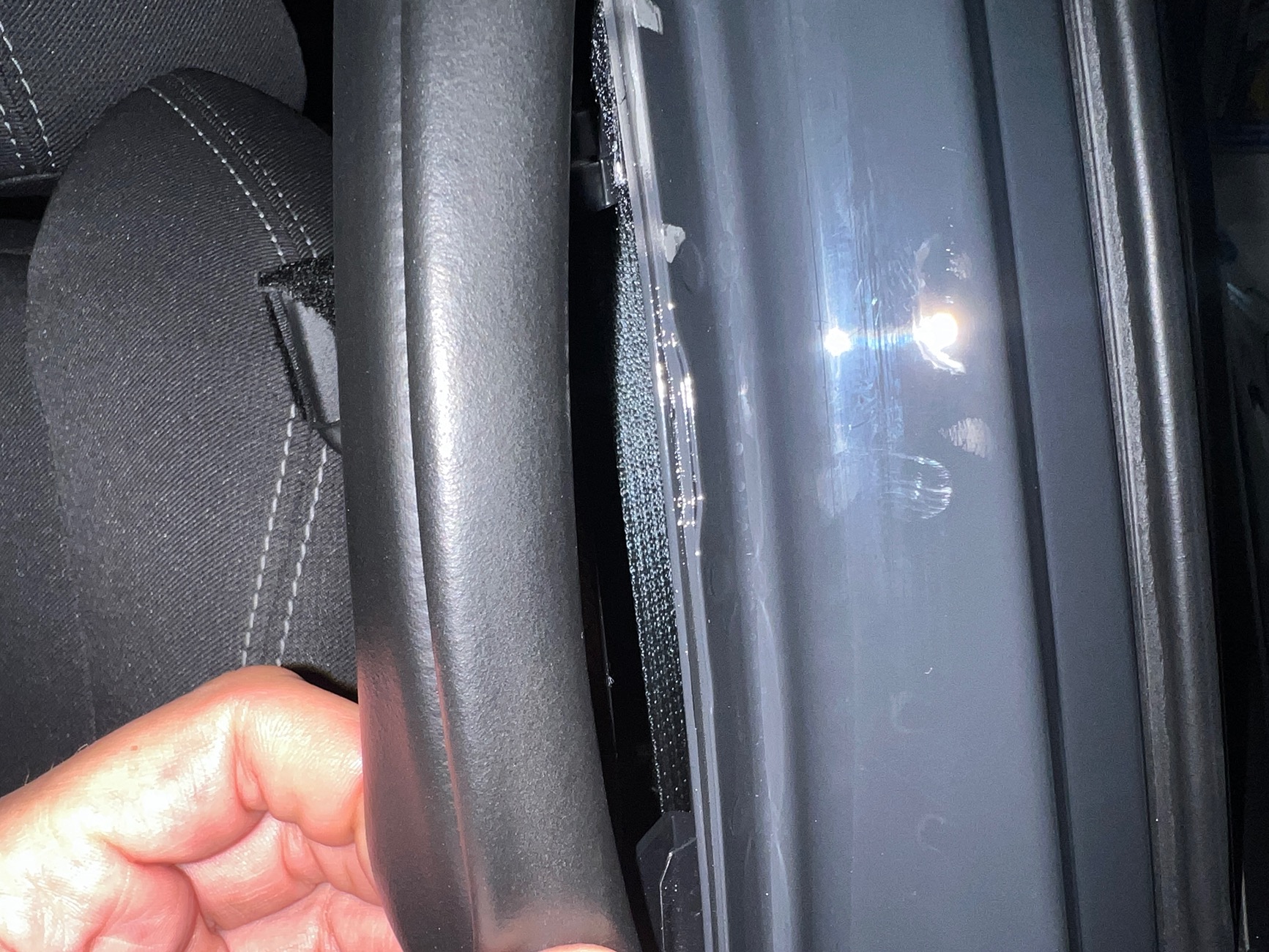

Sure. Will snap a picture tomorrow after work. I actually took the folded business cards out and replaced it with the soft side of sticky Velcro. Velcro’d (if that’s a word) the sticky side on the plastic clip so the padded side would be touching the metal body of the truck in the driver side b pillar. Was silent on the way home with the paper shimmed behind the clip, so I imagine the Velcro will work as well. And will stay in place. Will follow tomorrow 👍

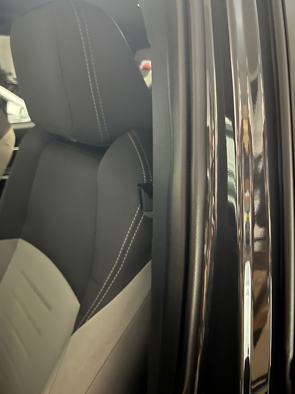

I didn’t see anywhere easy way to access that black piece to be able to remove it. Any tips
It pulls straight out towards the windshield. It’s on there pretty tight. Jus snapped some pics for ya.

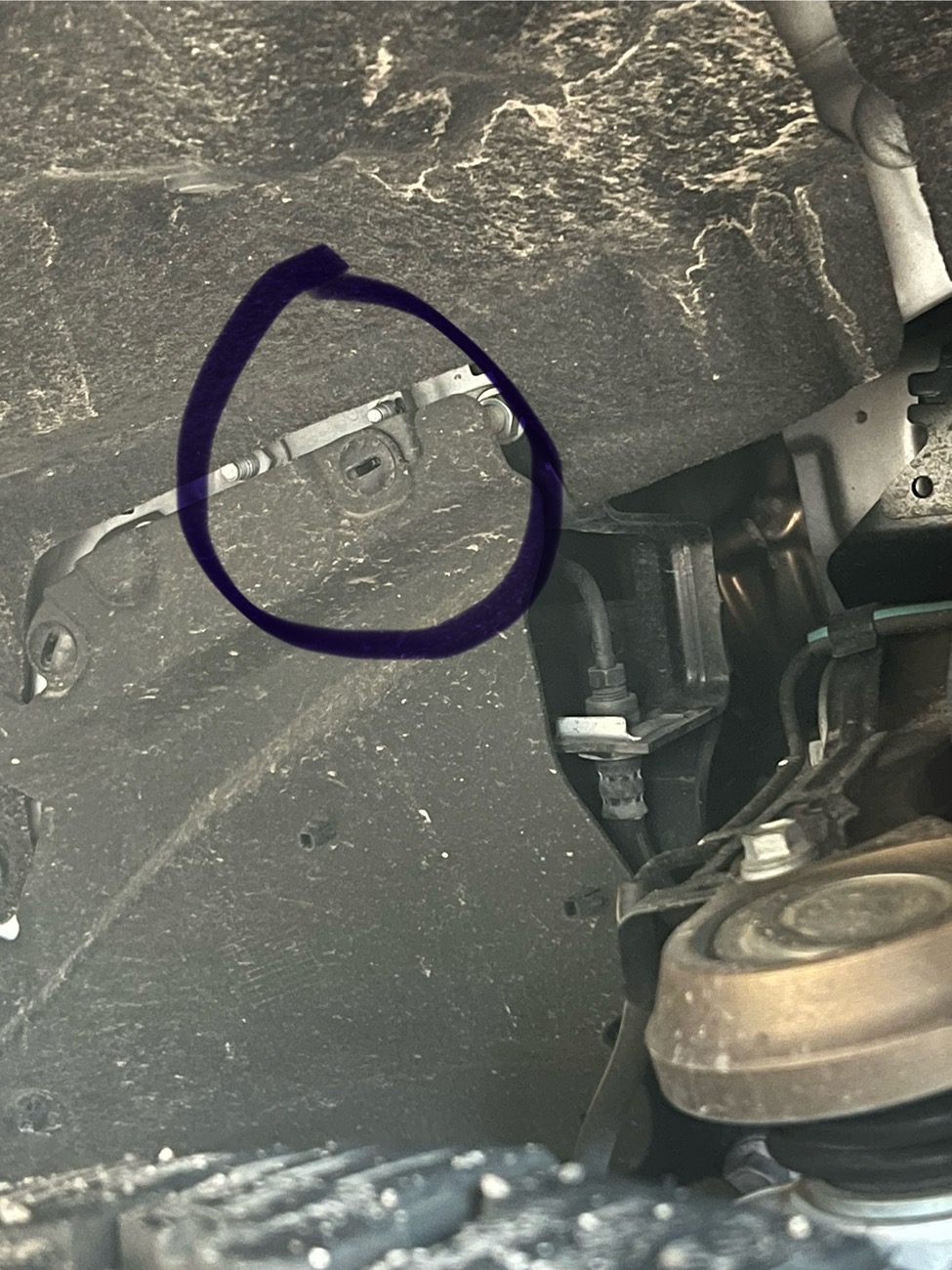

Looks like resolution was already reached and it was a different rattle - here’s where mine was (clip came undone - probably from power wash)
The air flow would cause this to flap and tap - I secured it and all solved
