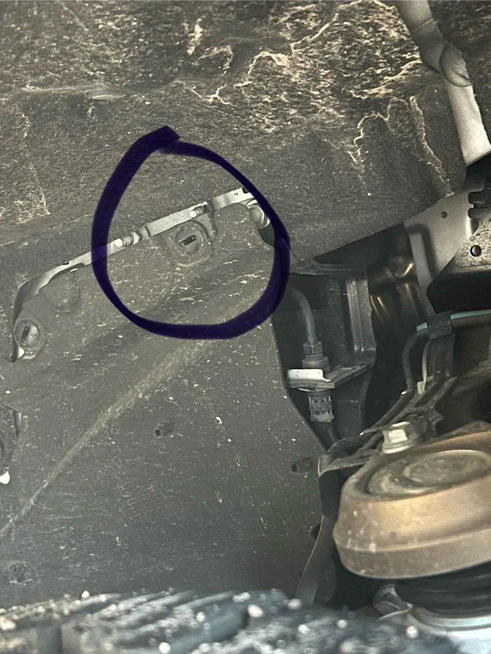

Looks like resolution was already reached and it was a different rattle - here’s where mine was (clip came undone - probably from power wash)
The air flow would cause this to flap and tap - I secured it and all solved
think this is the same on my truck, how’d you end up securing it?
holy shit.. you just saved me a lot of stress.. came here to search and this is exactly where mine came from. Secured it and finally driving with a big smile.. thanks taco team!!
