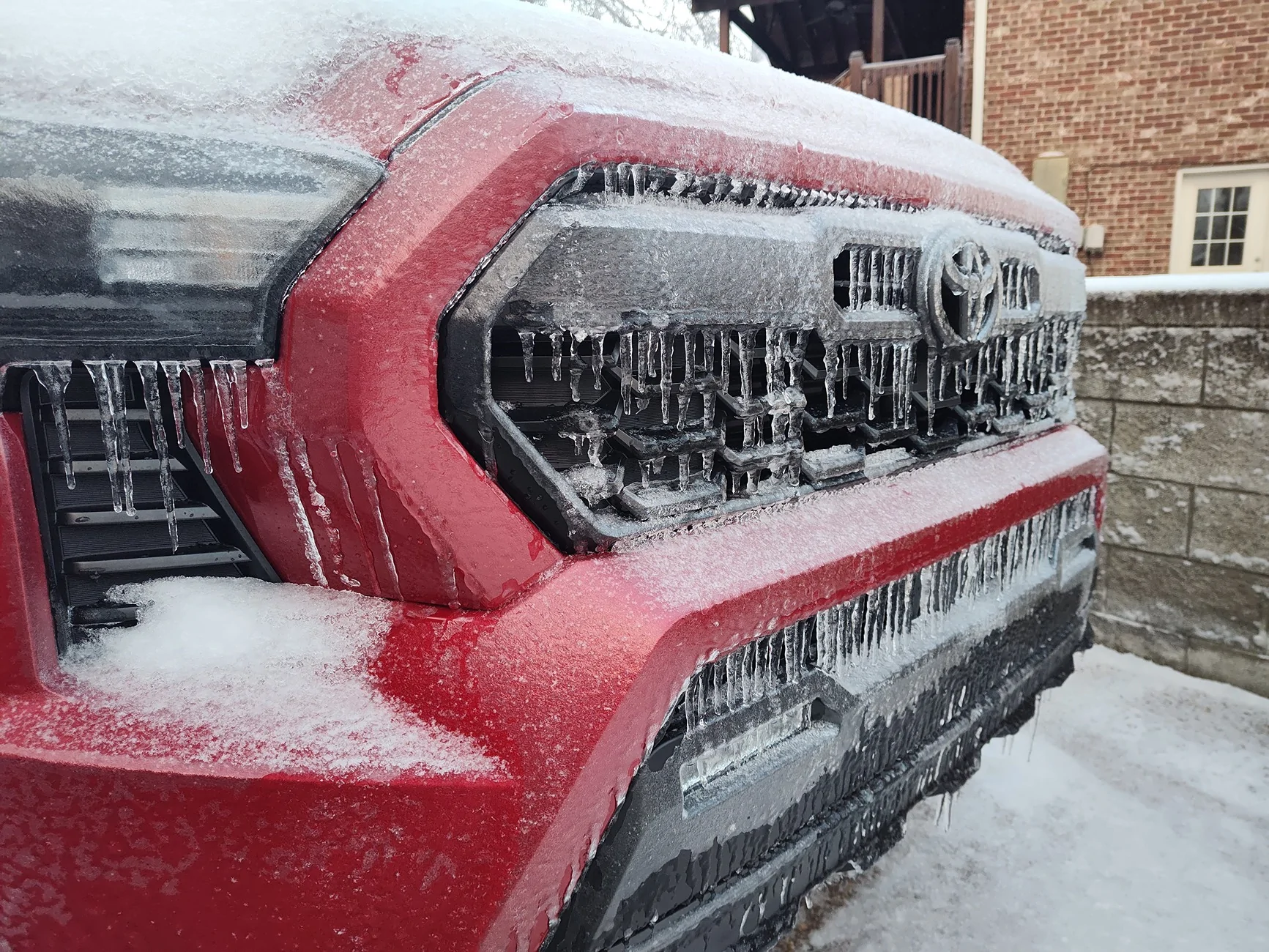

Here's my truck during the recent ice storm...not sure how much I cleaned off but the sensor seemed to function OK.
