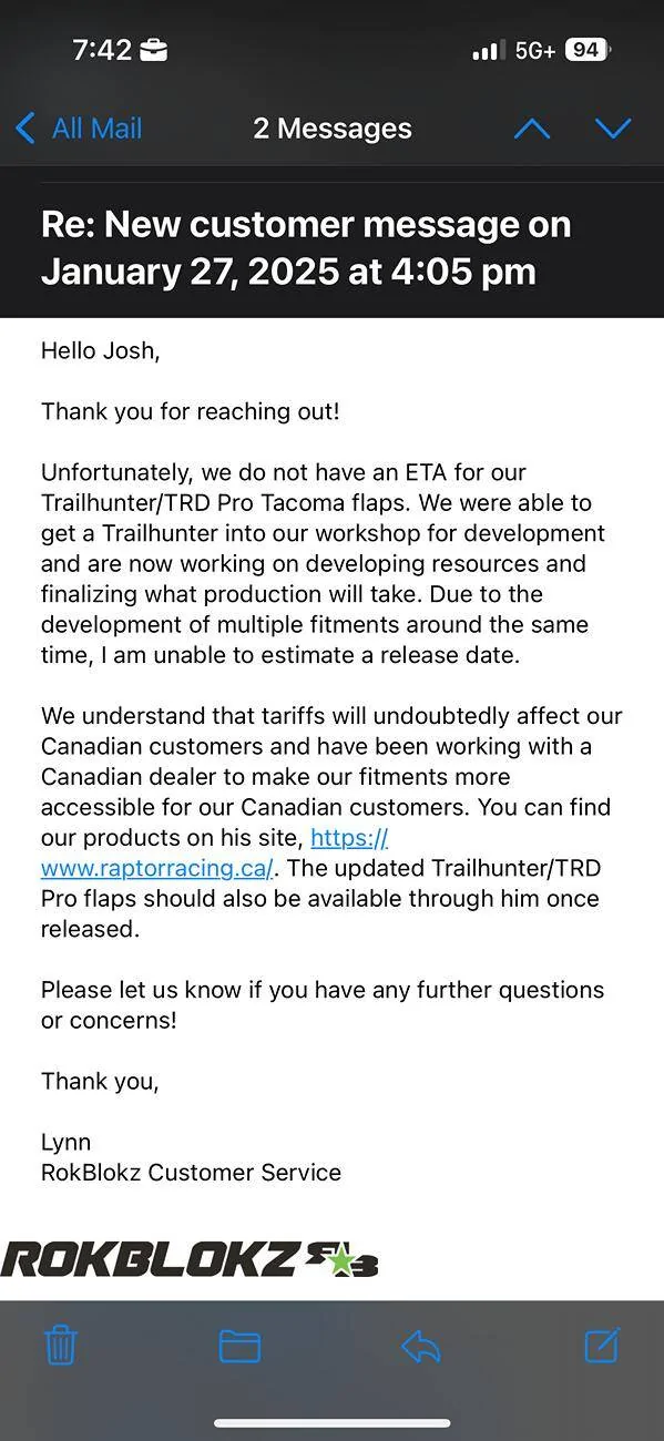

Those look like the rally series but good to see they have something coming

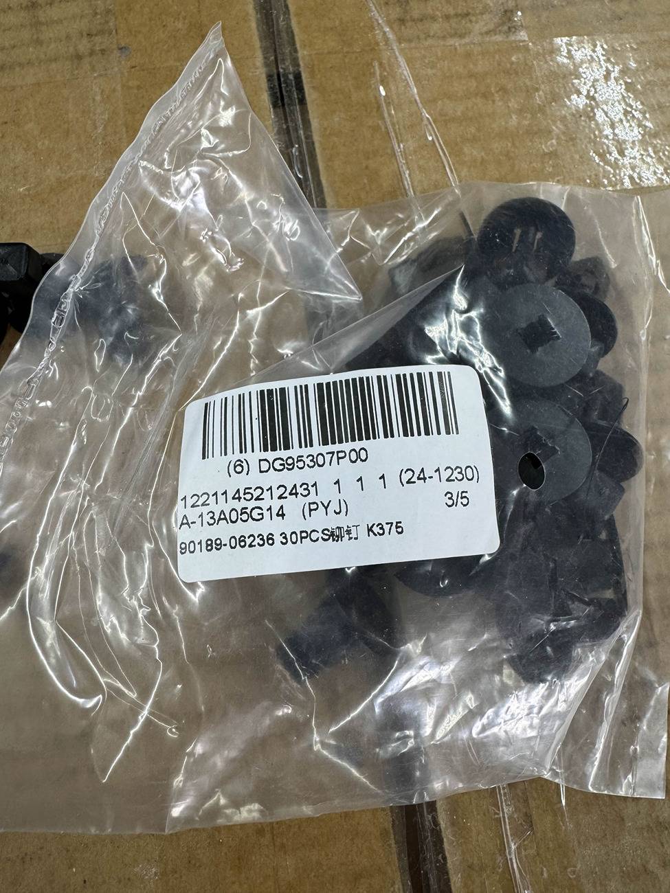

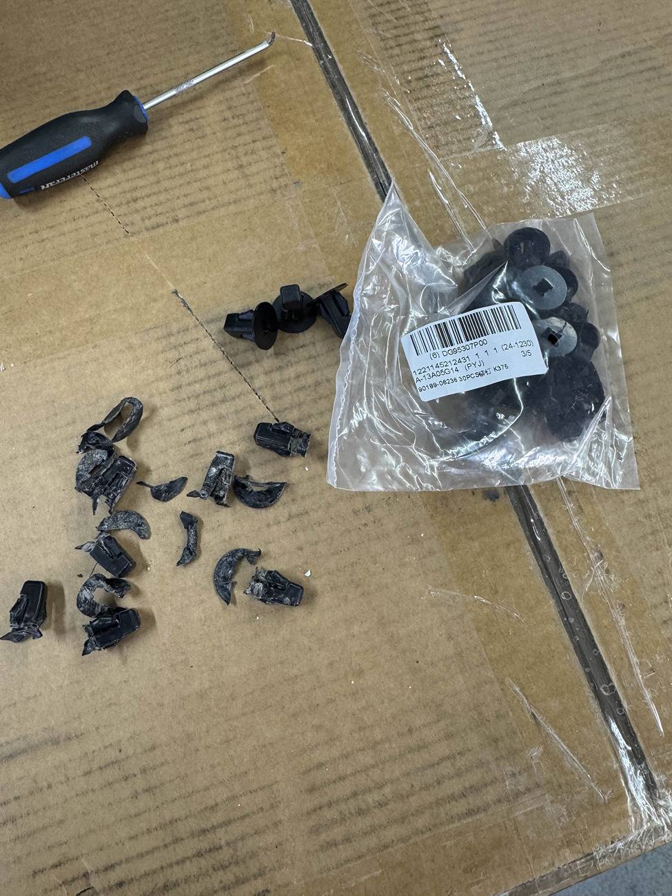

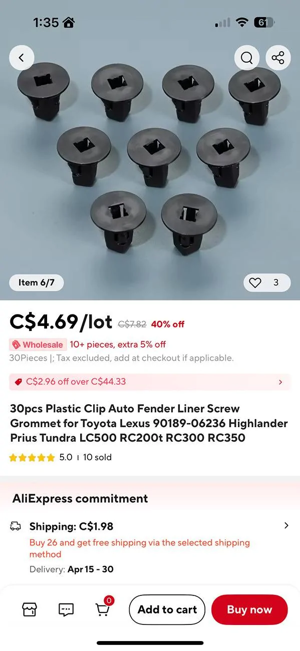

In case anybody else destroyed the screw grommets installing the wrong mudflaps on their truck this only applies to the TRD pro and TH I'll assume these are the direct replacements from AliExpress. You have more than enough room to add longer versions of this clip but these are the OEM sizeDoes anybody have the part number for the bolt clips that hold the mudflaps on? I smoked about every one of mine installing the Rokbloks hardware

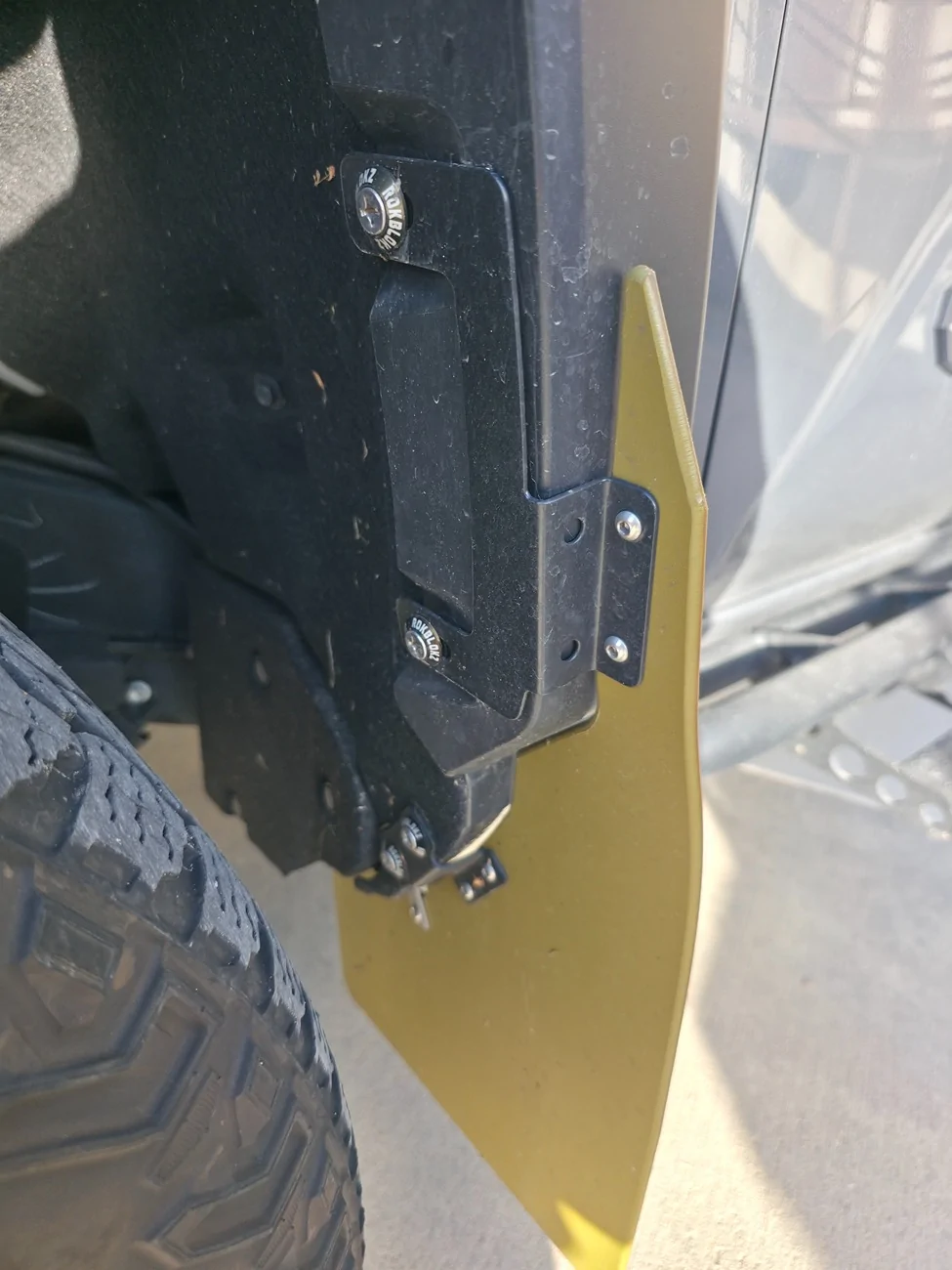

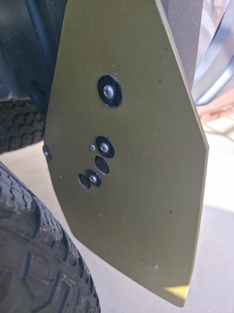

Good on you for going with the high clearance, I love how theyre larger / wider & gives protection on the sides....I give you the RokBlokz high clearance mud flaps, and I'm highly impressed with the look and quality! I was told that it'll be 2-4 weeks for them to be available to purchase, but that it may be sooner since its pretty similar to the other trims.
Screws are not black, but have a black washer.. the front flaps do not come in contact with the fender.. yes they are flexible.. yes all original holes are utilized.Nice flex on the color.
Few questions. Are the screws stainless or black? Some pics show stainless others show black. I prefer black. Does the high clearance part hit the truck's metal? Do they flex off road? Do they use all the original bolts holes of the truck?
