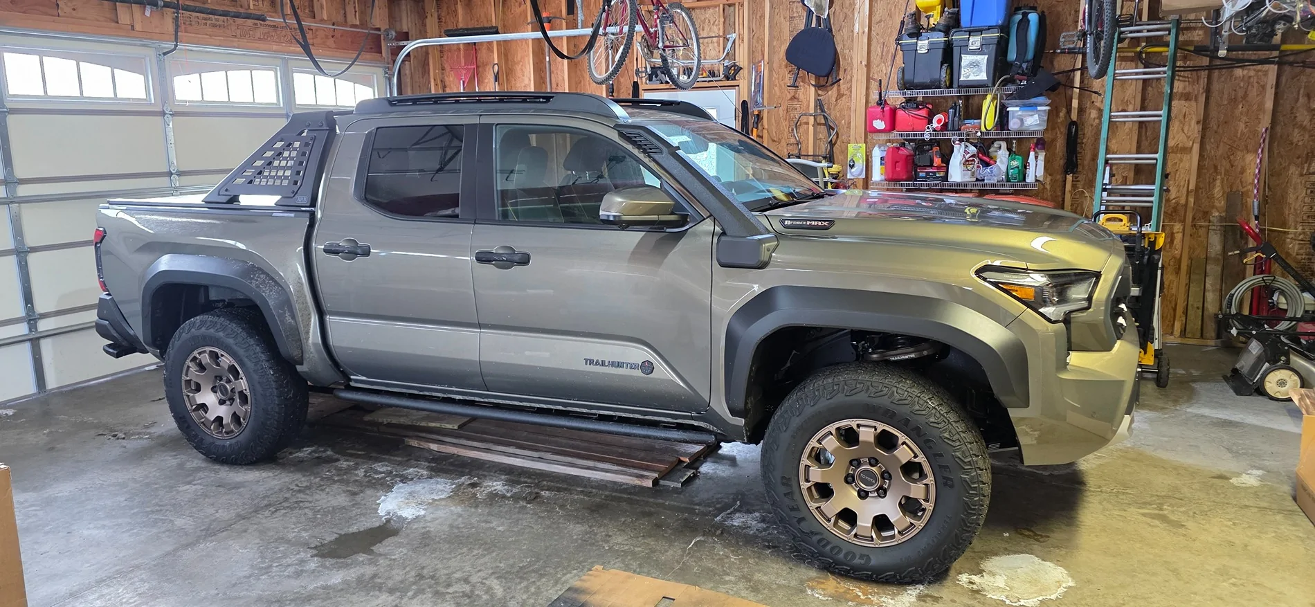

I ended up getting a year end 2025 Bronze Oxide Trailhunter with the 5 foot bed. $4000 off TSRP, seemed like a good deal to me. I plan to do this same exact mod to the ARB rack with the Retrax Pro RX tonneau cover. I am hoping my angle grinder skills are up to the task. I am assuming that is the tool of choice for cutting the metal and then grinding it down.
You are correct. I used a grinder with a wheel for metal cutting, then a grinding wheel to shape it out and finally a wheel for sanding/polishing to make it smooth.

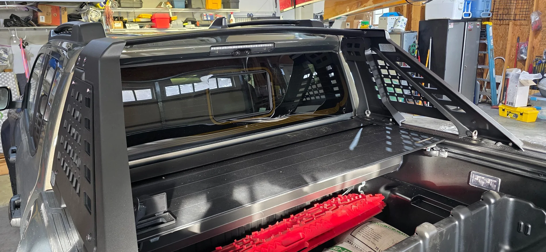

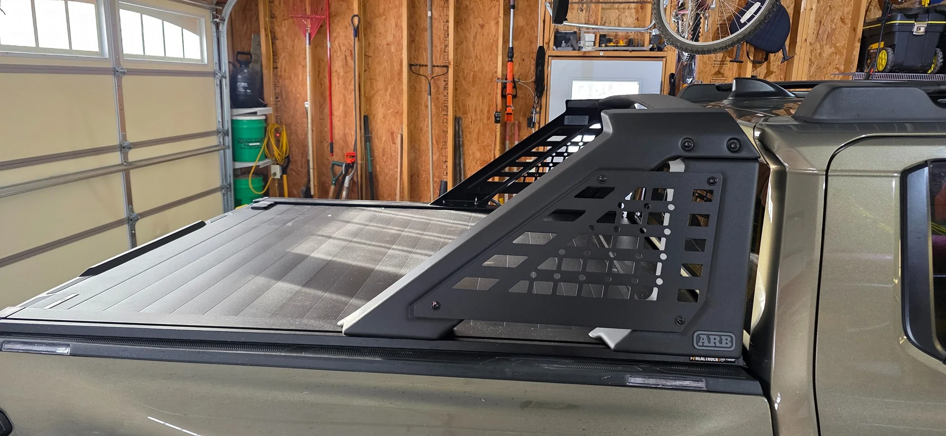

I started my project today. I got the retrax pro xr on and cut the ARB tabs off. I started to grind them flat but it was taking longer than I expected so I called it good for the day. I still need to get the t slot bolts so I have some time. Should have it done soon. Can't wait.

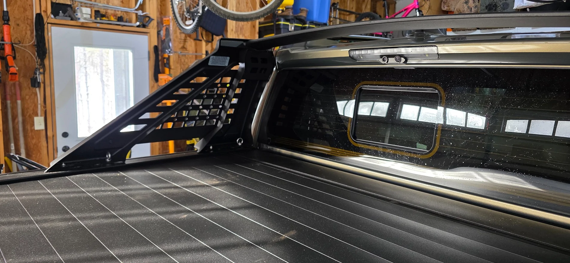

It wasn't terrible. But there were plenty of things to mess up if not paying attention.
I ended up using some scrap foam that fit the track width and had a sticky side. Put that in the track and then the ARB on top to position it. Then lifted the foam in the tslot to stick to the metal bottom of the ARB base plate. Then I knew where to drill the holes for using the tslot bolts.
I also had to use a ratchet strap to put tension on the lower portion of the ARB frame to make the part closest to the cab fit the retrax shelf a little better.
Luckily, in this case things went pretty well and it looks great.

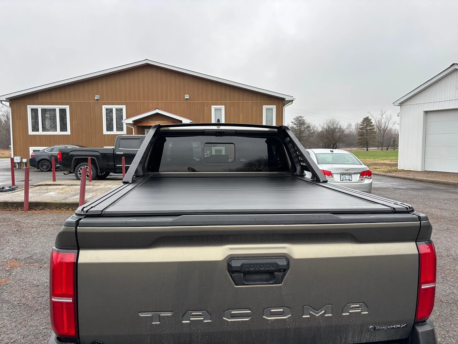

Hey Hatman, thanks for the inspiration! Before buying my Trailhunter last Nov I went looking for options for tonneau covers for them and found your post. I finally got mine installed last week! Thanks again…
2024 Tacoma ARB Sport Bar + tonneau cover combination -- how to have both (my solution) IMG_2743
That looks great!! I like the dual channels on the cover. Which one is that?
