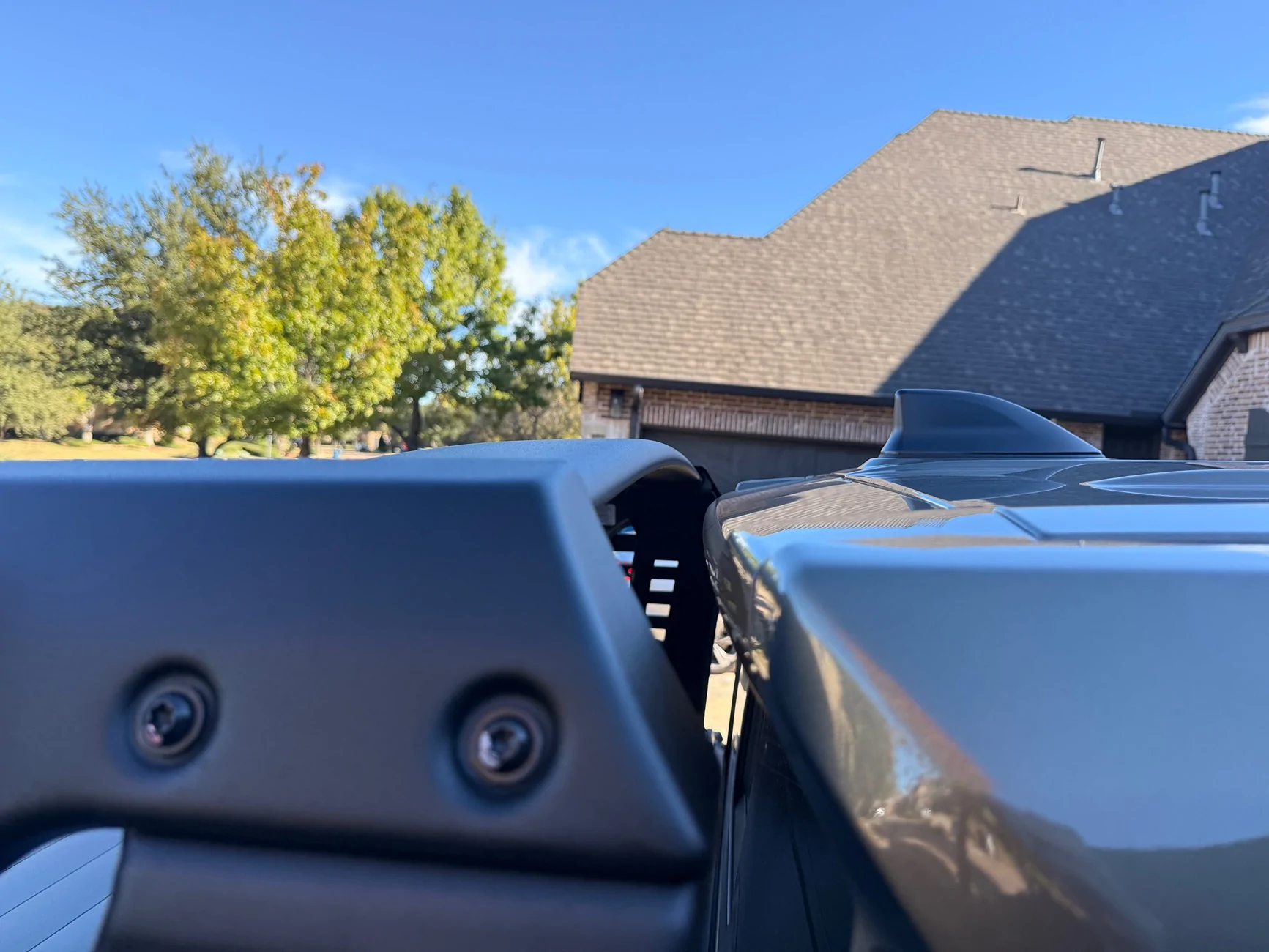

Did you notice any change in wind noise with the 3/4" additional height gain on the roll bar? Thanks!
I drove it before and after with the back window open and there is no difference in wind noise. You can compare this photo to your setup and I think it actually raises just enough to make it more streamlined, so the air flows under the front edge of the bar rather than into it?
