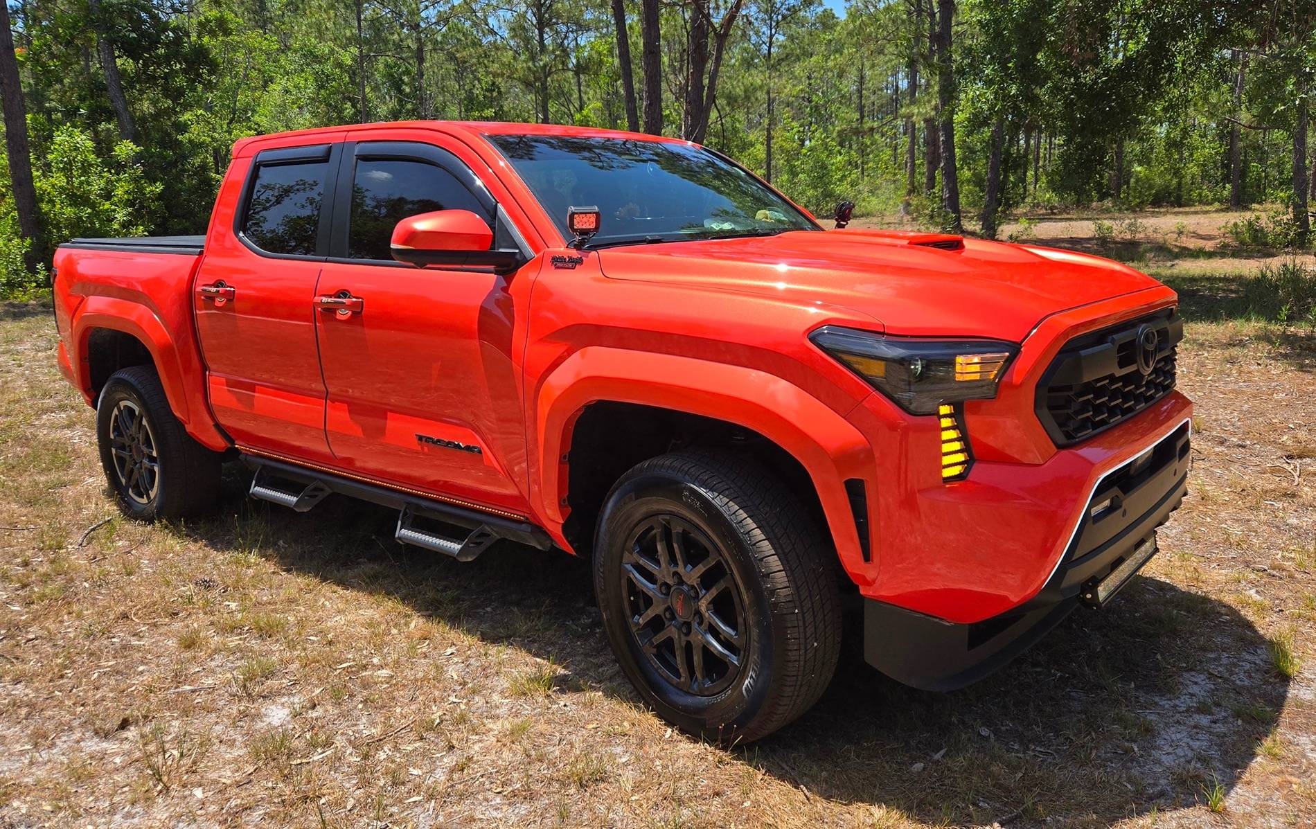

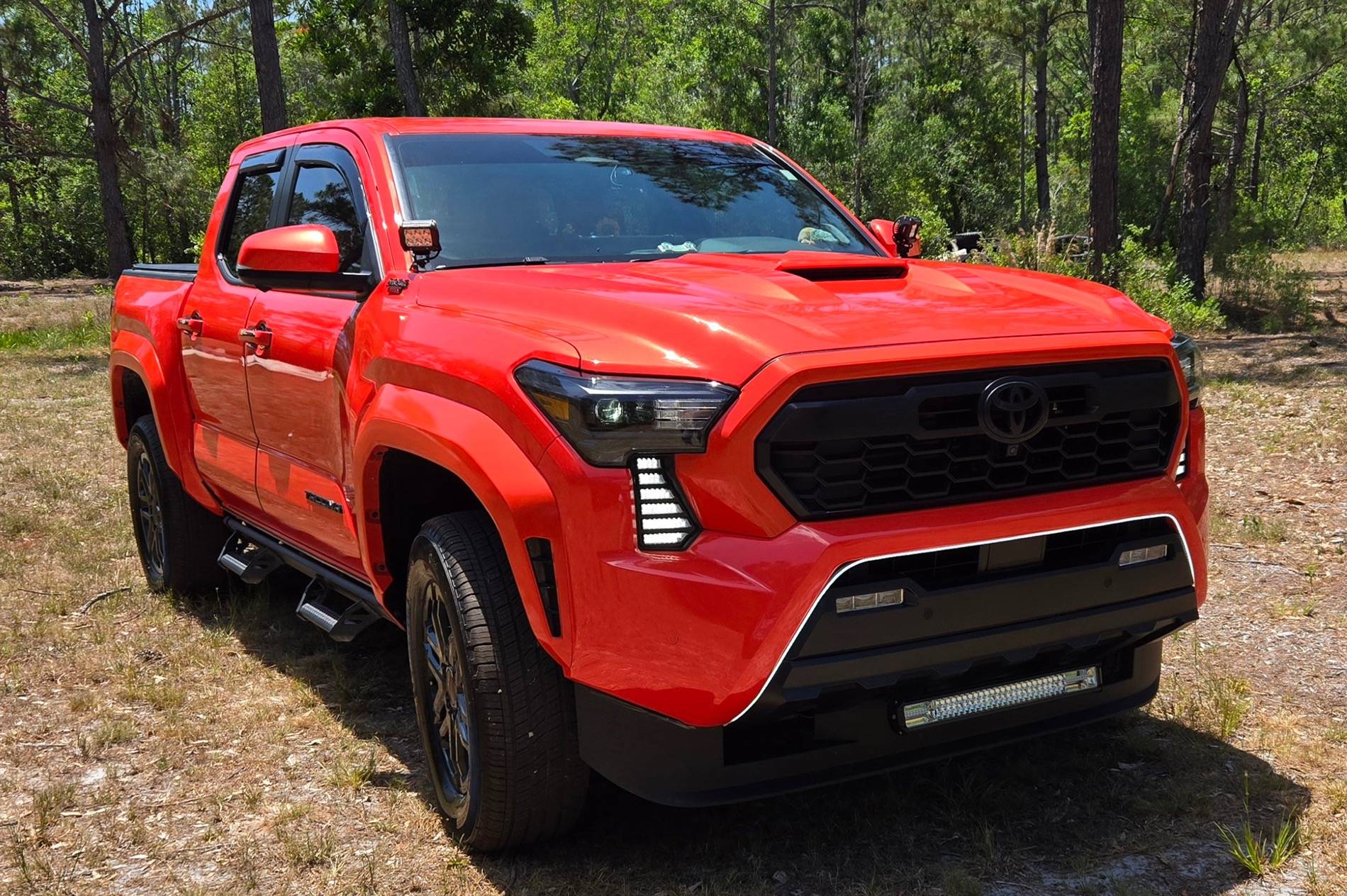

I just finished installing the Aspire V2 fang lights on my Tacoma. Whole install took about 45 min, but 30 of that was getting the factory plastic pieces off and zip tying the wires out of the way.
Legitimately plug and play. Once the Fang light is in the bumper, you untwist the yellow turn signal bulb, take it out of the housing plug it into the female end of the prewired adapter, plug the other adapter end into the truck wire housing and put the bulb back in.
I finished in the dark, so pics aren't great. But will upload new pics later
