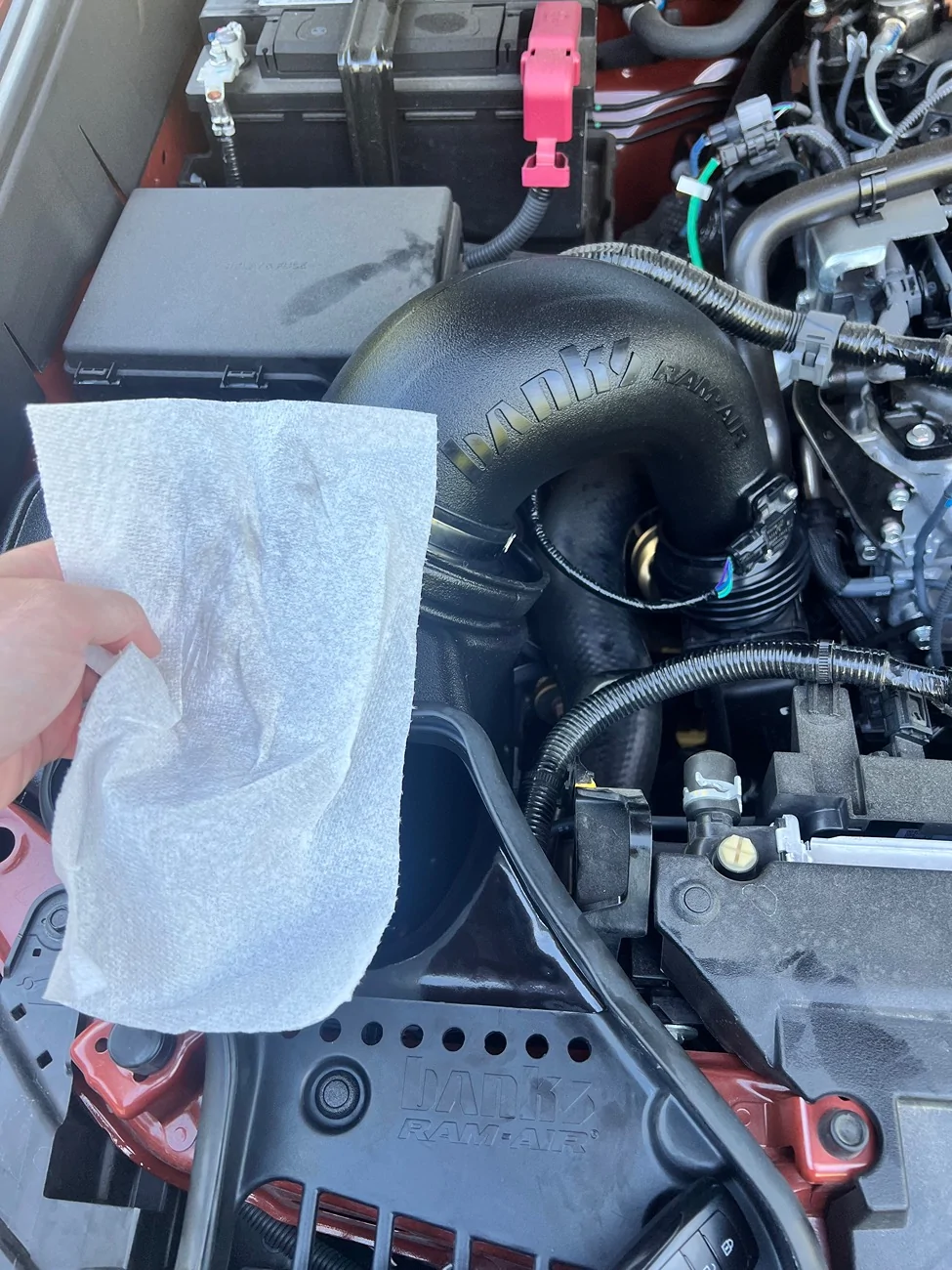

You can see the whole thing looks like it has tire shine on it and there are greasy finger prints all over the engine bay from getting it all over my hands. Easily wiped onto a paper towel too.
I left the plug on the side because your social media team has said that the side plug can only be removed in dry conditions.

Thank you for providing a photo. The coating is not grease; it's a silicone spray used to pull the part from the mold. It's supposed to be wiped off at the factory. Apologies for the mess.

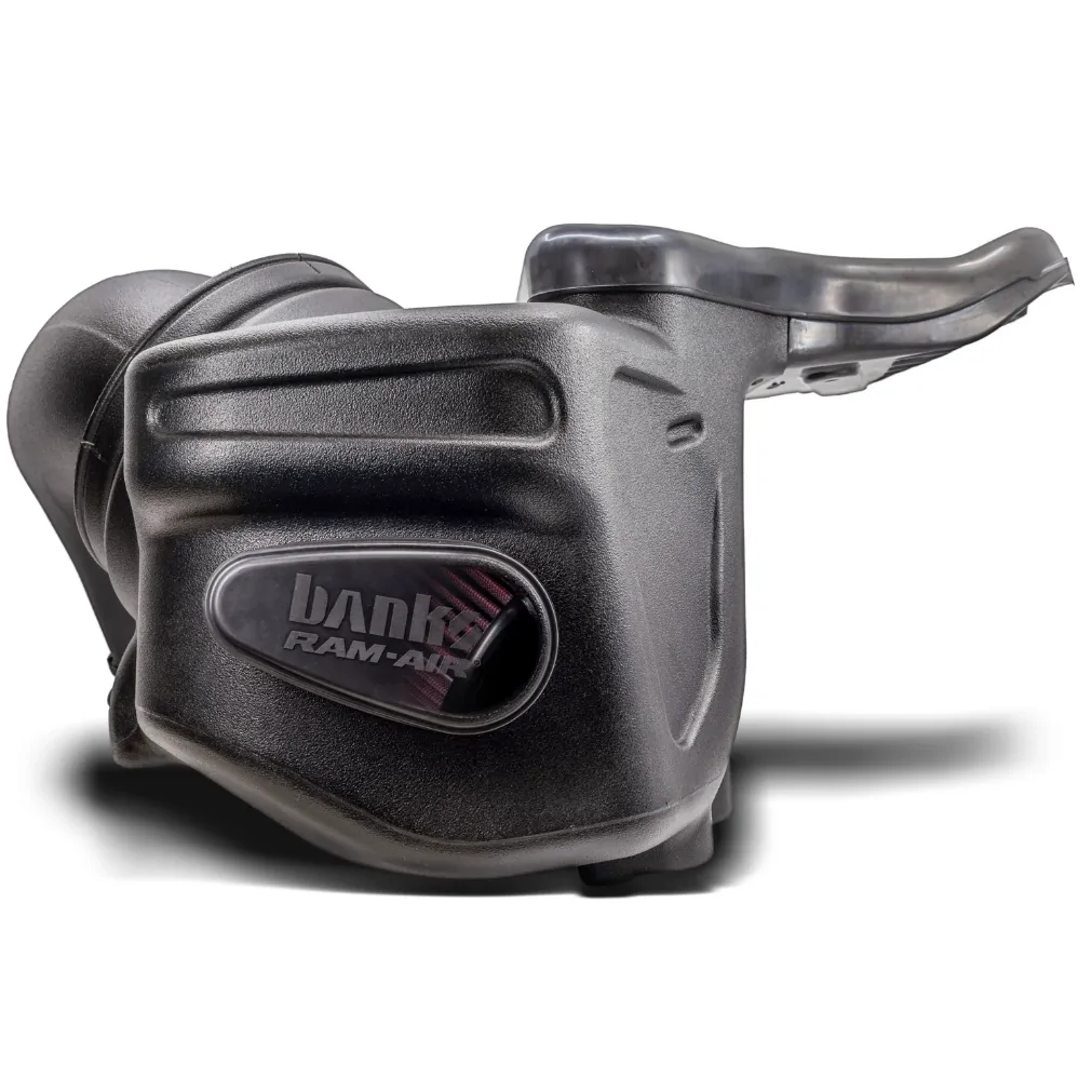

Regarding the sound, the Banks Ram-Air Intake is designed to maximize power and air flow to the system. This is why you are noticing better throttle response. With Banks, the side cover is for the guys who run a snorkel, so it's optional to remove the side panel if you would like to increase the sound. The good part, you can re-add it if you would like to.

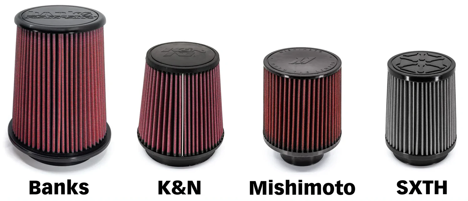

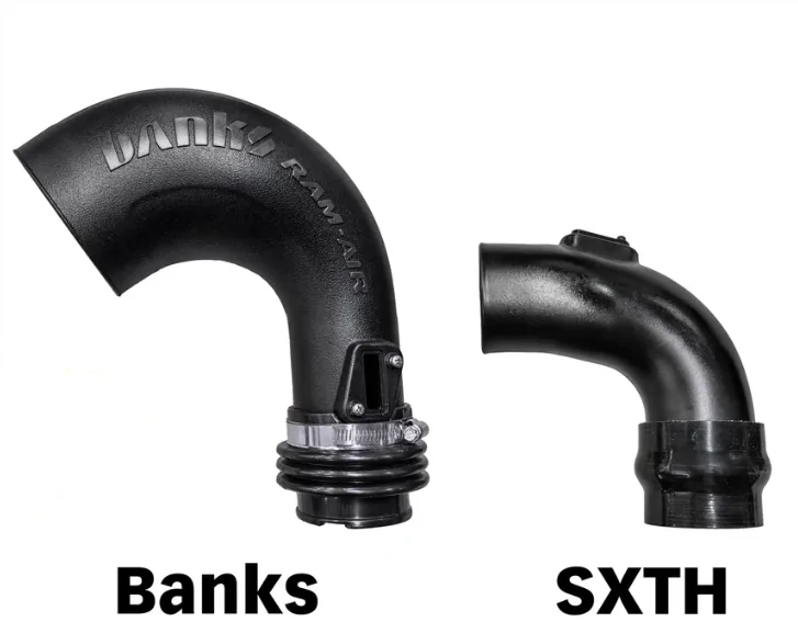

SXTH appears louder for a few reasons. One, plexiglass lid allows sound out, it's not fully enclosed. Two, the filter and tubing are much smaller. You can hear the air rushing through the metal mesh. Airflow is louder when it travels through a smaller orifice. As for the side cover, the SXTH offers nothing at all. So the risk for wet environments is always there; drainage is poor. That's why we've seen reports of pools of water at the bottom of the intake housing.
