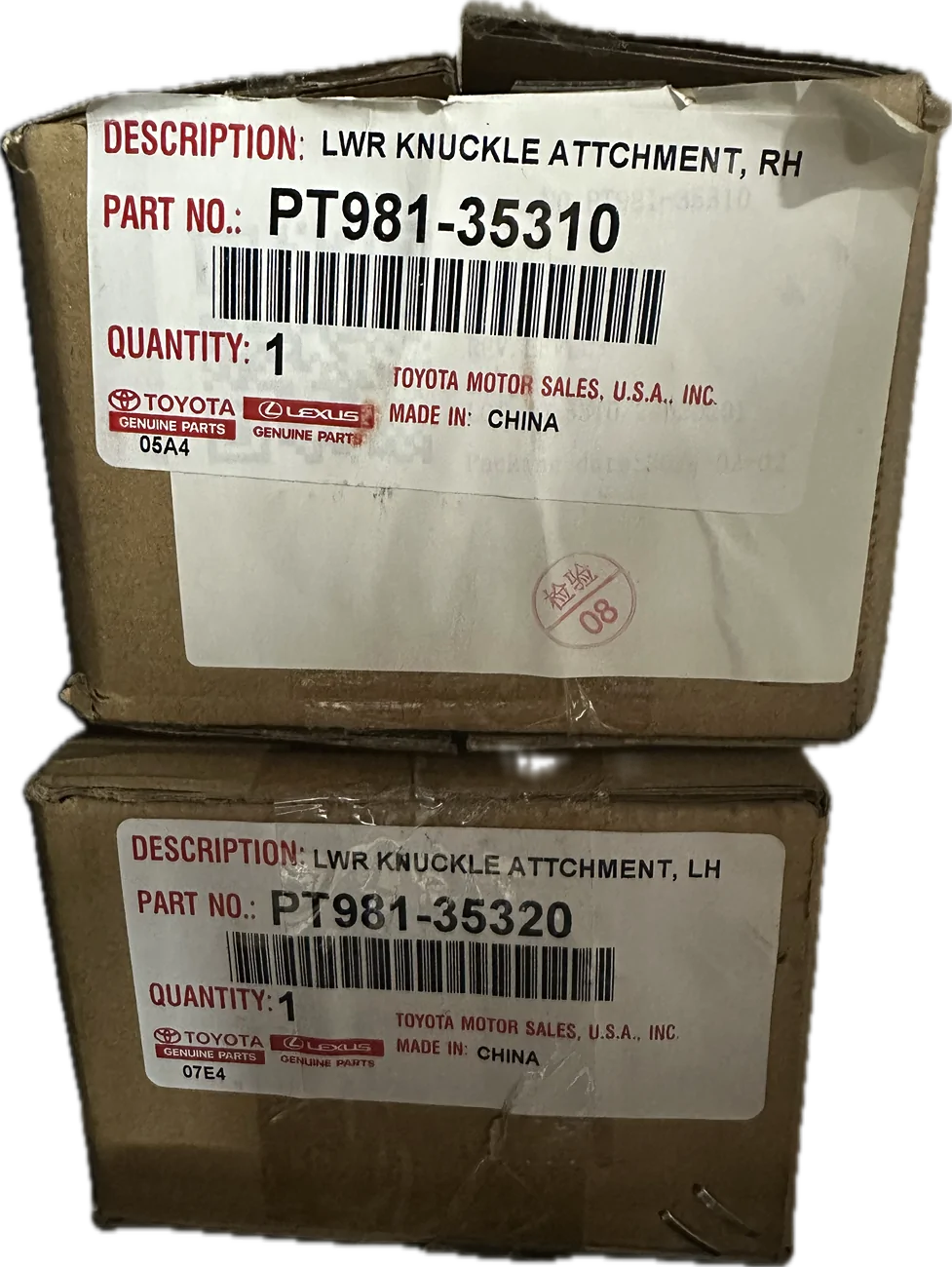

How is the turning radius compared to stock? I just got the MT64s installed as well but have the front on the highest lift setting. Turning radius is quite a bit larger than stock so not sure if dropping the lift down a bit in the front would fix this.
It’s one of the first things I noticed was off when I had the MT64 installed. I’m actually getting the TRD lift lower control brackets install tomorrow. It is supposed to help with the turning radius.

Where did you purchase the lower control brackets and how much did those run? If you find out that fixed the turning issue I'm going to do the same thing
No judgment please, lol. I actually bought the 2.5” TRD lift kit through my dealer. I wanted the kit incase I wanted to change things up in the future. The parts come in a huge box. I’m getting the extended tie rod ends and the lower control brackets from the kit installed today. Once they are finished I’ll get the part numbers and post them here for you. 👍

Here are the part numbers for the lower knuckles. Also seems to have done the job to fix the turning radius. I can back in my lower drive without having to pull up and back again. 😜
I also had the new tierod ends installed. They said they were about a half inch longer.

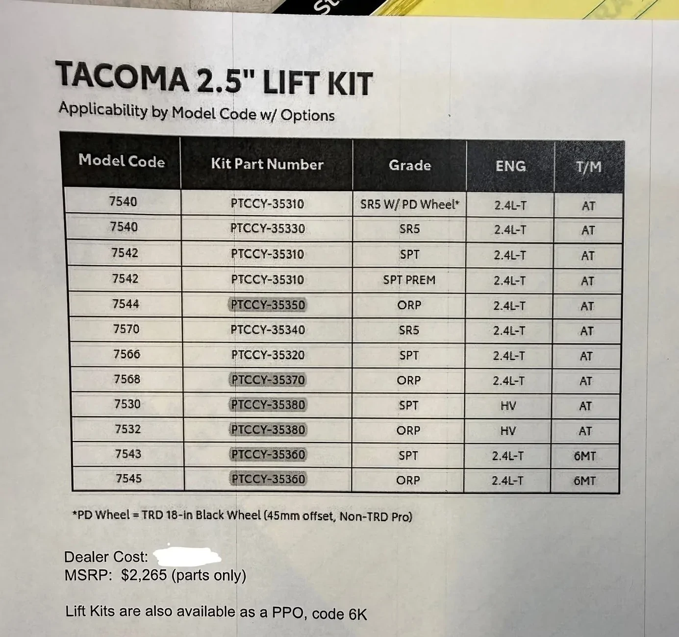

Do you have the whole kit number? From the video it seem the kit has options .

Thanks for the kit part number. I will take a look. Are you installing this or is the dealer? Keep us posted with before and after pics and measurements and your review.
