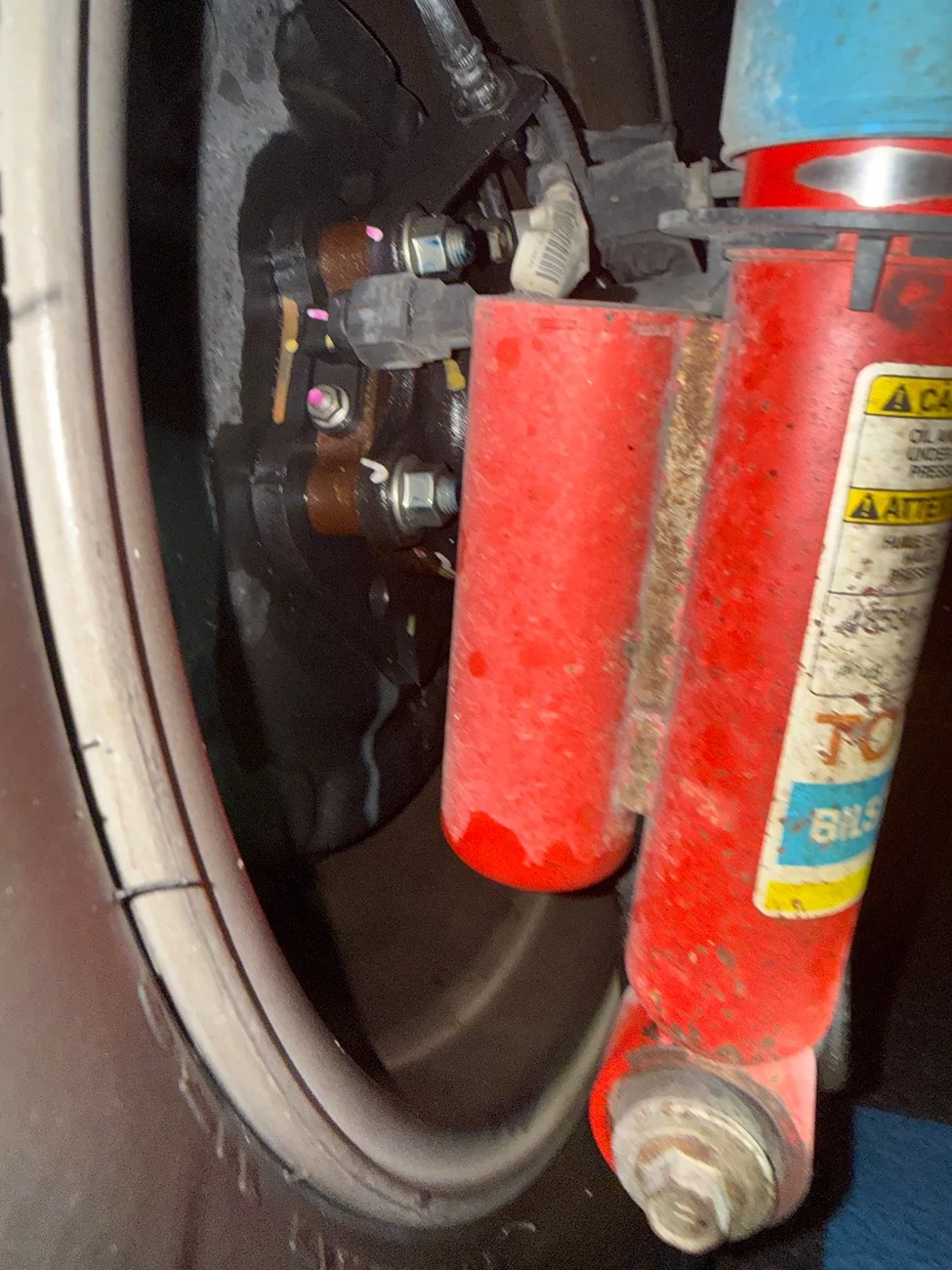

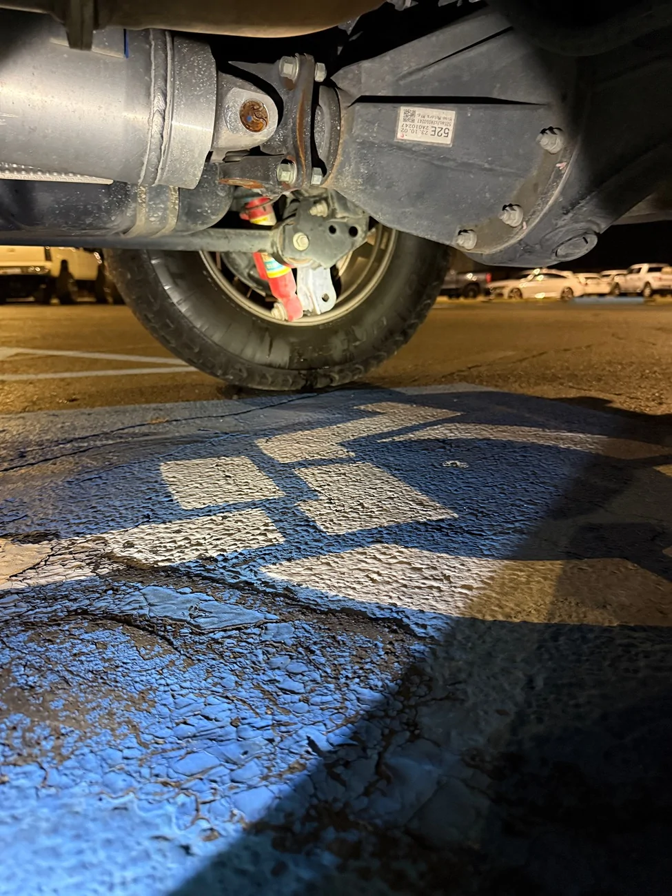

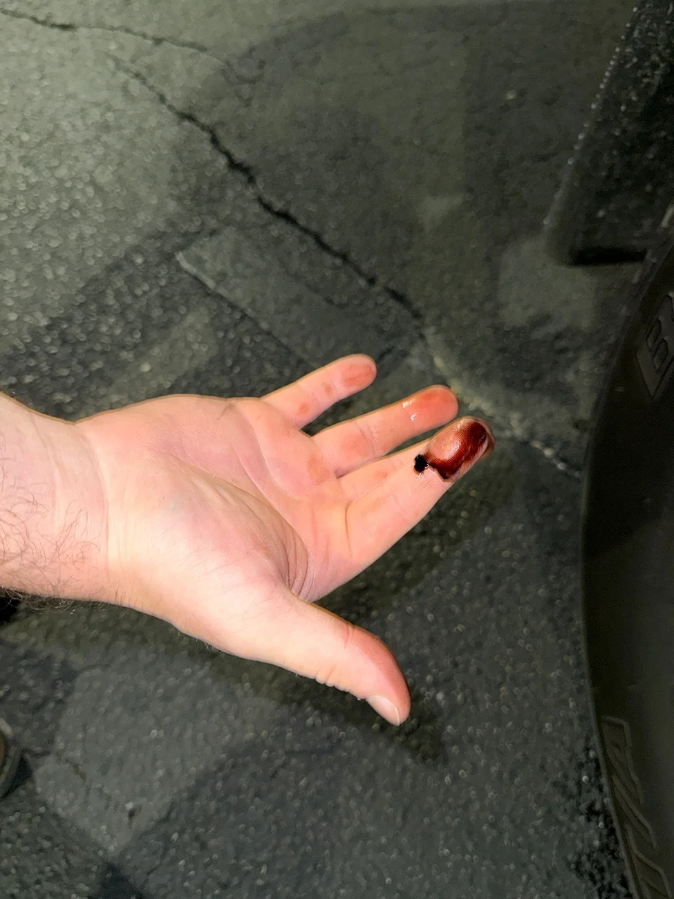

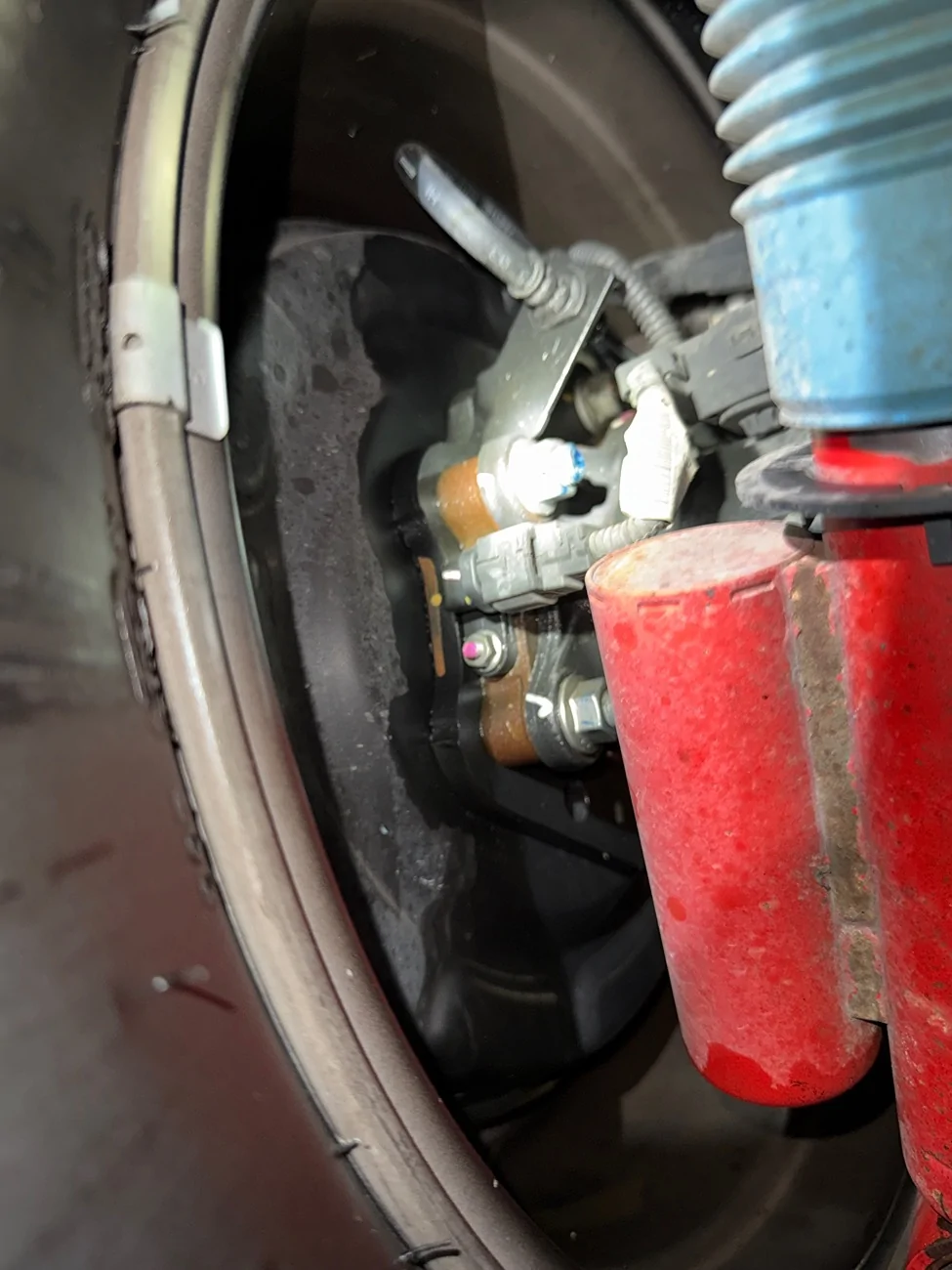

UPDATE: checked under truck, sure enough rear passenger side brake line leak. Oil is everywhere. Even in the wheel well, brake fluid is even lower under hood.
