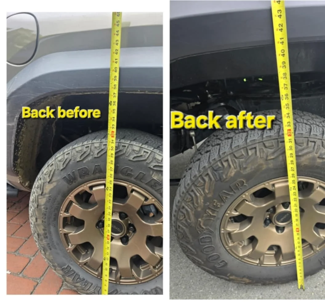

Yes 3" lift with Decked system that is approximately 200lb empty at that time.

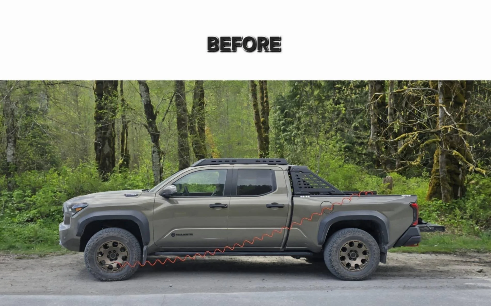

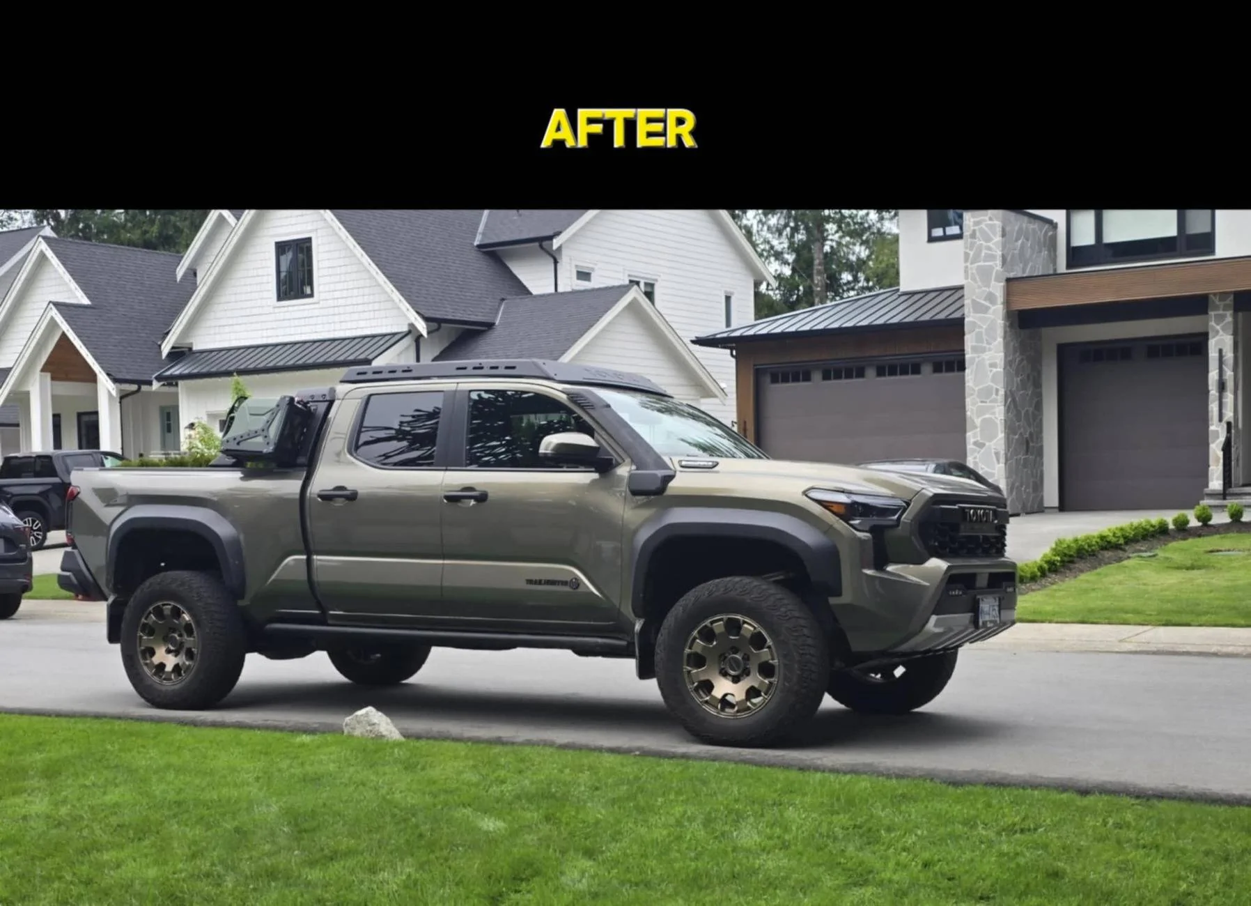

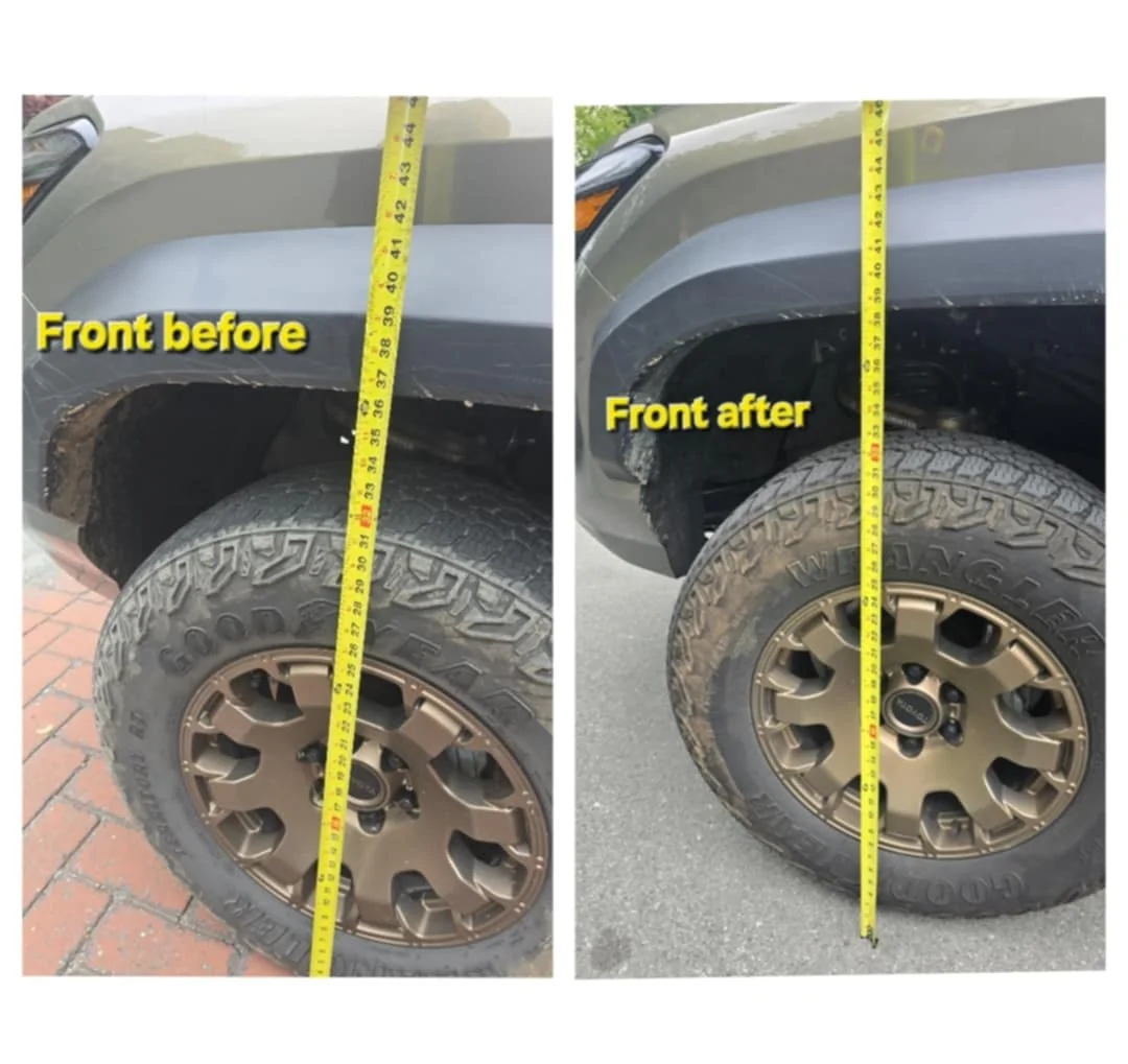

Changed coils on Trailhunter. Got 2 inches on the front and 3 on the back. And I can't believe how drives much much better - huge improvement. Even my mechanic was shock how trucks feels much better with stiffer coils.

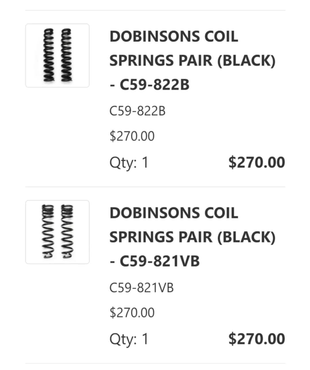

Just out of curiosity, can you confirm which spring you used on the front, 822 or 821? And did your research or calculations include you introducing any added weight to your TH down the rode or do you have any added components ie winch etc currently on your rig?
