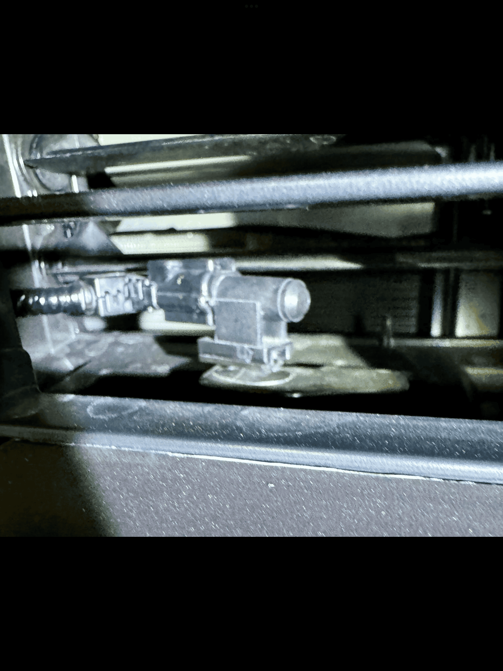

This post is copy paste . Saw someone posted on facebook about grill shutter malfunction

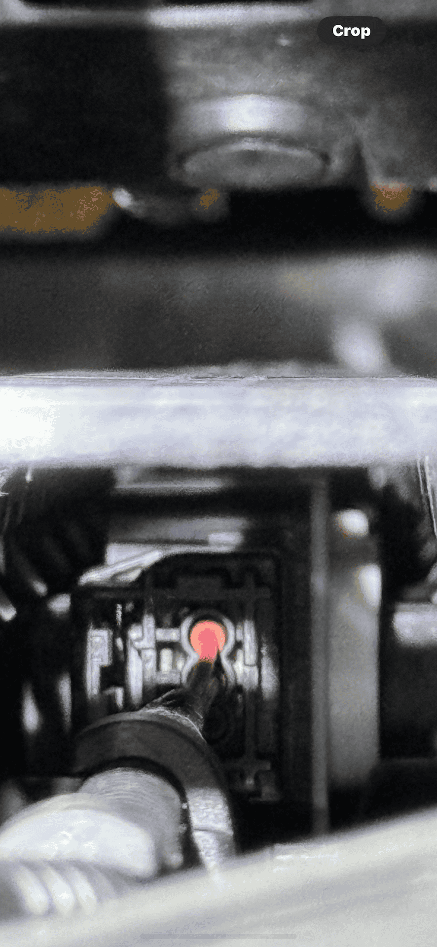

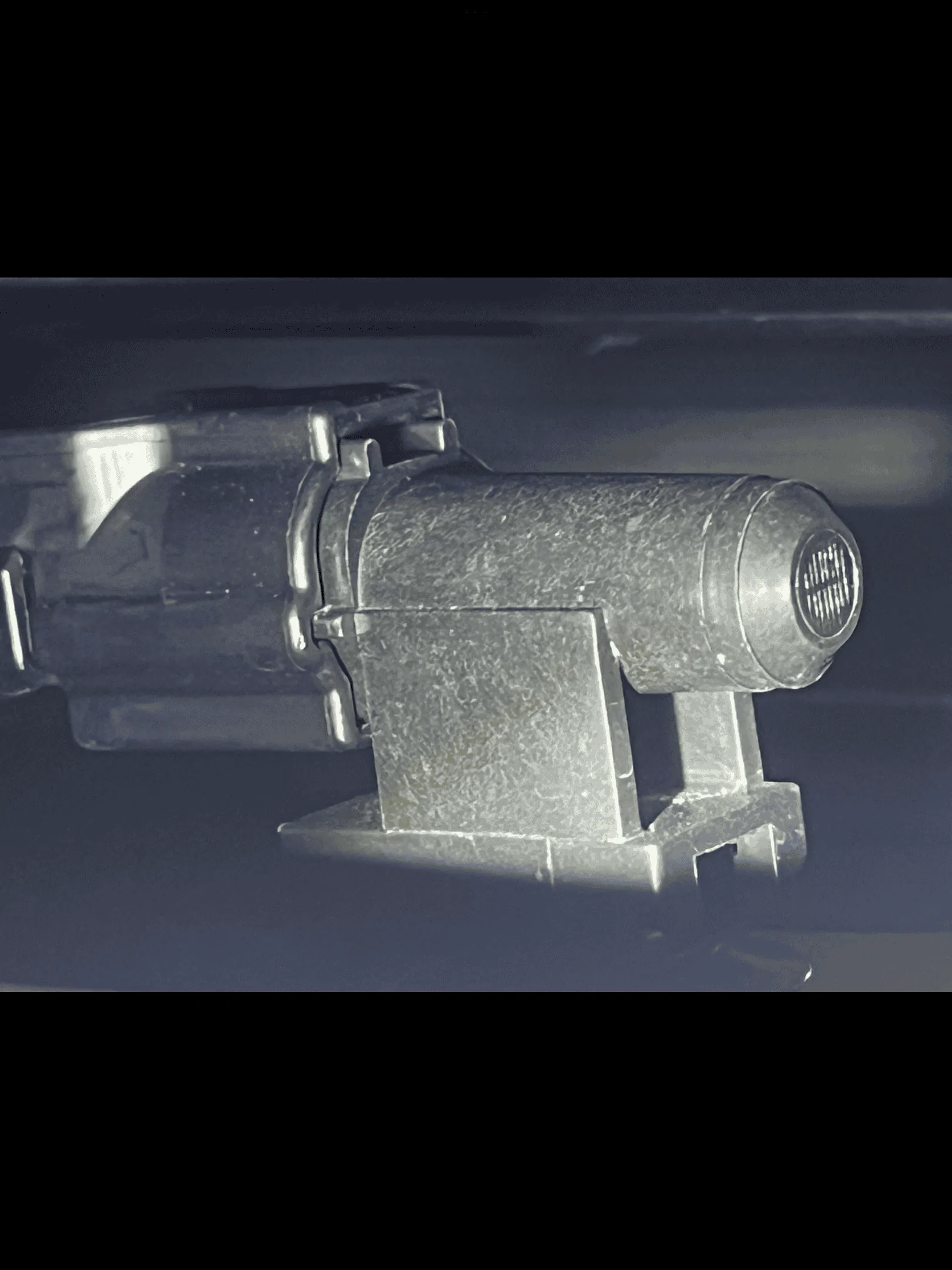

Radiator grill shutter sensor has been causing a check engine warning light with some 24 Tacoma owner trucks. It seems the connection allows moisture to enter causing the issue. Here are images of the Grill Shutter Sensor as seen from front of lower grill just in front of the shutters.

Yup, issue is not new. Has been popping up since about 2 weeks after they hit the lots. Lack of proper seal or dielectric grease. Many suspect that is what the QC hold was for back in February.

Just a guess, I do not think it is the sensor. I think it is the actuator that opens and closes the active shutter grill Look down the center of the shutter about 6 inches down you will see the connector. You will see the top of connector is like a cup and will retain water if water gets to it. You can clearly see the connector wires as well. Rain etc will probably not do it but high pressure water will and can collect in the connector cause corrosion. Poor design. I got a long q tip and filled the connector with dielectric grease. I hand wash my truck (always have) and do not use high pressure on the grill. A Toyota mechanic told me they have had issues with just about every vehicle that toyota uses the active grill shutter on. I asked him why don't they redesign the connector and he said they just fix them, they don't design them.
