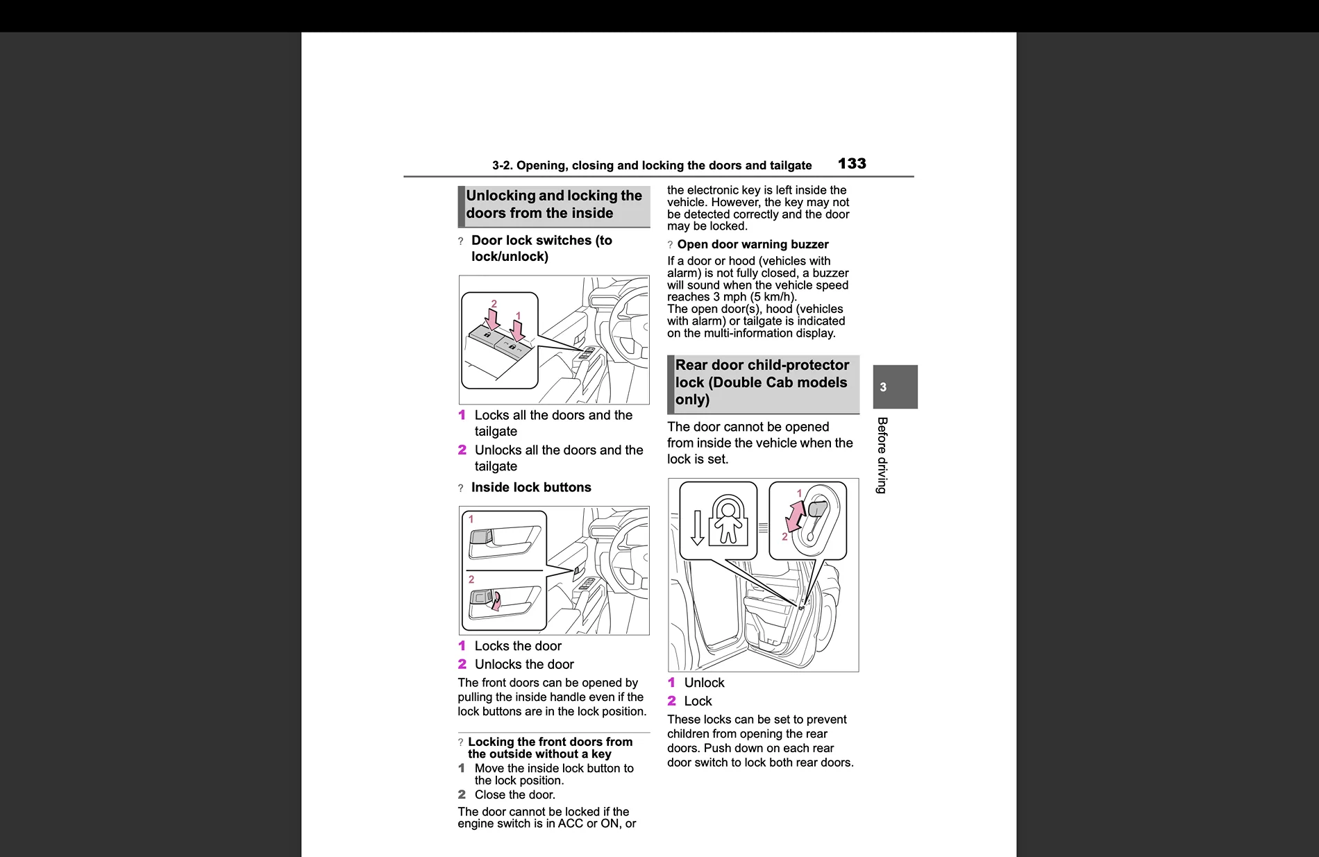

Attached is an excerpt from the owners manual. See column one, at the bottom.
Reads that the truck cannot be locked while in Accessory mode or On.
It does not mention using the physical key; that might be an option.

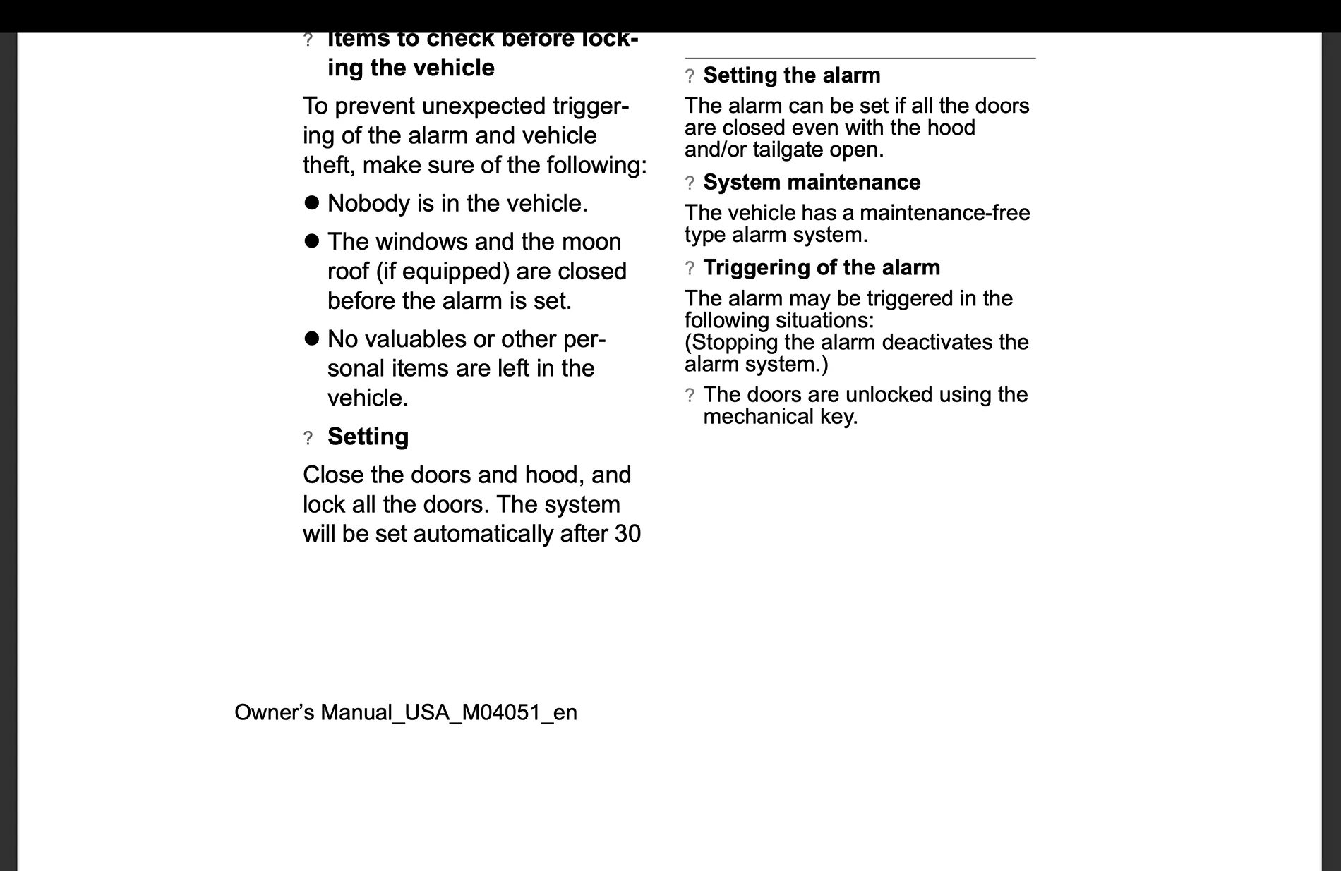

Notice the comment on the second attachment: using the physical key can trigger the alarm. Different manufacturer, but I encountered this using a rental. Turn off, lock the car with the key, leave. Return, unlock using physical key, alarm goes off. While the alarm was going off, get in, start the car to stop the alarm.
^ I feel this has to do with the chipsets and authentication. When locking/unlocking using the physical key, you're physically authenticating to the truck. With the fob and hand-in-door handle, using the chipset algorithm in the physical key and the radio transmitter of the fob, you're logically authenticating to the truck with an encrypted key. In the former, I could be picking the lock. In the latter, it proves I have the key/chipset.
You're attempting to physically lock the truck while running. IDK what will happen. Maybe that's a great solution. Maybe the truck will immediately unlock itself. Maybe the alarm will go off when later unlocking. You'll just have to experiment and see what happens.
