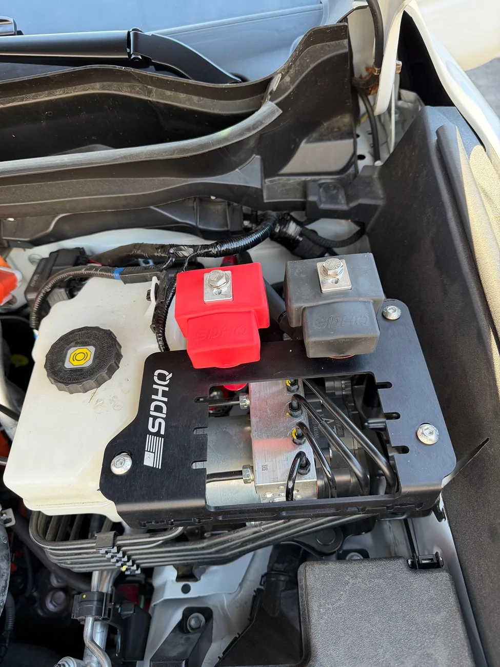

Hey! I have a 25 Pro with a 10k winch hooked up to an SDHQ power relocation kit. Used the winch last week to pull out my coworkers work truck. It worked flawlessly! Hope that helps
Yes Sir, thank you! Any after affects on your 12v battery?
I normally swap in a bigger AGM battery on previous vehicles when I add a winch. Great news that the Pro is handling it. Does yours have the alternator?
So this relocation just runs from the battery in the back, and I assume you can 1) connect the winch to it, and 2) charge the battery. Correct? Did you buy their cables, or others? There are cheaper options unless they require their cables.
Yessir! It runs to the standard starter battery under the back seat. You can connect whatever accessories you have to the terminals that are mounted under the hood.
So far no negative effects. I run the winch with the truck on but run my fridge off of an outlet i installed in the bed. It’ll run for a couple hours before my fridges auto voltage drop meter turns itself off.
I’m not sure if I have an alternator tbh. I’ve never paid attention to it lol.
A bit expensive, but pretty cool. It looks like you have to buy it in three parts, cables, and the other parts for the engine compartment. Is that correct, and do you have a link? Sorry for so many questions, but I plan on a winch and I'm getting tired of raising the seat to charge the battery.
It definitely wasn’t cheap but well worth it for what I have planned for the truck. Ifigured it was a buy once, cry once kinda thing. It’s been one of the best mods I’ve done as far as future proofing the truck.
You don’t have to buy it in parts. They sell it as a whole kit already put the together. It took me a couple hours to install in my driveway. Victory 4x4 sells something similar as well but looked a little cheap imo.
