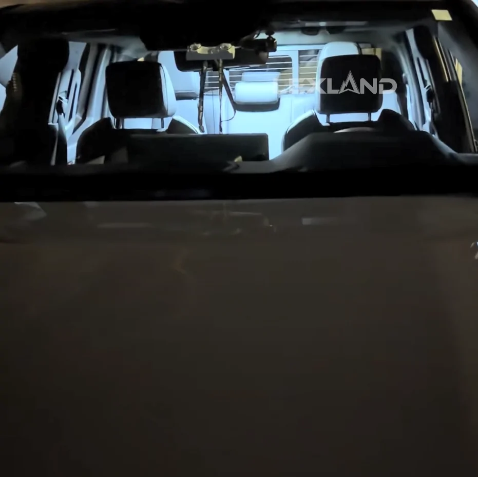

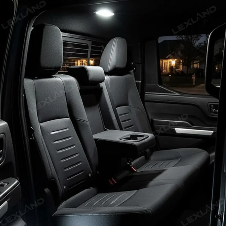

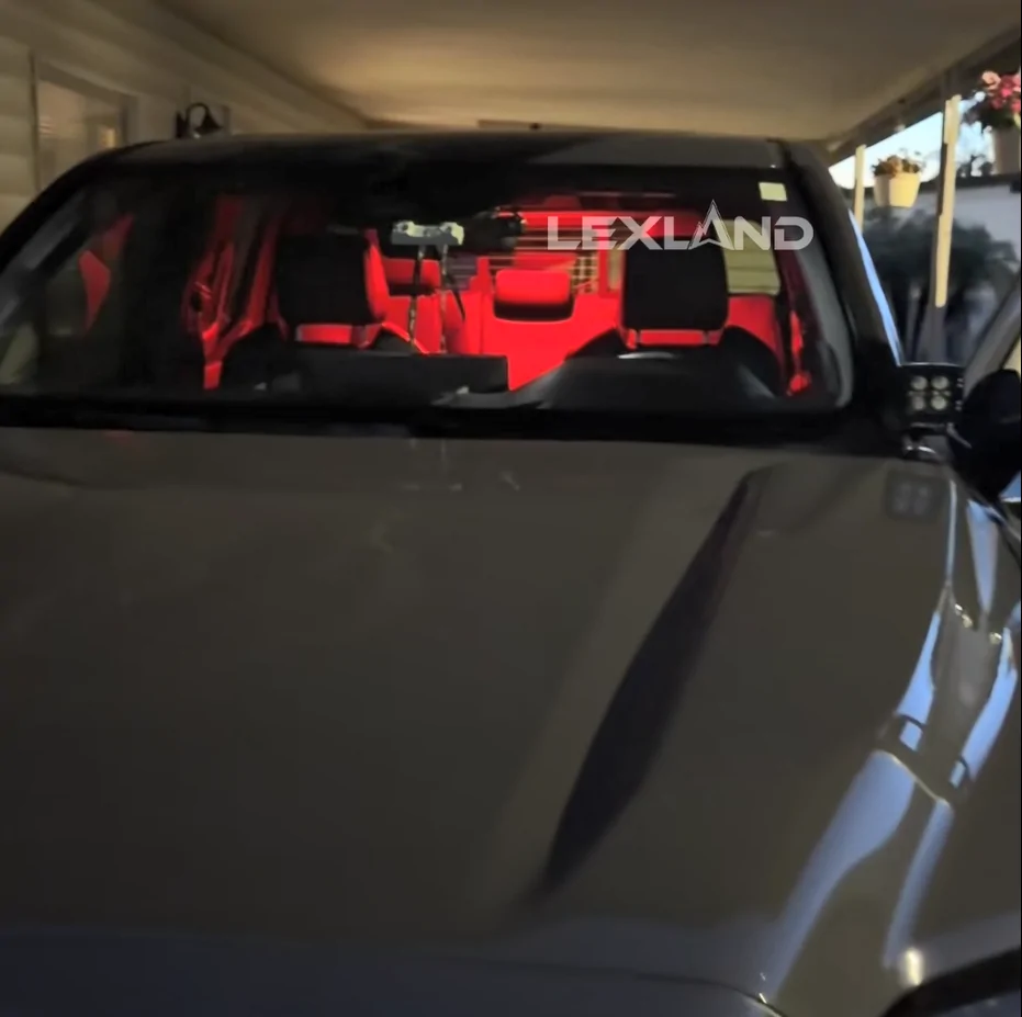

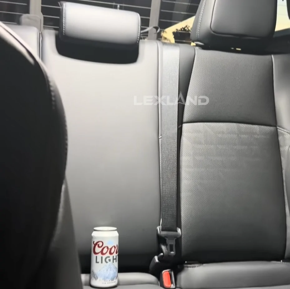

Do you feel the Tacoma interior is too dark?We had installed the rear dome lights on the 2024+ Tacoma,let's see how it looks!
  • High-Brightness LED: Provides bright, even lighting for clear visibility inside the vehicle, even in low-light conditions.
  • Dual-Color Modes: Easily switch between red and white lighting to fit different driving or camping needs.
  • Plug-and-Play Installation: No wiring modifications or special tools required. Quick and easy DIY installation for Tacoma/4Runner owners.
  • Durable Build: Made from high-quality ABS material with heat-resistant and shockproof performance for long-lasting reliability.
  • Modern Design: Sleek style matches the Tacoma/4Runner interior while delivering soft, comfortable, non-glare lighting.
