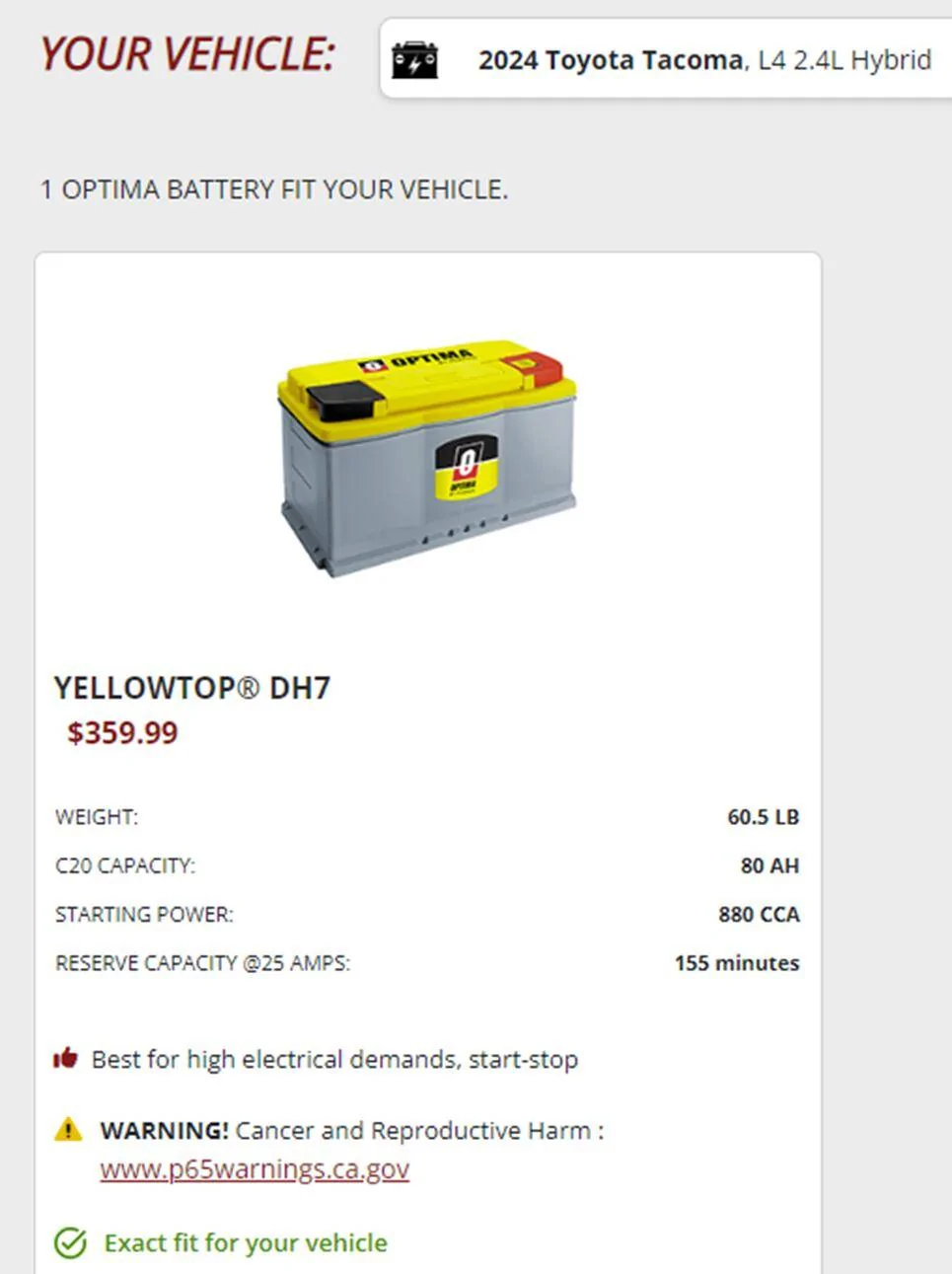

After doing much research for the best battery for my 2024 Pro, I think this Optima is the best out there for my truck. I will see if my current battery discharges again, and if it does, I will take it to the dealer. I looks like the Optima is a Clarios made battery.
Great information here: https://www.optimabatteries.com/support
If anyone has any comments on the proper battery, or if they have a better or different suggestion, please comment.
https://www.optimabatteries.com/products/yellowtop-dh7

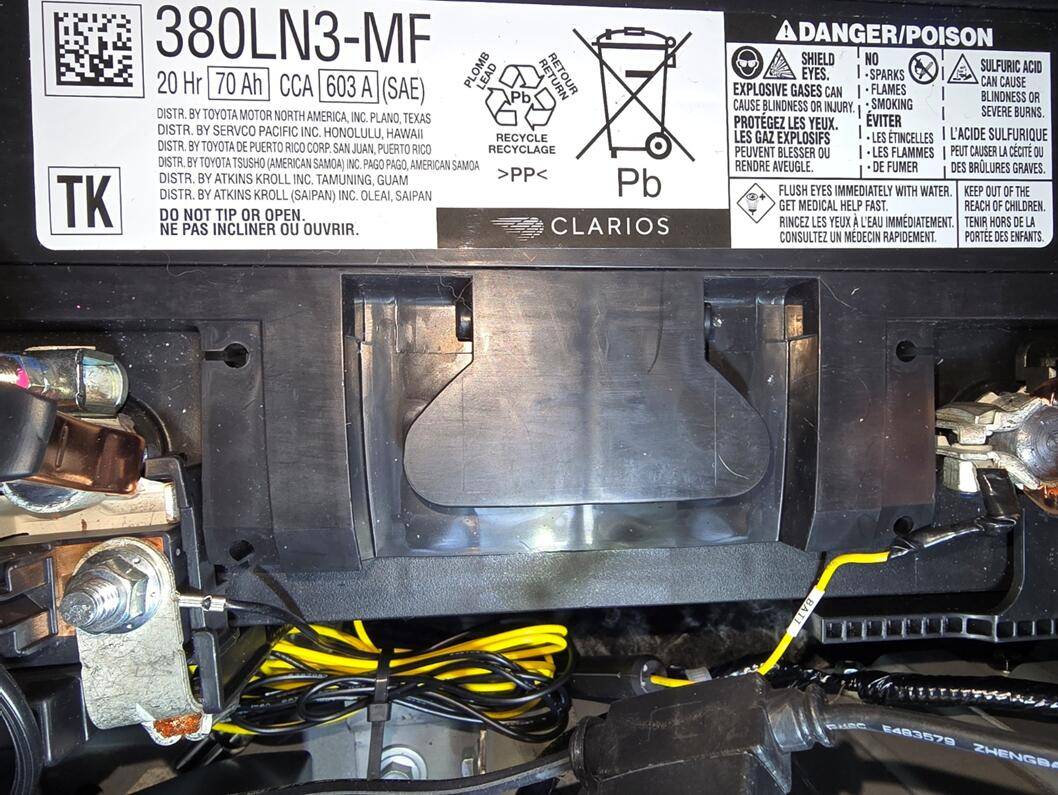

This is my original battery which is listed as a Clarios 380LN3-MF.

I'll be looking at going to an Optima, when the time eventually comes to do so, but I was looking at using the Yellowtop DH6 as the replacement. The Optima site shows the DH7 for both hybrid and non-hybrid models, but the dimensions for the DH6 are more similar to the 380LN3. I think the DH7 may be too long.
I was wondering the same thing. Before making a purchase I would make actual measurements of my current OEM battery and area to be sure it would fit. Since they do work with Toyota directly, I would hope they would know all there is to know, but I would check first to be sure. These things are quite heavy and not easy to return. :muscle:

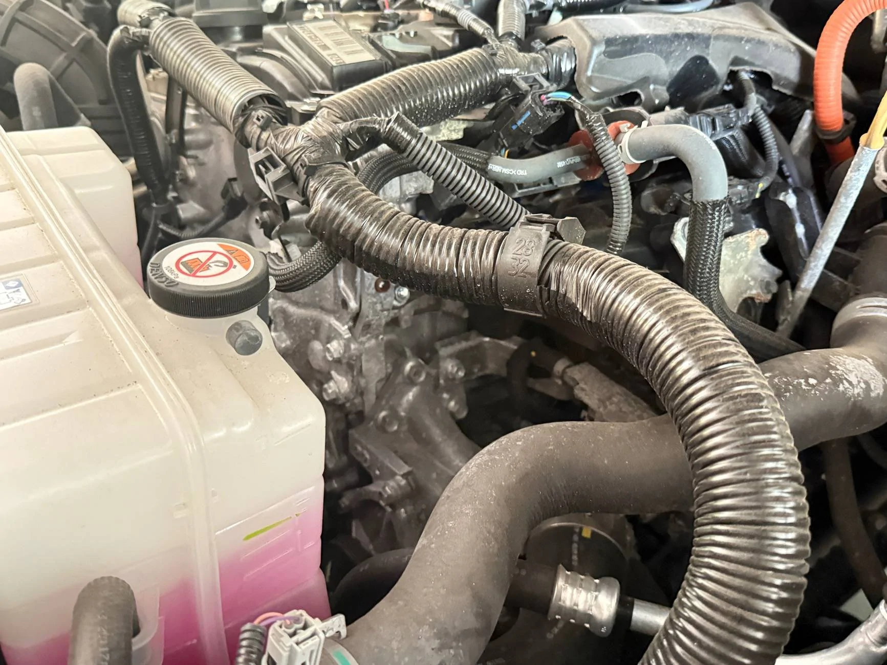

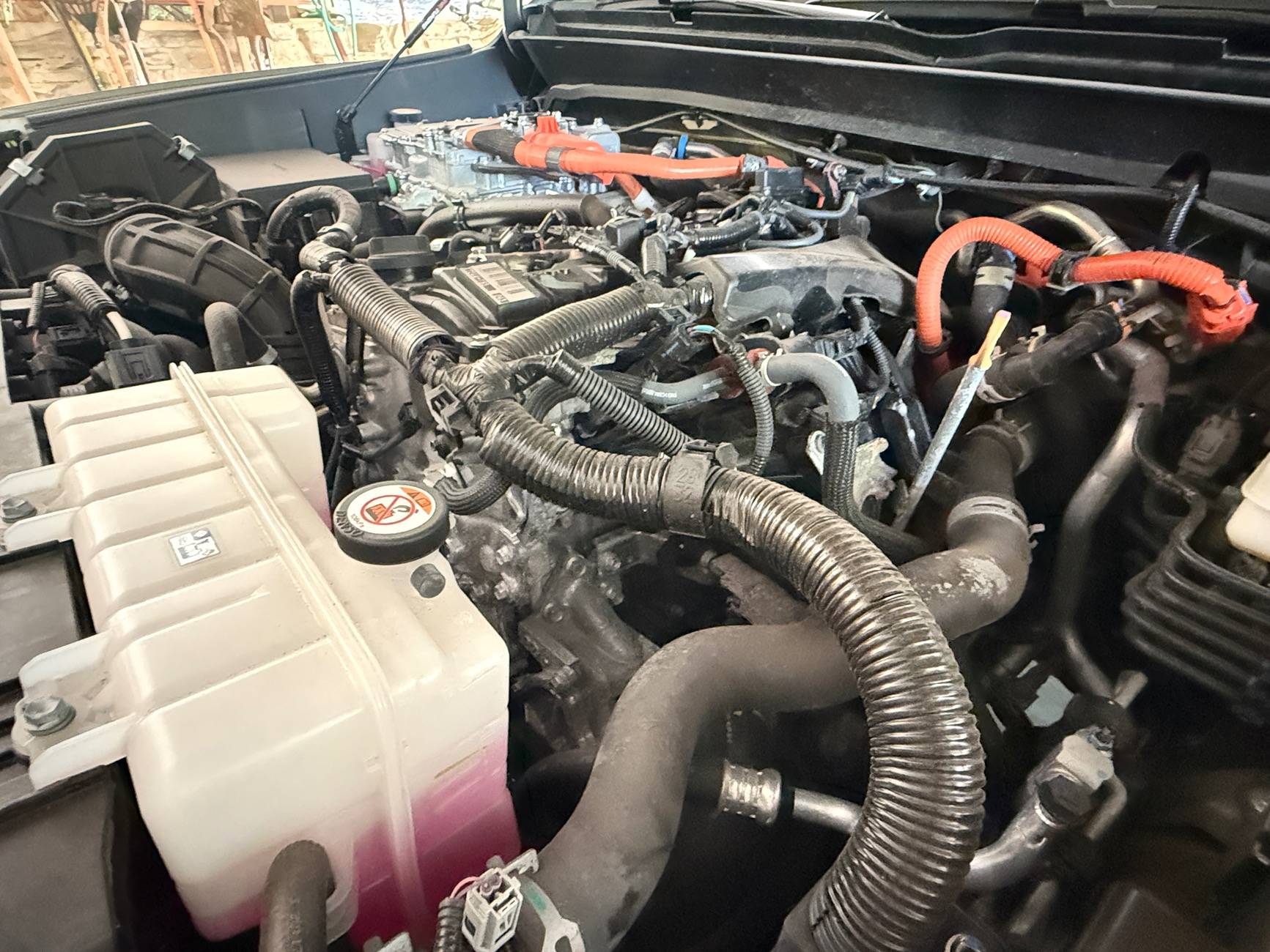

So my late season 24 TH doesnt have an alternator..Maybe something they corrected in the 25 models? And leave those of us with 24 models hanging?

@Bcphoto3 None of the 2024 hybrids had alternators and only the trims with 4 AUX switches got one in 2025. Exactly what that means to those of us without an alternator is hard to say, and Toyota is not talking about it.
