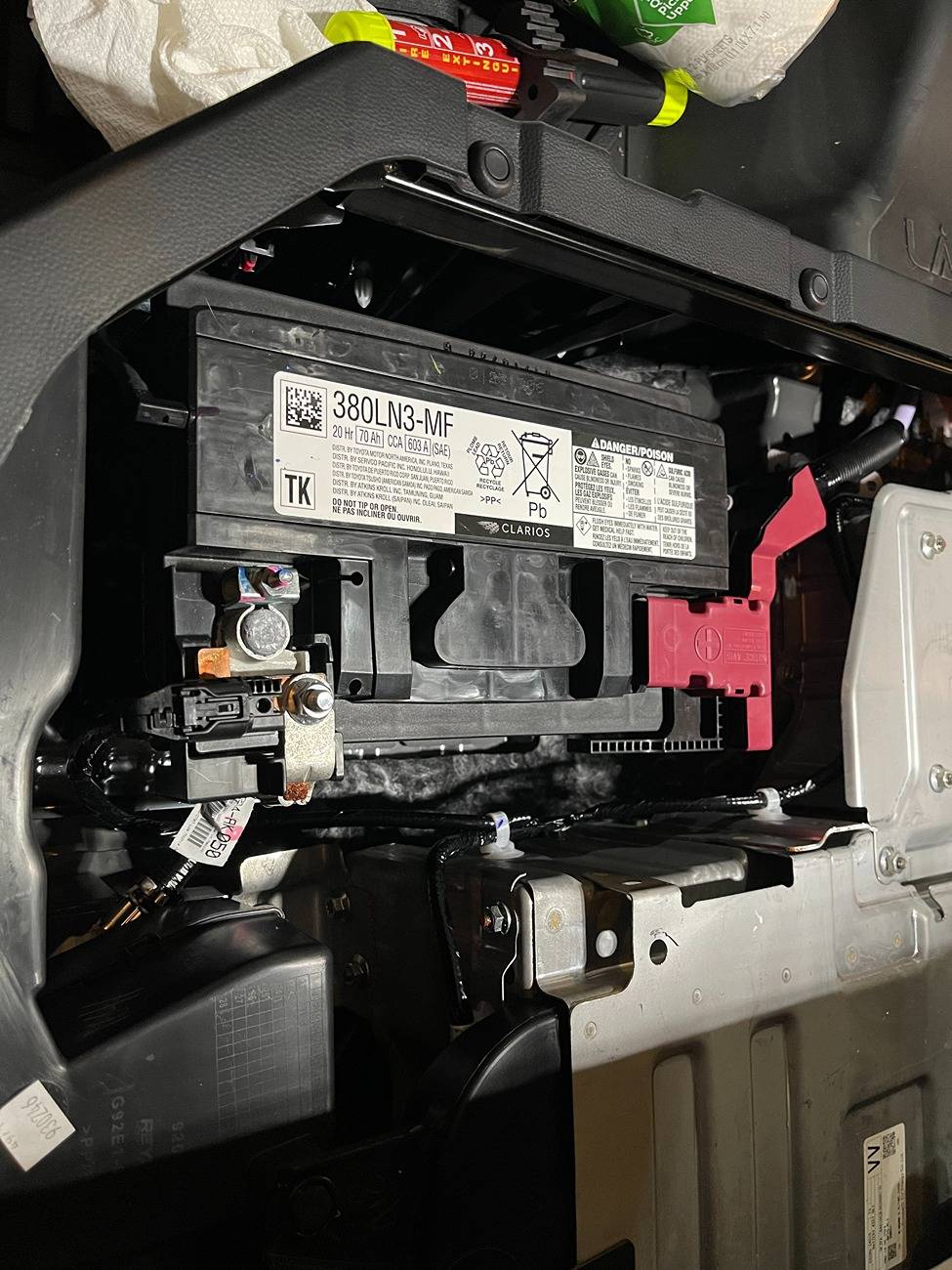

The batteries in the iForce MAX hybrids are not AGM batteries. They are made by Clarios, model # 380LN3-MF. It is an Enhanced Flooded Battery (EFB), designed for automotive use. It is a maintenance-free battery, meaning it does not require refilling with fluid after use. The "MF" in the product name stands for "Maintenance Free". This battery is a suitable replacement for various vehicle models, including the 2018 Toyota Camry. It has a 12VDC voltage and is identified by the BCI Group Size 48, EN Group Size LN3, and DIN Group Size H6.
Thank you for confirming my assumption, as AGM is not found anywhere on my battery.

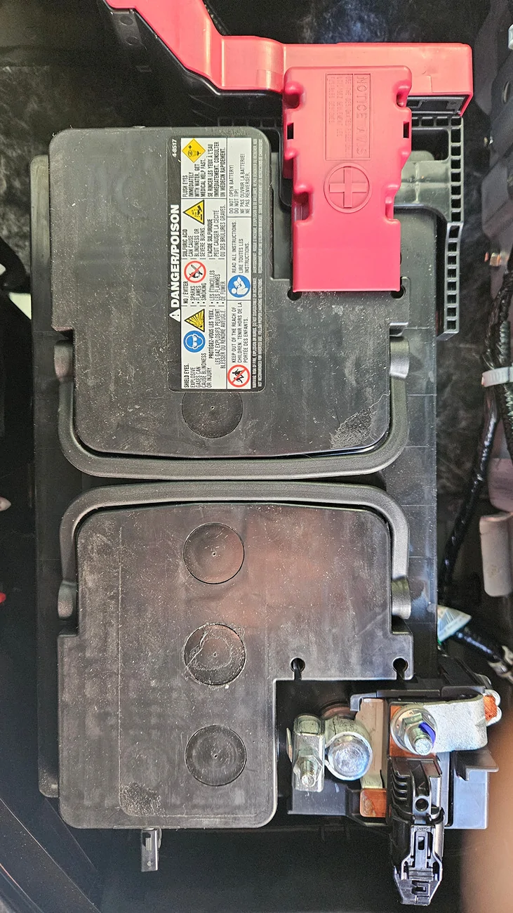

Here's picture of the battery that Toyota put to replace my faulty battery.
The original battery tested 480 CCA. My Tacoma was build in march 2025.

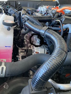

Looks to me like an alternator on my Hybrid, tought they had an electric motor generator only?
Pics or it didn't happen.
Are yours the same?
Thanks
JC
My 26 TH has an alternator. Toyotas way to solve the poorly charging 12V in the hybrids I assume.
But could they retrofit an alternator if they wanted to?
I guess it depends on the wiring harnesses. Are the harnesses the same for both hybrid and non-hybrid models? Would a new secondary harness be needed to backfit the alternator into the 2024 models? And then you’d likely need new software updates as well.
I did a brief review of ALLDATA, and while it's updated with 2025 information, I didn’t see anything that mentions the differences between the model years.
I have a 26 TH with alternator and it’s always charging (~14.3 most of the time). So I assume the alternator is functioning as designed. I have the 26 manual and there is nothing about an alternator.
It's a step backwards to add the alternator. Hard to imagine what has the engineers baffled enough to go that route.
Maybe they wanted to tweak the hybrid system to keep more juice in the battery when parked but that would have reduced their mpg below govt standards.
Sloppy engineering and (over)regulation. They could not stop the real problem so they slapped in a quick fix from the previous century.
It might be a quick fix, but there is a bolt thread in the block for the alternator so there was some planning involved. I’ll post an image tomorrow.

My 26 TH has one (see image). Note that it is bolted to the block as if the threaded hole was there all the time, perhaps from other Tacomas or 4runners that have them. In any case it looks like the block was cast to accept an alternator regardless whether they installed them or not. O

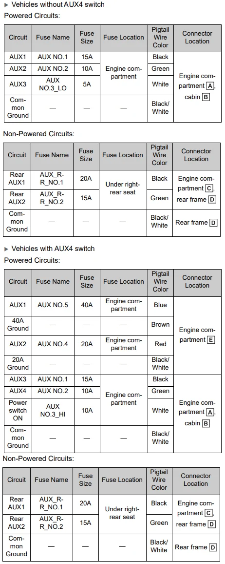

Trucks with 4 AUX switches (TH/Pro) seem to get the alternator, trucks with 3 do not.
Per the 2026 owners manual, fusing seems to be different as well, which may be related.

It looks like when I install a winch I’ll use AUX 1 since it’s 40A.
That is what I assumed also, but some people have posted about hybrids with alternators that still do not keep their 12v batteries charged. That makes me think that even trucks with alternators still charge their 12v batteries with the same DC/DC voltage converter as trucks without one. A lot of people think the alternator is just to support the 4th AUX, although Toyota won't talk about any of this at all.
Then they are only for supporting juice used through the 4th AUX? 1) it seems extreme just to support that; and 2) why isn't Toyota informing users?
