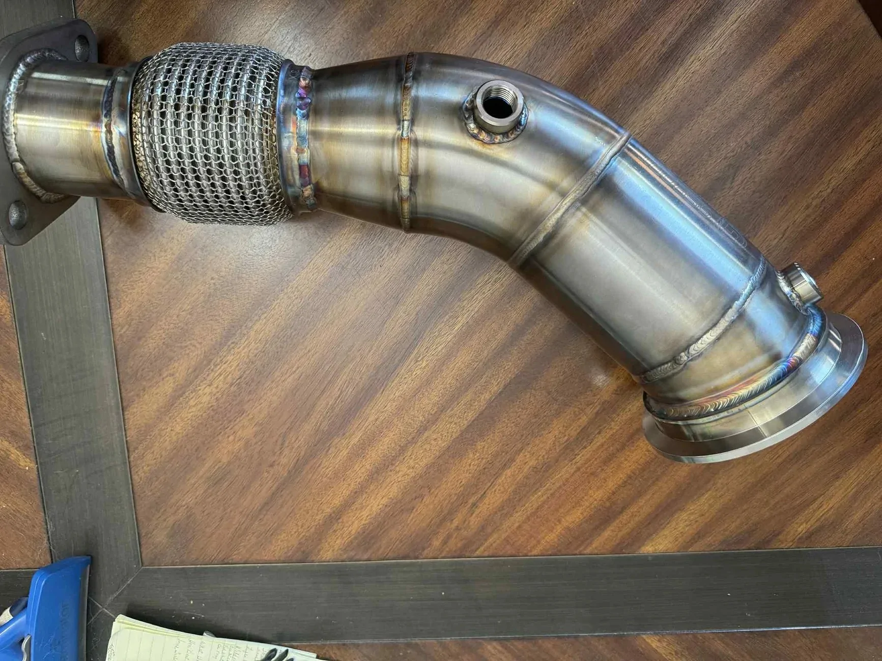

Any approximate release on a downpipe? Also, what pros and cons are you encountering with the downpipe R+D?

I will let you all know as soon as pre-orders open so you can reserve a unit from the first production batch. Our web developer is taking a bit more time than we'd anticipated, and it's holding things up - and that's on us, but I thought I'd share a note to let you know where the hang-up is.
Production is expected to begin after the PRI show.
