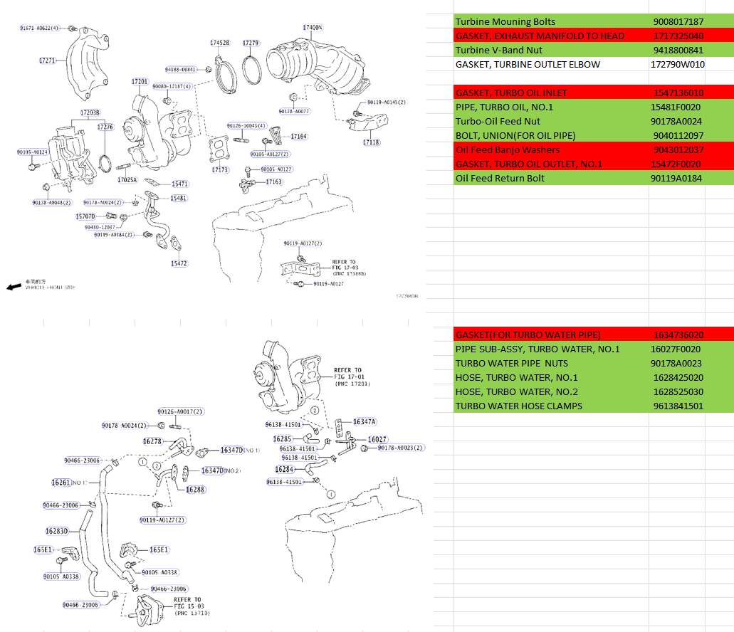

As promised, here are the part numbers for all the parts you'd need to fully build/assemble a replacement on the bench, allowing for a direct 1:1 swap.
For those not interested in a full swap, the turbine gasket, oil feed, oil return, and coolant feed/return gaskets are about all you'd need.
I've gone ahead and color coded the list to indicate what needs to be replaced (per Toyota) and what is "optional". Anything in RED is what Toyota indicates are required. Anything in GREEN is optional if you want or need to replace additional parts.
*Corrected*
I'm also attaching the FSM Removal and Installation Instructions.
Are you sure that is the correct gasket part number for the manifold-head? My parts catalogue has that as a gasket for a 90s Supra. The part number I get for the manifold gasket is 17173-25040. All other part numbers in red look correct.

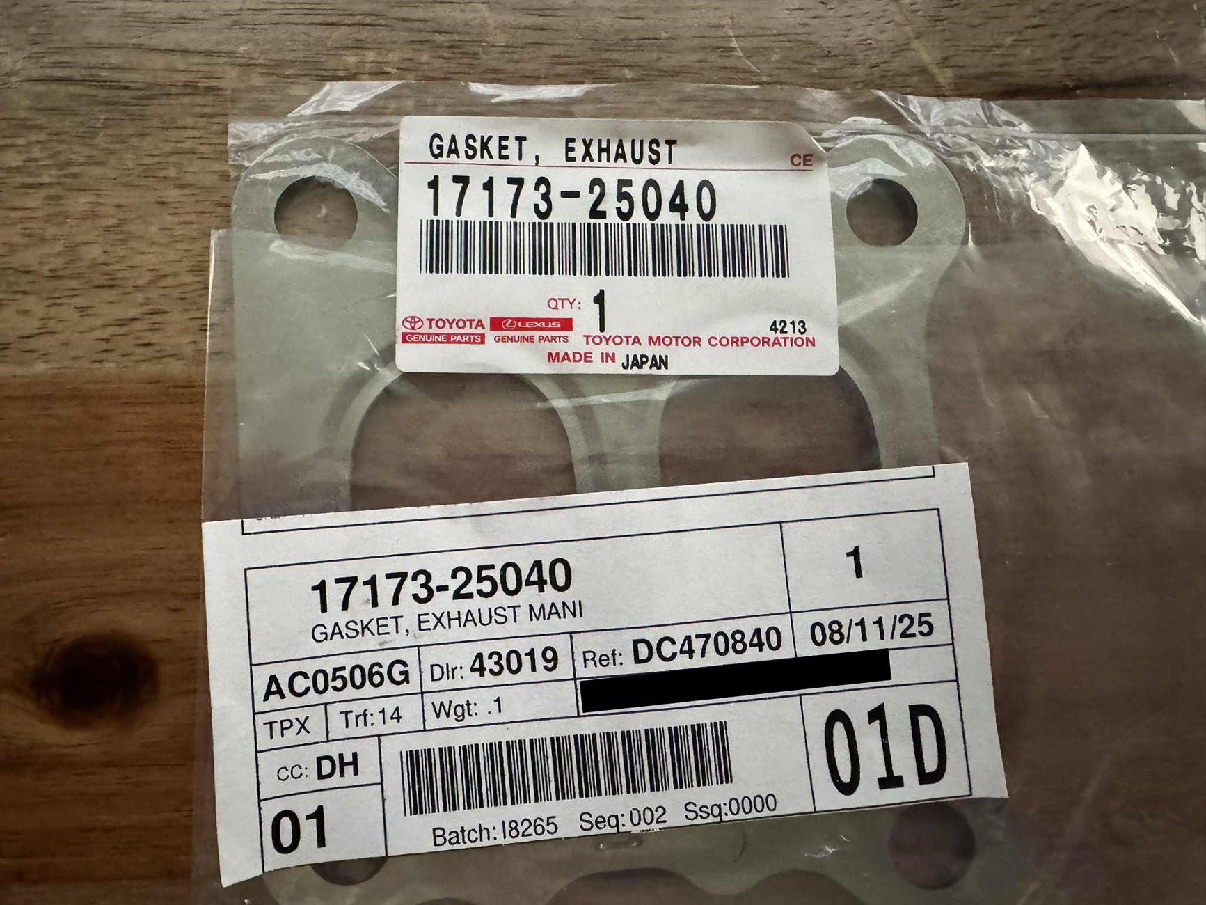

Thank you for the catch! Not sure how that got mixed up. Will correct and update the image.
No worries! I just quoted one of those for a customer this week, so I thought the number looked familiar. So I did a quick check for what does go on a Tacoma.
