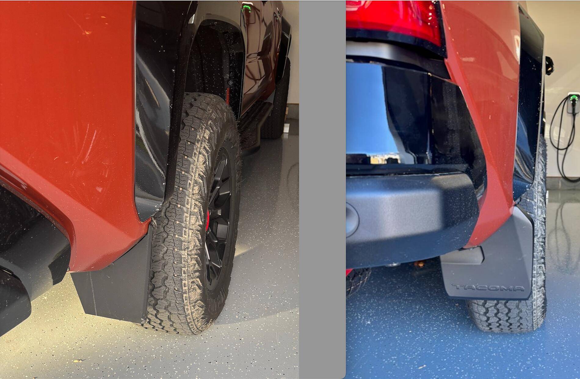

I don't have specifics regarding increased poke or wider than stock tires or wheels with different offsets. I think the narrower flaps would only work for trucks with relatively narrow tires from the factory. I attached two pictures comparing US stock versus the Canadian flaps on my Pro. Anything much wider than the Pro/TH OEM fitment would probably need a aftermarket flap IMO.
2024 Tacoma OEM mudflaps. Canada vs US. Rear Old:N
2024 Tacoma OEM mudflaps. Canada vs US. Front Old:N

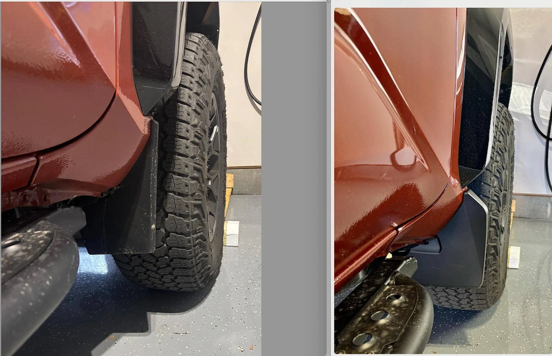

I have a TRD Sport with Method 703's +35 with 285 70 17 Falkens. I went to the dealership yesterday to checkout the PK389-35R00-P1 flaps they had in stock. They almost covered the tread on the front but from what I have read, PK389-35R50-P1 are wider. I ordered the PK389-35R50-P1 from the dealer for 112 and change, as soon as they come in I will install them post a pic of the coverage. Supposed to be here in a few days.
Rear Old:New.jpg
Front Old:New.jpg

I picked up the OEM larger mud flaps today PK389-35R50-p1. While at the dealership, i grabbed the US flap for comparison. PK389-35R00-p1. This pic shows the difference in width. I have +35 Methods and the US flaps missed covering the tread by about an inch. The PK389-35R50-p1 make up that difference.
2024 Tacoma OEM mudflaps. Canada vs US. IMG_2408
2024 Tacoma OEM mudflaps. Canada vs US. IMG_2407

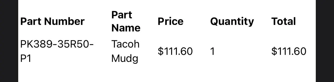

I just ordered my PK389-35R50-P1 from this site for $112 delivered. Great Toyota parts site and have used them several times in the past.
