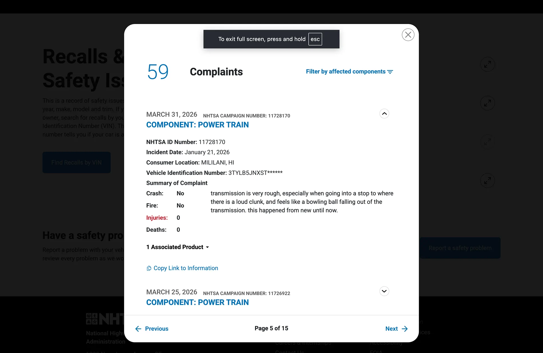

Thank you for doing some research. I had to rush back to work so I haven’t really been able to look into it too much. I was aware of the recall in 2024 however I’ve never seen or heard of any other widespread issues going into 2025.
I’ve never had a transmission issue on any of my vehicles other than some of them starting to shift a little differently because they have 200,000 miles
However, whatever happened it’s not good. It just feels like a crap ton of pressure got pushed in all at once.
Or skipped or something
As of right now, no engine lights or lights of any kind will know more in about two hours when I leave work
I don’t know if I would word it as feeling like a bowling ball is falling out of my transmission though..

@Someguysomewhere26 You should check for transmission codes, which that kind of behavior might have thrown. In the 2024's the failures were caused by stuck/sticking shift solenoids, which threw specific codes. If you have any of them then Toyota might need to replace that transmission.
Good luck and keep us informed.
