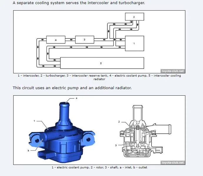

Here is a diagram of the turbo cooling system

There is a less than 0% chance Toyota did not account for this in the design.
I dont know the source of this but would assume thats accurate.
Electric pump circulates coolant; hybrids run the engine fans near constantly when the engine is not running, likely to account for turbo and engine cooling with the start-stops.
Since there is nothing (that I’ve seen so far) in the hybrid owner’s manual, this is likely your answer in the previous responses. Cheers!
(Older diesel engines, especiallly heavier trucks and equipment, certainly needed this cool down period for the turbo, eg: a semi or a dozer. But this is generally accounted for or protected against by automatic systems in modern passenger cars.)
