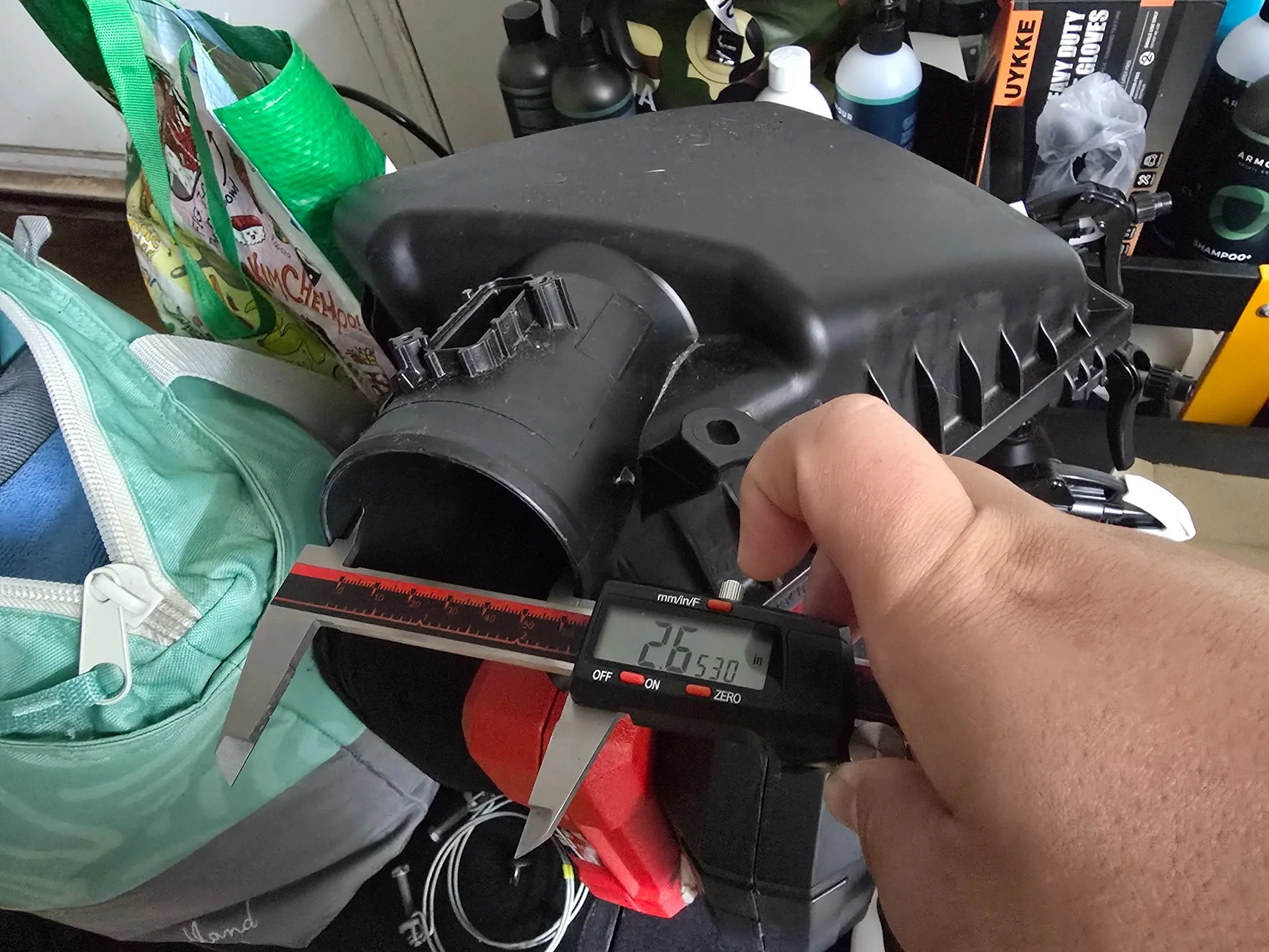

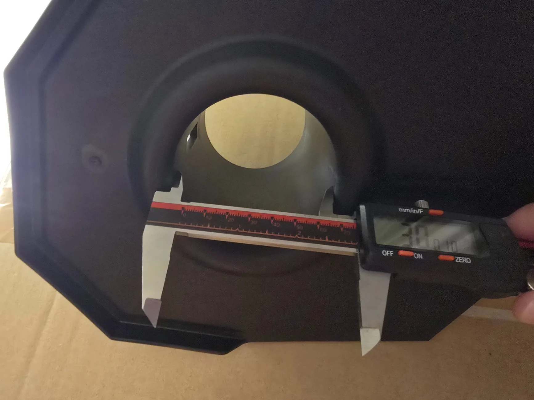

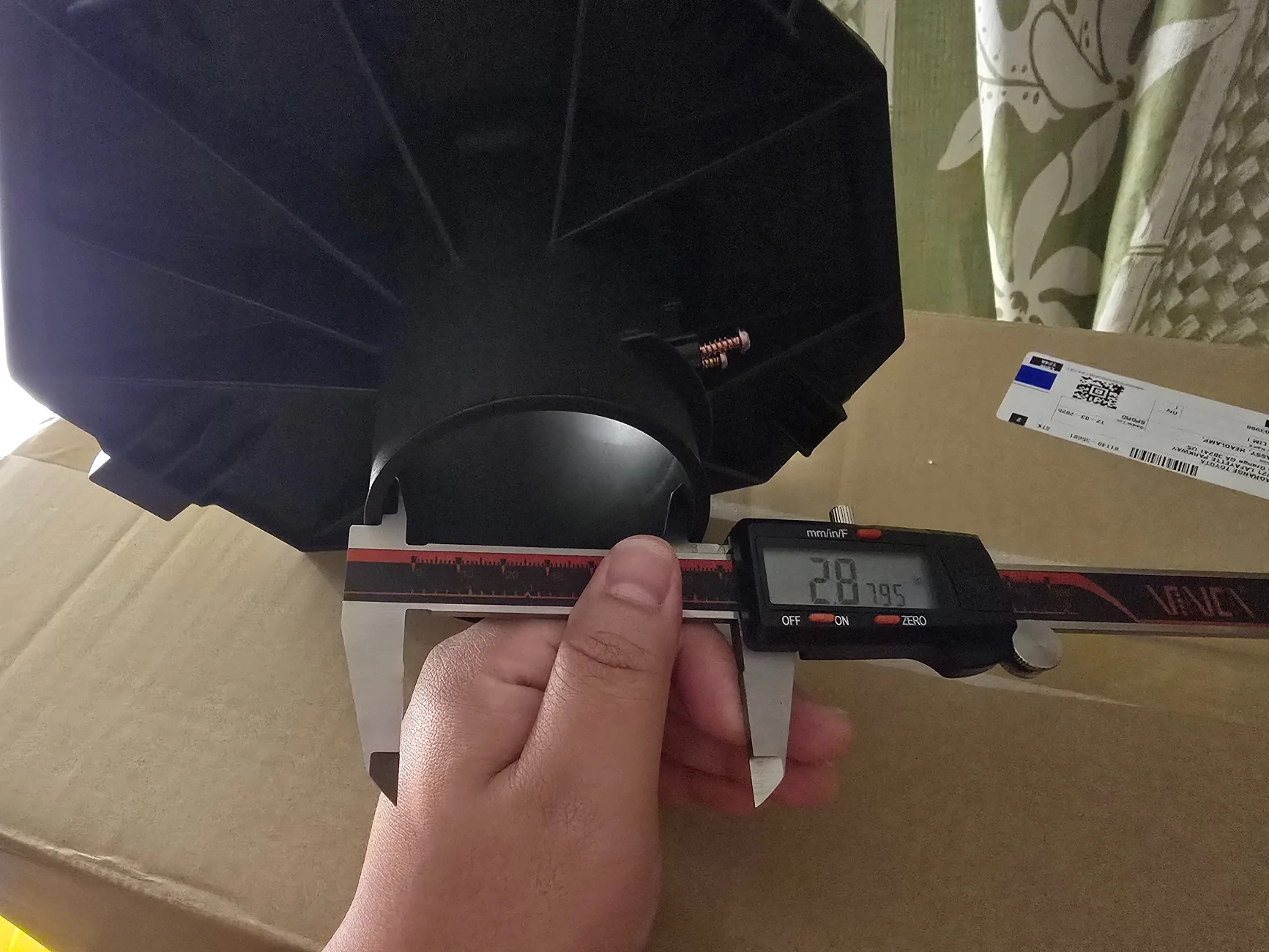

If anyone is curious, I got my hands on a TRD Performance Intake (still waiting for the filter) and took some measurements of the inner diameter of the MAF sensor housing tubing compared to the stock Air Cleaner Assembly. Looks like the pro intake tube has about a 3-inch diameter and the stock tube sits at around 2.6-inches in diameter.
Some quick math shows that this seemingly small difference significantly changes the Reynolds number between the two intake tubes at the same mass flow rate. This means the heat transfer from the MAF would also be significantly changed, which would mean the MAF sensor should be giving incorrect voltage readings for that mass flow rate in a pro intake if it is still calibrated to the stock intake MAF tube size. It makes sense that a recalibration would be needed for the MAF. It would be interesting to know what the limits are for MAF housing size before a CEL appears for these trucks.
Stock Air Cleaner assembly: 17700-AK010
Pro intake parts: PTR03-35241-AA through -AE
