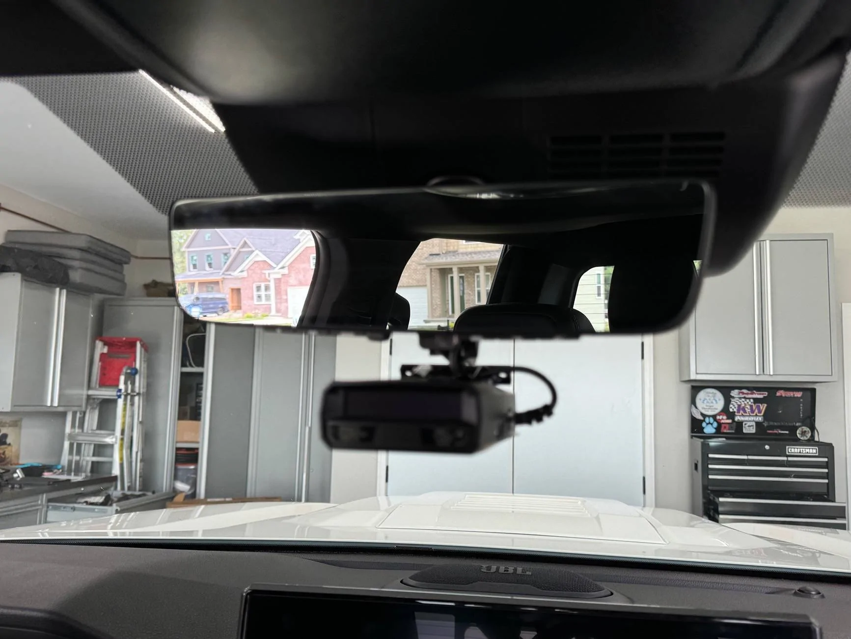

I have.
I used the powered rear view mirror to tap in to. Blue wire to the power mirror is your ACC wire, otherwise the other one (sorry I forgot the other color, may be red) is constant on.

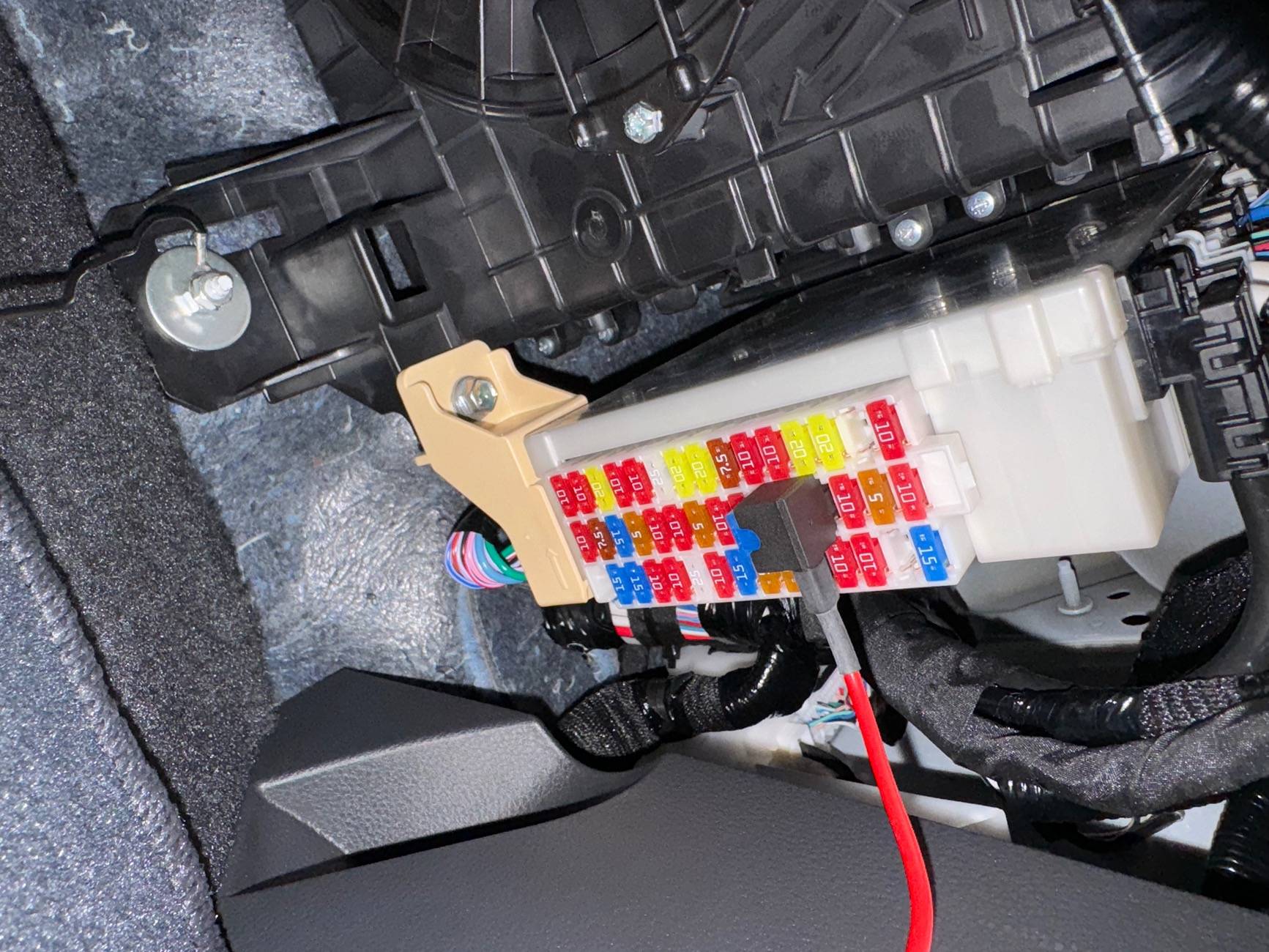

OP please keep us posted. I will be hardwiring mine the day I get it. On the wife’s Camry I used the other option where you run the wire down to the fuse bank and plug in. The Camry has open fuse spots and one is switched power so it worked perfect and super easy to just push the wire into the headline the whole way there. Took literally 5 min. I have done the mirror tap route as well on several cars.

Did mine today. Used a blend mount and add a fuse. Ran it down the passenger side and popped into an open spot that had switched power. Took maybe 30 min total.
