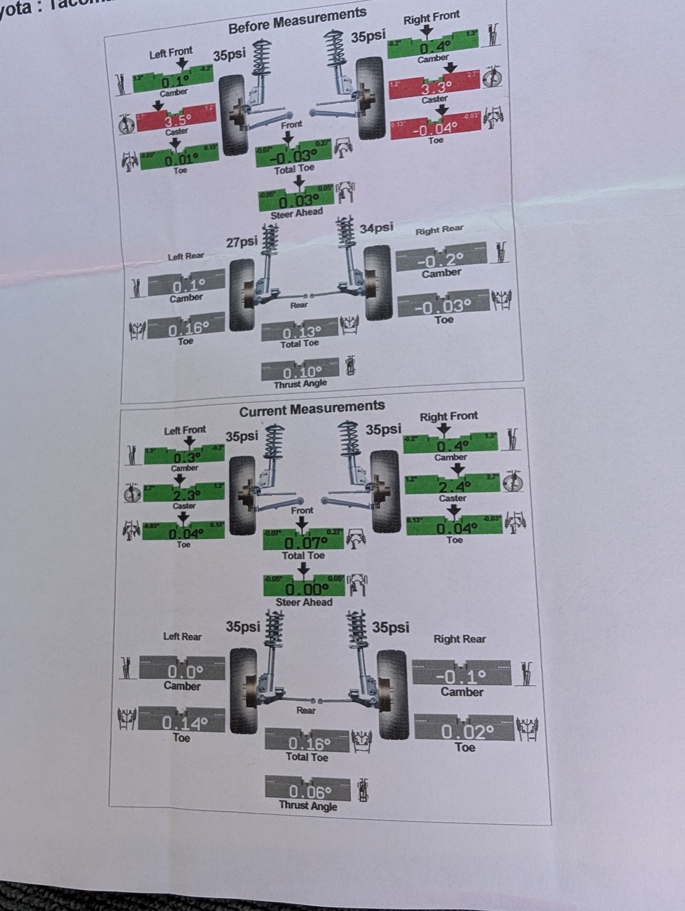

take it to a shop that does the laser alignment
rule of thumb is any new tires , wheels, new lifts ,suspension parts, you need a new alignment, if just for the insurance effect of not wearing/burning the rubber off your tires
i paid just over $100 to have mine checked & yes it was outta spec @ 1000 miles new
now goes straight down the freeway at 75+ mph , no slight correction needed anymore
these trucks are sooooo much Fun to drive🙂😎🤠
