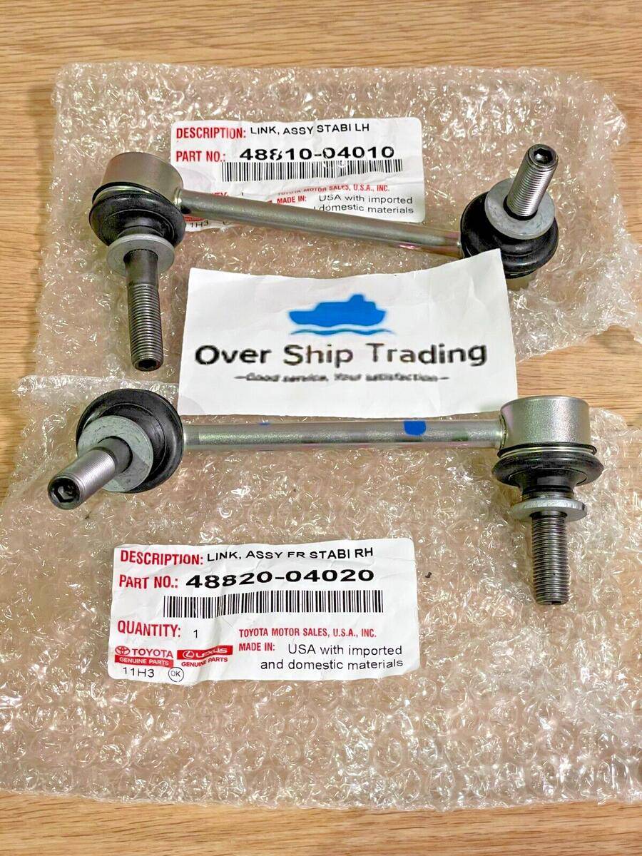

I am swapping out the stock rear springs with All Dogs. It’s a simple switch but I’ve run into an issue with the sway bar link.
As you can see in the attached video, the nut seems to be rusted to the bolt and the whole bolt is turning when I try to remove the nut.
I could try to loosen it with some WD-40, but that only solves half my problem as I’ll then need to retorque it, which won’t be possible because that bolt freely spins.
Thoughts? Bring it into the dealer?

I'm not a mechanic but usually with swaybar end links you gotta stick a hex in the end of the bolt and then use an open wrench to break it free, photo from ebay for reference:
These are endlinks off a 23 but same concept on the 24+ I'm sure.
End links have to spin cause otherwise, well lol wouldn't be good ?

? guess they’re not rusted then. Was wondering how it could get rusted so badly so quickly.
You sir, may not be a mechanic, but you're more of a mechanic than me :clap: Thank you!
Glad to help!
Almost all endlinks are like this, it is a little confusing when you first try to get them off.
Sometimes the nut will rust to the bolt and you will actually have to cut the whole thing off cause the allen will strip. That's only on the worst rust belt car examples. It'll be hopefully 10 years before any 4G gets to that point... maybe ?
